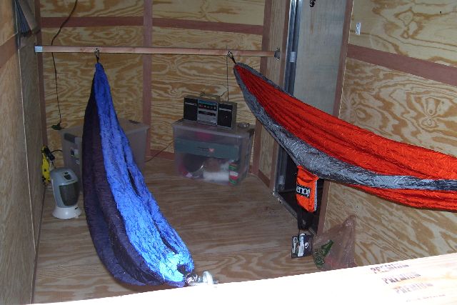

I decided to work on a sleep system that I had been considering for over a year.

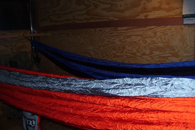

Hammocks. The ENO hammocks are lightweight and I believe perfect for this application.
http://hammockcompany.com/eno-hammocks.php?gclid=CITE7P2orKYCFaE65QodUC3hmg

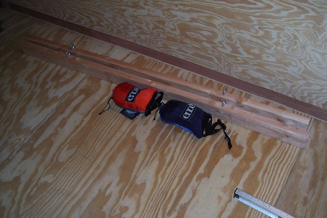

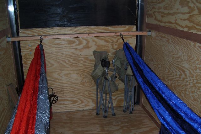

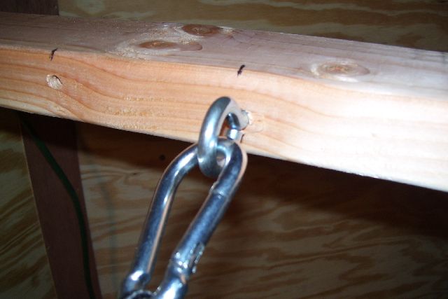

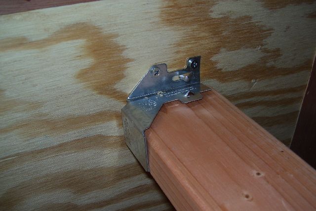

Here is the initial install.
I used 2x4 deck hangers turned sideways. I tried them upright but the pull on the 2x4 was too much.
This is all the space it takes up after being taken down and only weighs a few pounds.
I may even have room to sleep in the hammocks with the Sportster loaded up.

No one else is uneasy with the combined weight of two people and the stress it will place on the walls, let alone the 2x4?
:thinking: :o
Talk me down - I need it.

I was very uneasy with the 2x4 sitting up. When I layed it flat and turned the brackets sideways it turns out very strong. The first two pieces I used were relatively cheap lumber and now that I know this configuration works I'll spend a few more dollars and get a better quality with no knots. I weigh 190 and my wife weighs...... much less :) and it held very well.
I'm still considering steel pipe and some type of heavy duty u bracket for it to sit in.

Yeah, this arrangement is not strong enough and the stresses on the walls are too much.
Seems to me it won't hold for long before the 2x4s break and the sleeping is abruptly ended with a crash to the floor. Not pretty. Could end in wife never going camping again...and/or broken tail bones and concussions.
So why not use hardwood 3x3s (white oak, hickory, maple) and notch them into wider, vertical boards (also hardwood) that carry the compression force down to the floor? You could just lift the 3x3s out of the notches when taking down the hammocks.
With lumber, a table saw and epoxy, you can make any dimension boards that you want.
You could mount the whole arrangement a bit lower for more safety.
Best wishes.

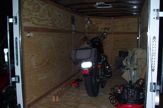

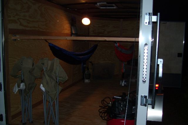

Postby DavidInPalmetto » Mon Mar 28, 2011 8:22 pm

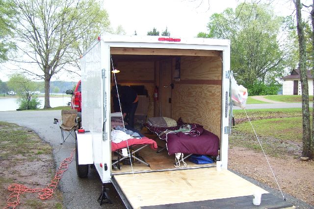

Angie and I took the Cargo Trailer out this weekend for a dry run, or so we thought.

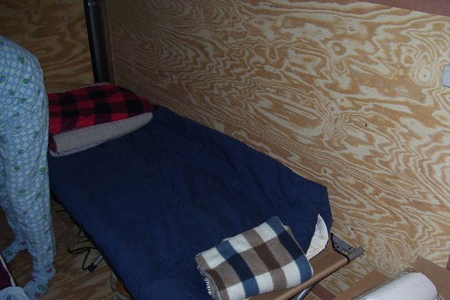

We scrapped the hammock idea for inside the trailer. Not because of strength concerns but because the support boards really got in the way. I even tried putting them near the ceiling but then the hammocks were uncomfortable.
I now have two cots. They take up little space when stored and are ok to sleep on.

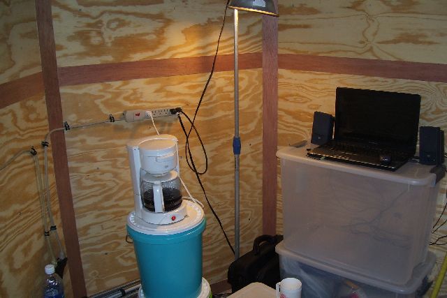

Here is something we did learn. We have been using the big plastic bins with the lids for tent camping. We didn't like them for the trailer. Whatever it is that we want or need is on the bottom of the bottom of two stacked bins that also have a hot pot of coffee brewing on them. :o
I had thought that the bins would be perfect. Stack two high and you have a nice table. That is until you need something inside one. Great on paper, not for us camping in the trailer. So either shelves or cabinets are now in the plans.
I'm a slow learner so I think that I'll need to keep taking the trailer out as often as possible. maybe get one idea each time out. :thinking:
As you may have noticed, I haven't done much to the interior yet. I have insulated the ceiling and I'm glad I did that.
On our one night campout the tornando sirens went off two times during the first day and then at least twice during the night. That morning we were hit with a strong thunderstorm and hail the size of peas that was coming down very hard but the insulation kept the noise down.
We had a great time (despite the weather) and I'm looking forward to doing a few things then taking the CT out to tweak it again.
