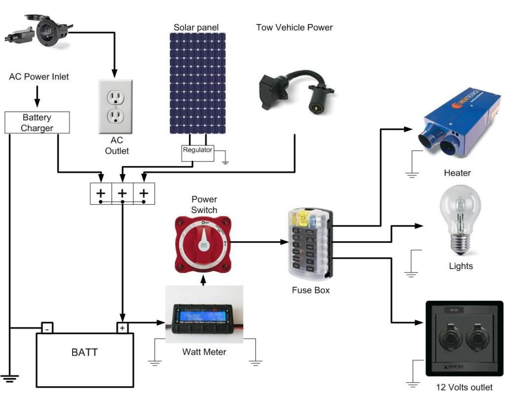

Postby Jo » Mon Apr 04, 2011 12:05 pm
Ok Here's what i'm planning to do:
Jo

Postby proformance » Mon Apr 04, 2011 12:41 pm
May I make a recommendation for the Battery Master Switch (power switch) installation.
1) Use an A/B select Master switch switch (Off/A/B/A&B)
2) Wire the switch so the Battery is on the common post (the center post)
3) Wire the Trailer Component Fuse Panel to "B" terminal on the Battery Switch.
4) Wire the Charging Circuits to the "A" terminal.
5) There should be a second fuse box that all the charging components pass through. This will protect your trailer wiring should any of the wiring passing between a charge circuit and the battery were to short.
The above will allow you to disconnect the charging circuits and/or the trailer independently from the battery while leaving the apposed connected. And, it will allow you to completely disable all from one another. This will allow you to perform maintenance more easily in the future and disable components not in use.

Postby Jo » Mon Apr 04, 2011 1:02 pm
Thank you Proformance!
You are absolutely right! I will add a fuse for each charging devices.
A A/B select switch is the best choice, but I already have a On/Off switch...
