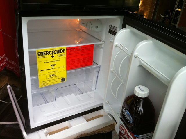

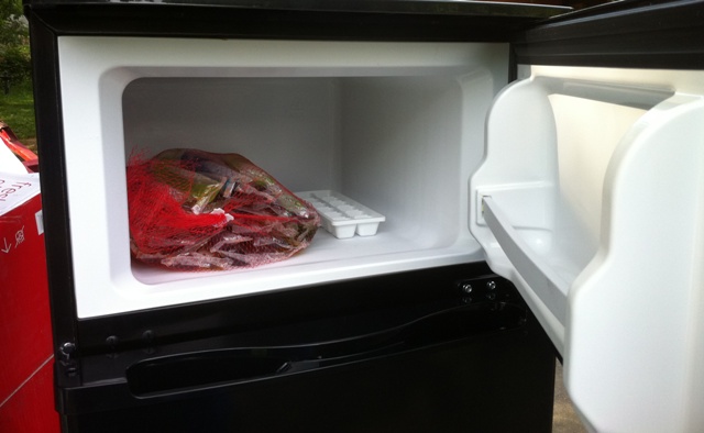

Postby Nitroxjunkie71 » Sun Jul 31, 2011 9:30 am
Gadget Man wrote:Well, I went refrigerator shopping today. I went to Lowe's and Best Buy.
I found the 3.1 cubic foot model with the separate top freezer, both stores had them right up front of the store for the back to school dorm room shoppers.
They were right around $219.00
I bought one of these about a month ago and shopped around. Wally Wrl'd had them on sale. Low & Behold, they are still on sale as of today.
GE 3.1 cu ft 2 Door Compact Refrigerator, Black $124.00
It worked great the first time I used it and the weather was HOT, HOT, HOT!
