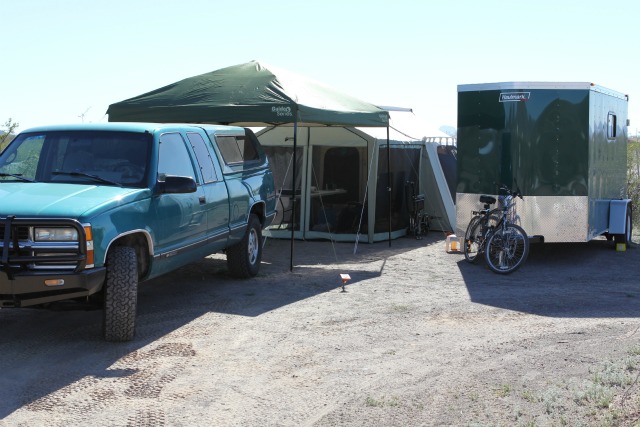

Postby Trainman45 » Tue Apr 17, 2012 1:03 am
Hi Gang, Here are some picks of the Solar Panels from different angles for you to check out. I went up to Eugene/Springfield OR, to get the solar system installed at AM Solar. You can check out their website, and for the handyman you can order from the website and install yourself. They are one of the top RVer Fulltimer Solar companies. They are great to work with and know what the RVer or Camper really needs to boondock.

Postby Trainman45 » Tue Apr 17, 2012 2:42 am
Hi Gang, I added the Safety Marker Tape to the rear and side of my trailer. I was made aware of how this is a good idea one night while crawling through a camping area in pitch dark. I was making kind of a half circle to turn around to the left in a dirt with a few trees open area and saw the small motorhome camper. So I was going to swing around behind it .... until my lights came around and picked up the RED & WHITE reflector tape on the side of a flat trailer behind the motorhome. !! Wow, the trailer was all black and had nothing loaded on it. I did not see it. It would have been very difficult for me with my trailer to get out of there if I had not seen the reflector tape in time, it really saved me a big back-up turnaround hassle. I think it is a good idea to be seen when my lights are off at night by approaching lights.
