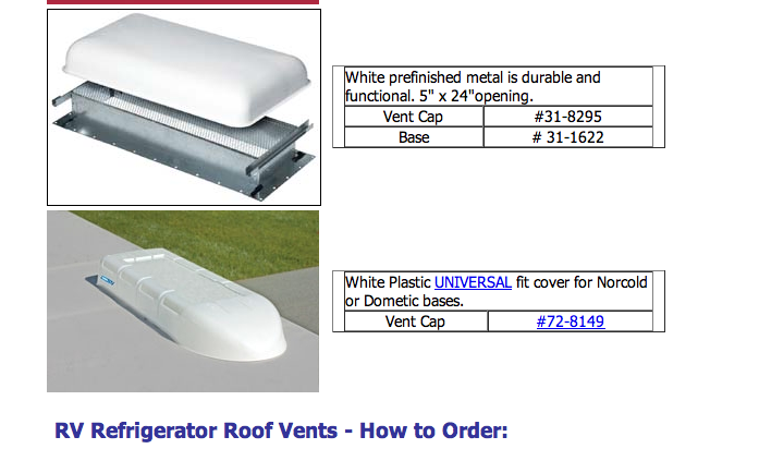

Great idea & post on the window ac unit using a refrigerator roof vent, :D :D with a small unit like that one could even install 2 smaller 5,000 But ac's into a larger trailer.
I would guess that the fan in the ac has enough suction on the rear end. We have a section on hacking an ac here also by shadow catcher...
I guess the roof vent is like this model approx. ? Can you post some roof vent pictures ? :D :D
a roof vent.png (127 KiB) Viewed 3882 times
I would also assume there is some kind of pan to drain the water to the exterior or ?? :thinking: :thinking:
http://www.pplmotorhomes.com/parts/rv-refrigerators/rv-refrigerator-roof-vents.htm?utm_source=google&utm_medium=partsshopping&utm_campaign=partsfeed&gclid=CNeC_eKhibICFad7QgodICcA1g
Keep up the good work on your CT :thumbsup: :thumbsup:
