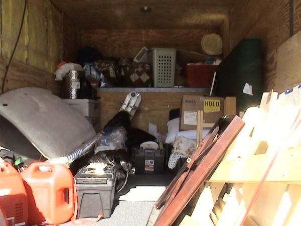

Loner- re: building on the road- here's how my box truck looked when I hit the road from Portland:
Spent the better part of 3 days in Nor Cal Home Depot parking lot installing the propane shower.
