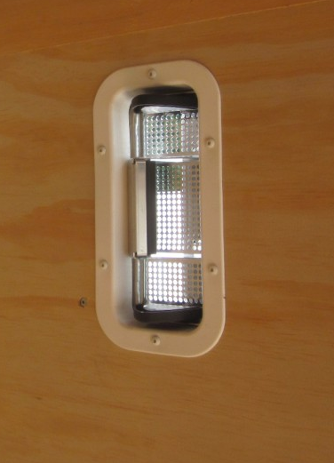

I have some 4 exterior cameras and I would like to make them hideaway
You know some trailers have side vents that swing open ?
a side vent 3.png (217.99 KiB) Viewed 2751 times
I wanted something like that where my cameras could be attached and then would swing out if opened ...
I just started think about that idea....
For the front and rear cameras I could use 4" or 6" Boat like deck plates that can be unscrewed
Currently I also have the water heater on the exterior & would like to move it to the interior,
I am thinking of something like a metal swing away cabinet 12" x 18" x 6" deep out of alum
so if the heater needs service - I could just unhook the water line and swing it 90 deg to work on it

The swing out box is definitely a project for a sheet metal shop. They have box & pan brakes with fingers to adjust to whatever size cube you want.
As for the camera mount, have you thought about just buying a swing out vent and modifying it yourself?
The photo you posted looks like plastic which I guess could be used but I'll bet there are metal ones being made too.

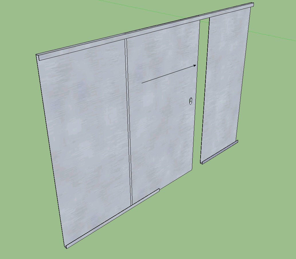

Entry door. If you swing it out it will still run into your hanger door if that door is closed. If you will be leaving the hanger door secured in an open position when you are in the trailer you could simplify things by simply having a three-piece awing on the curb side: 1) a panel as currently designed for the rear portion...perhaps nearly up to the door, 2) a forward panel from the trailer nose back to the front edge of the door, and 3) instead of a hanger door, just a third panel that would hinge and secure back against the forward panel. Kind of like the hanger door idea but without the complexity....a third panel of a "door".
If your trailer door was willing to open to the inside....which sort of goofs up your step well....you could open the door to the inside, then open your hanger door as designed and have a second layer of security against two-leggers and four-leggers. With awnings down and locked you'd have a tough trailer to breach, no easy window, double doors, double walls front, rear and sides for the most part.

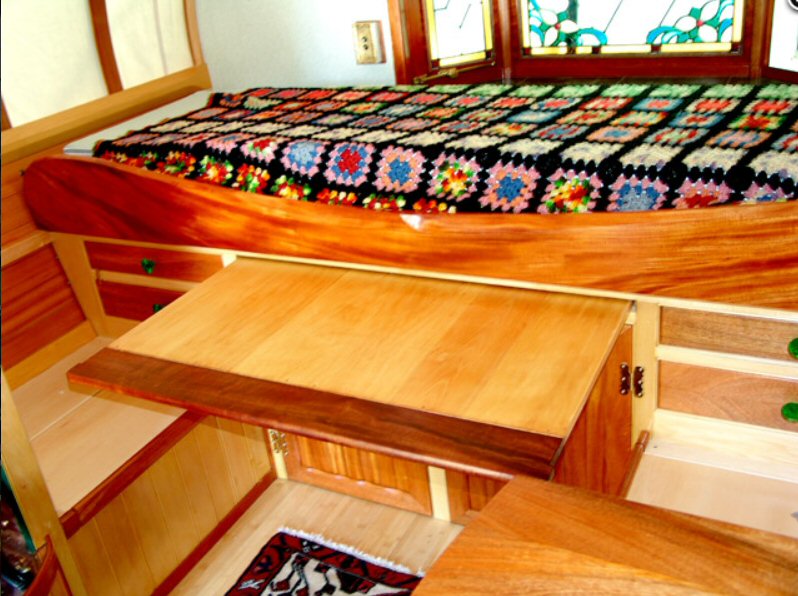

I suspect what's got you is the Gypsy vardo layout...it grabbed me when I first saw it. It makes good use of the alloted space. Typically Gypsy children slept under their parent's bed the same as frontier children slept in a loft in a log cabin. Before they were able to add a separate bedroom, it was the only available privacy they had (gotta make more children).
Gypsies raised their whole families in the space you and I would devote only to recreation and emergencies. They cooked outside, they used the woods, fields and nearby streams as their "facilities".
GYPSY TABLE.jpg (106.53 KiB) Viewed 2615 times

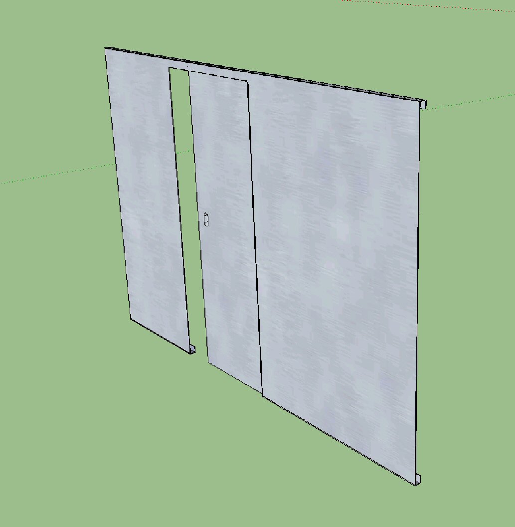

Here is the sliding awning door. The track is 1-1/4" wide inside and 69-3/4" tall.
The door is exactly 1" thick and 1/8" shorter vertically and wide enough to bridge the opening without tilting or one having to support it while opening/closing it.
I'm showing it in aluminum but galvanized steel would work just as well. In any case, it's made of 1/8" (approx 11 gauge) material.
Whaddaya think?
Dan

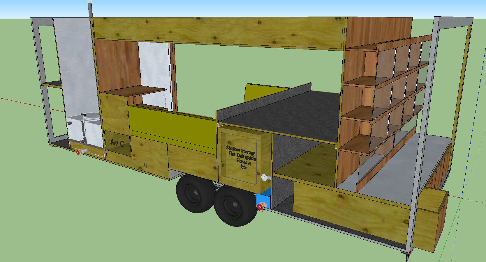

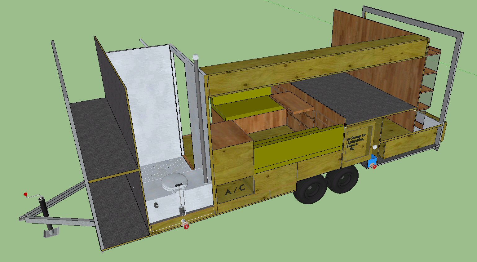

Here's some orthographic views from 3 directions.
Dan

Re: New Larger Design Cargo Conversion 8.5’ x 20’
Postby roadinspector » Sat Dec 08, 2012 12:00 am
Nice! :thumbsup: Very nice!! Well thought out and good use of space. I really like the CT conversions. Build your own to your own specs to fit your needs and wants. I like your sliding door design.
Earnest

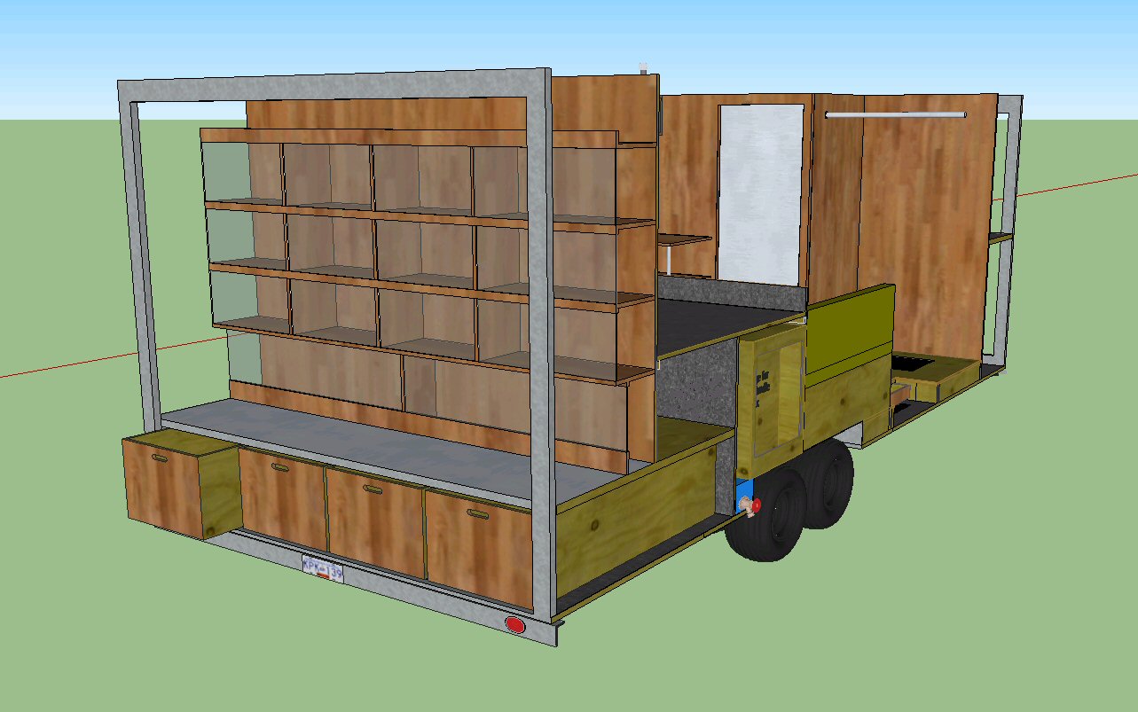

Postby ironman » Sat Dec 08, 2012 6:50 pm
Here's another.

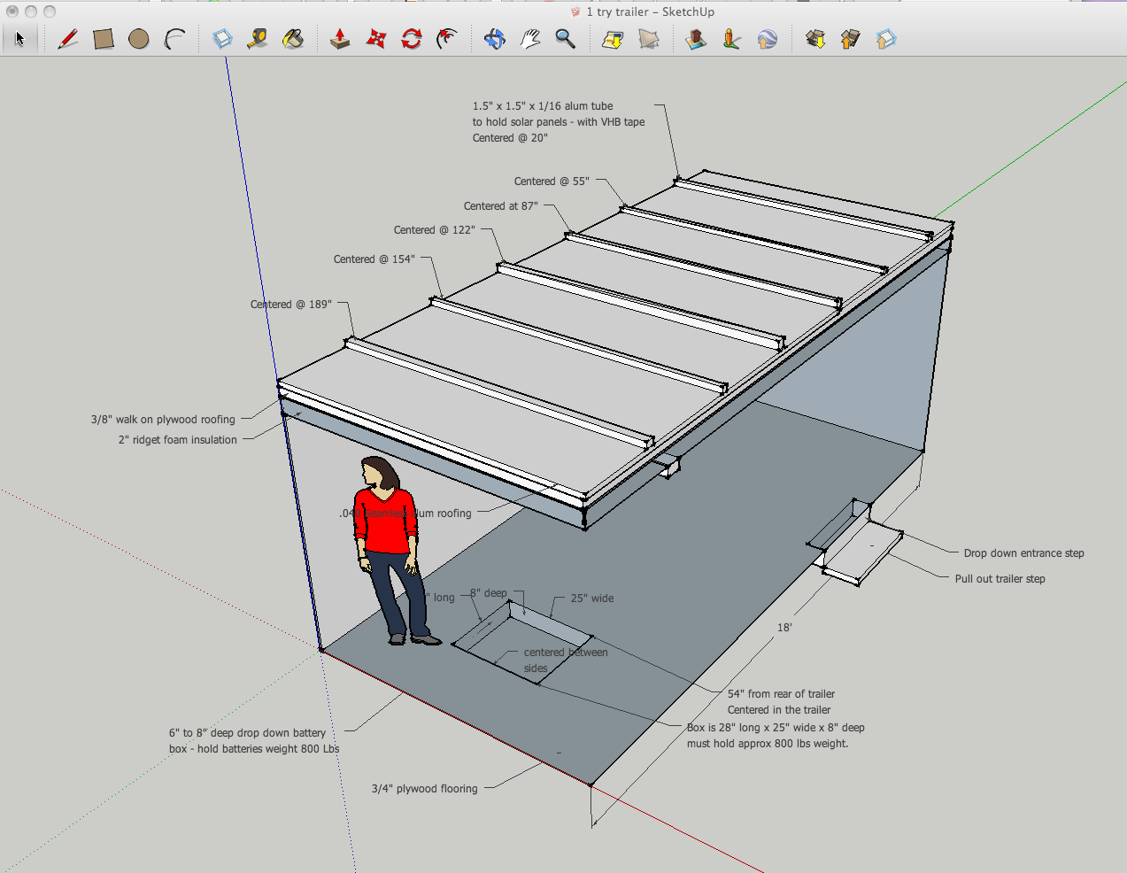

Postby OverTheTopCargoTrailer » Wed Dec 12, 2012 12:04 pm
Hey Ironman

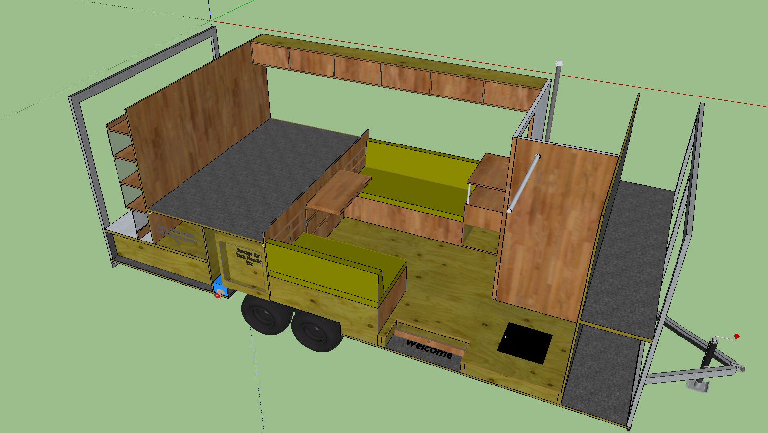

You got me started with this stupid Sketctup THANKS !!! ..... :? :?
Maybe I can e mail you my design & you can improve it ....
as you seam to be a master at everything .....
then you can see everything in 3 D
this is my design for the next model
A new trailer view.png (140.91 KiB) Viewed 2520 times
Thanks Jerry

Postby ironman » Wed Dec 12, 2012 2:01 pm
OverTheTopCargoTrailer wrote:Hey Ironman
Tou got me started with this stupid Sketctup THANKS !!! ..... :? :?
Thanks Jerry
http://overthetopcargotrailer.blogspot.com/
Hi Jerry,
Are you trying to show SIP panels?
If so, you can go the solid modeling route - just push/pull a big cube, lay out the guides using the tape measure tool for the wall thickness (or use the offset tool) and draw that inner wall dimension as a rectangle.
Then push the inner rectangle back down to floor level.
Draw the roof panel the same way. Real world buildings are built using SIPS PANELS
Solid modeling is good to show something in a conceptual way

Postby OverTheTopCargoTrailer » Wed Dec 12, 2012 4:02 pm
Hi Ironman
This is the model for my next 8.5 x 18 trailer with 1530 watts 6 solar panels on the roof.
I am waiting to see if Lark will build to my specs....??
The walls, floor & ceiling will be made like a homemade SIP ...one layer at the time , all the way around... ARCTIC packet like :D
the trailer insulation I did the first time around was better then 95% of what most do ....but still was way substandard....
I currently pick up 10 deg over the exterior ,1 person 40 outside = 50 deg inside without heat. 2 person 40 outside = 54 deg inside without heat.
I would like to get a 20+ deg spread.
YOU really need a box - inside a box for good insulation & maybe that will still be substandard ?
With good insulation im pretty sure you can cool trailer to 78 deg with 100 outside - in full sun on only 5,000 Btu
I have tested it to 90- 95 deg with my shitty insulation and it works ok :(
