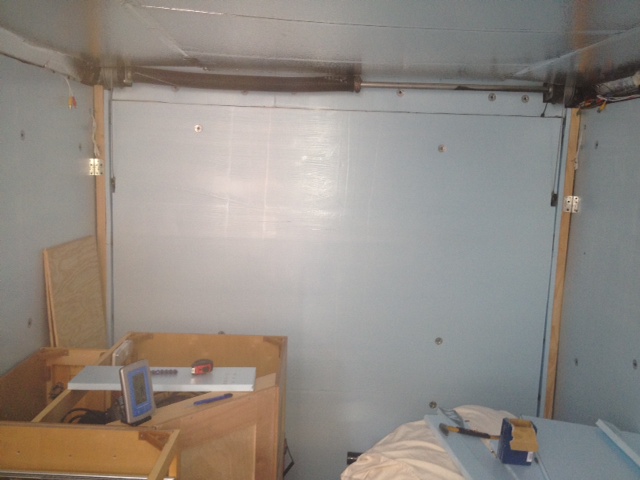

I am now adding supper insulation 100% walls, floor & ceiling R8 - 1.5" Dow blue board & its reducing my power load in actual use by est 50%
I am about 99.99 % sure I could now cool my 7 x 16 with 3,000 Btu a/c or running my 5,000 Btu ac 65% of the time in the full sun at 95 deg....
but that is a low humidity for Calif.... Not Georgia humidity, more humidity equals more run time.
from my 840 watts laying flat I am still pulling about 670 watts at 4 pm during the summer.
Im using a Outback 80 amp charge controller.
(2) 530 Surrette L16 batteries. 400 amp hours - about 1000 max recharge cycles.
Morning star 300 watt pure sine Inverter
1500 watt Magnum Modifine sine inverter - starts a/c no problem
http://www.wholesalesolar.com/products.folder/inverter-folder/Magnum-MM1512AE.html
On my new trailer - I will kick the system up to 2,000 watts and 800 amp hour Surrette Batteries,
1270 on the roof, 420 on each side of the trailer on 2 charge controllers.
The magic is only possible due to the insulation :D :D
