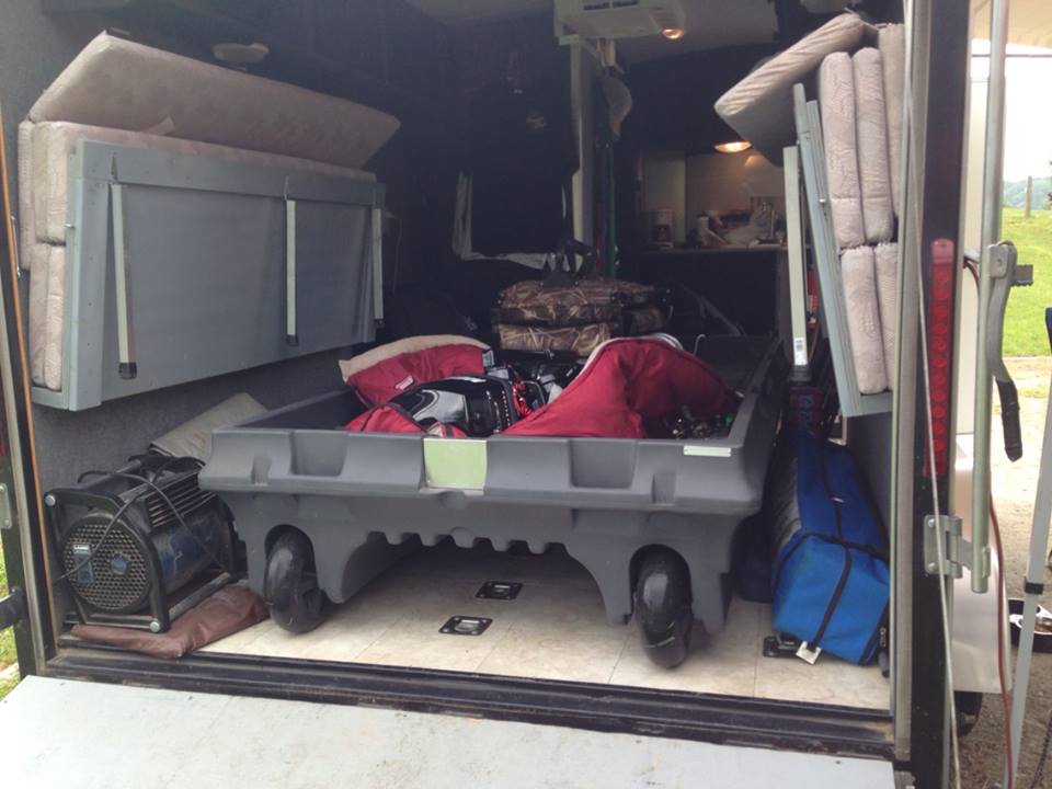

I had often thought of trying to do the same and finely came up with the idea of hauling my 8 ft two man boat in my toyhauler. It turned out to be a perfect fit. I would love to have a regular boat with me at times but this has sufficed at most places I camp.

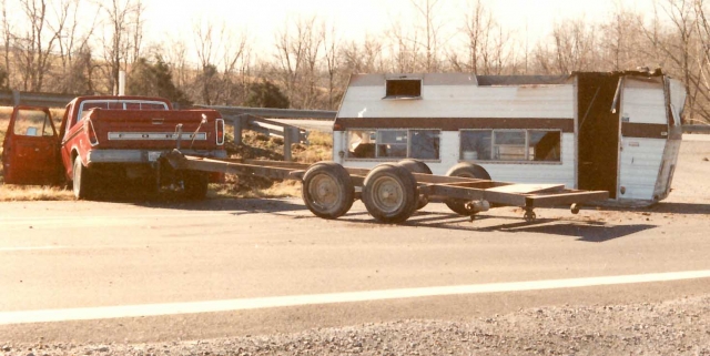

This photo might also show you what happens when the trailer controls you. I have posted this before.
The trailer took control when pushed by the wind from a passing tractor trailer at just 55 mph or less. I had brakes and an equalizer hitch. But I could not control the trailer at all when it decided to take up two lanes of highway.
So I suggest that one be cautious when it involves trailers and brakes. I will never have one w/o them again. And I would be careful with what I tow.

Great picture bob
Looks like you got about 5 generations of camping out of that trailer
:lol: :lol: :lol: :lol: :lol: :lol: :lol:
Glad you weren't hurt.
It does prove a wood frame is strong as long as its bolted down.

Thanks Jerry and for sure it was a trip I never want to take again.
