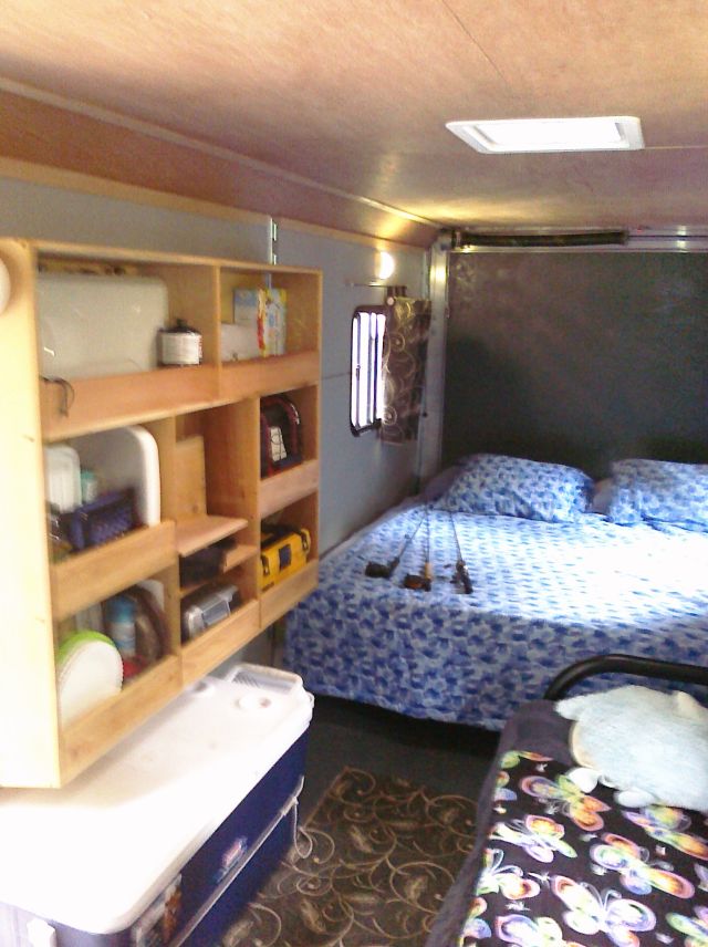

so after my last camp trip I have a better idea of where and how things need to be stored to make for an easy camp. I worked up some cabinet boxes and added some front rails to test run before building face frames and doors.
I decided to paint the floor and walls to keep down on marring woodwork which was a problem with my last trailer, it worked well for camping but not the best for toy hauling so an exterior semi gloss on the walls and a marine grade epoxy on the floor should work :thumbsup:

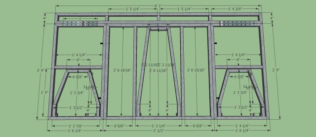

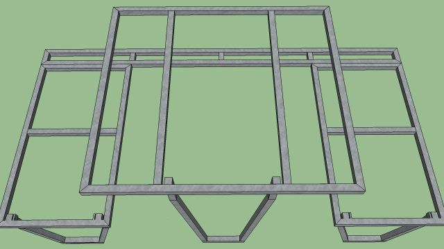

Postby poordad » Mon Oct 14, 2013 10:00 pm
Well I haven't been able to work on the trailer lately but have spent some time working on a design for a convertible bed table as well as get a little more comfortable with CAD.
I guess we will see how it comes out into the real world :D

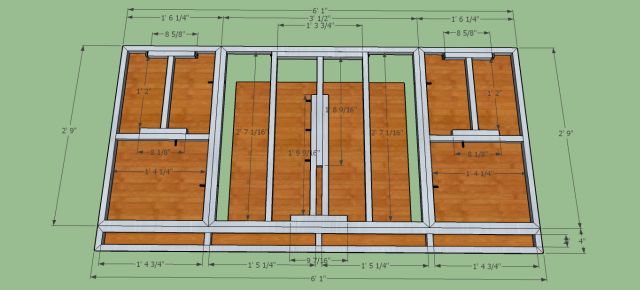

Postby poordad » Wed Oct 16, 2013 8:23 am
once I started laying out the table and bench legs in down position I decided that I wanted to change them up a little to add some support on the ends. I think with a decent wall mount on the other side of things that this will work out a little better :)

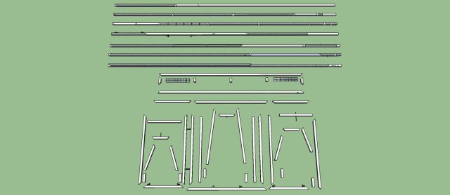

Postby poordad » Tue Oct 22, 2013 2:13 am
thanks I like it and the looks make it tow well so bonus :)
I was able to take my design apart and overlay it on some measured stock so I could figure out how much steel was needed and what length to get it in :NC
now I hope it goes together nicely in the really real world :)

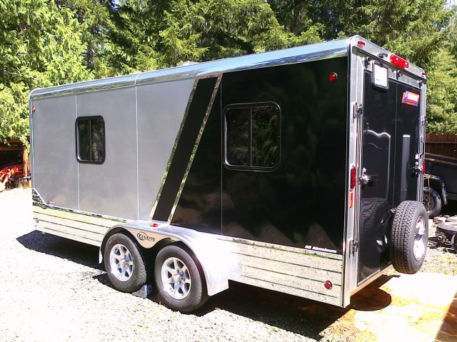

Postby lrrowe » Tue Oct 22, 2013 2:25 pm
I especially like your two tone color scheme. But with all the discussions on insulating and keeping the heat out in the warm weather and the heat in during the cold weather, how do you think the black color will affect you? Are you concerned about it?
