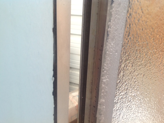

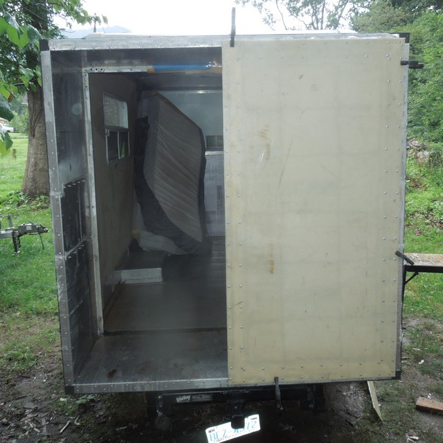

Done :) See the new pics in my gallery.
The aluminum extrusions came from the scrap yard. They worked out nicely in the end.
See the gridlines under the Lexan? That's the glue holding the 1" foam in place. The inside is 1/4" plywood paneling just like the rest of the walls.
Next week I'm going to install windows in the back doors.

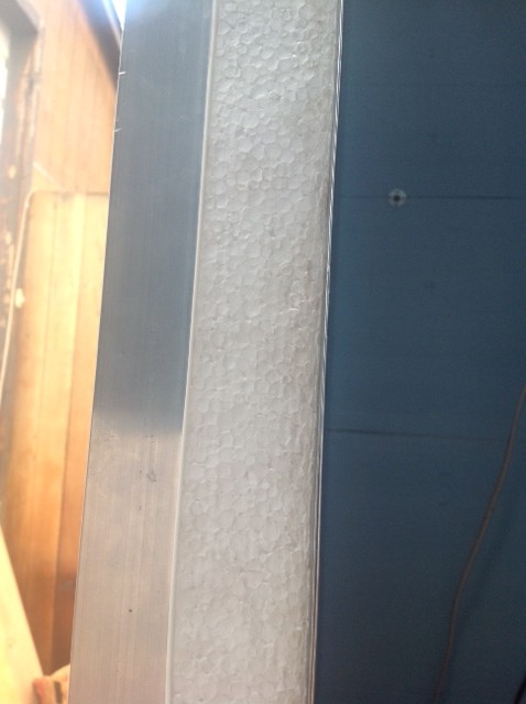

Postby Treeview » Fri Sep 13, 2013 11:42 pm
The sheets are 1". I think that I had to make the rabbet 1/4" to overlap the frame.
The inner channel that the rabbet covers was filled with a ripped strip of foam too.
The outer channel is where the weatherstripping was glued to seal the door to the back of the stretch.

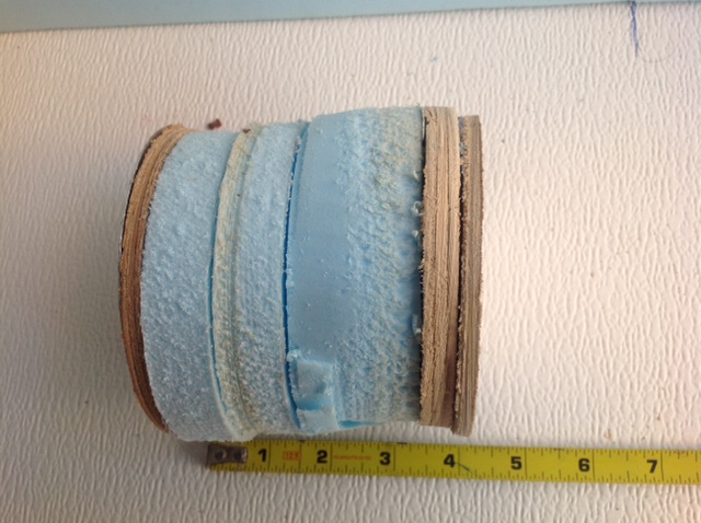

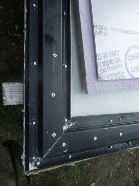

here is my door & wall
door 1.JPG (62.34 KiB) Viewed 4210 times
door 2.JPG (99.25 KiB) Viewed 4210 times
The door insulation , presses against the wall to make a seal.
I will redo this latter in blue board - now is just for testing.
