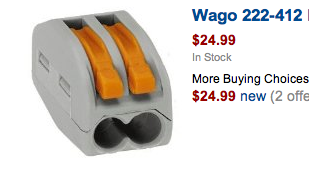

Postby OverTheTopCargoTrailer » Mon Oct 28, 2013 8:37 pm
wago 2.png (44.87 KiB) Viewed 2370 times
Pordart
As a certified construction inspector for 27 years I guess we will agree to disagree about the WAGO 222
Which it appears you have never viewed, used in your job nor do you have any evidence to support your quoted other persons conclusion.
About this single product WAGO 222 connector,
this connector works great with " STRANDED" wire
Show me some evidence where this connector fails more then any other method PLEASE ??
Google it for me " failures of WAGO 222 connectors"
It also seams strange if you have 30 "PLUS" years electrical experience you need to copy another's mans opinion.
Respectfully yours
In case you would like to educate yourself, please read info at link below.
http://www.wago.com/infomaterial/pdf/51175817.pdf

Postby OverTheTopCargoTrailer » Tue Oct 29, 2013 10:26 am
Hi Orcaditigal
First of all I don't see anything wrong with your Romex wiring and the WAGO 773 ? for solid wires....
Researching a little about WAGO's I found the Wago 222 would be an EXCELLENT connector as many here swear by stranded wire.
That standard comes from "BOATS" as they vibrate like hell & are in a wet & salty environment, if it works there - your CT is a cakewalk.
I use both solid & stranded and have had no problem with either.
However as i'm residential I have never seen the WAGO 222, they are not sold at HD or Lowes
They are actually rated from 24 - 32 amps :thumbsup: :thumbsup:
and WAGO makes over 25,000 different products
below are a few you tube videos to prove my point, for all those who are stuck - and drowning in misinformation,
PLEASE DROWN - by yourself, and let the other open minded folks make up their own minds after the view the FACTS !!!!

Postby prodart » Tue Oct 29, 2013 8:20 pm
perhaps I should look at the wagos for use with stranded wire, thanks for the input over-----, however , for use with a solid wire, I personally, have little to no faith in any electrical connection on solid wire by mere means of a " sprung " steel tab that has a definite fall off of tension after thermal cycles due to either constant or intermittent amperage draw. That being said, I too am a firm believer in the use of stranded wire just for the resistance to vibration. Whether it be a boat on rough water or a 150 hp electric motor on a stone crusher. thanks again ot
