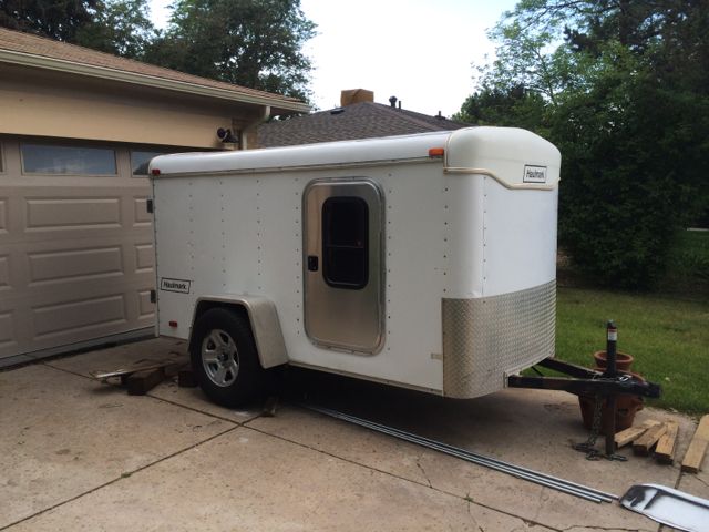

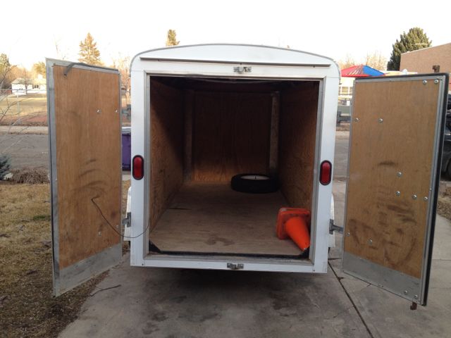

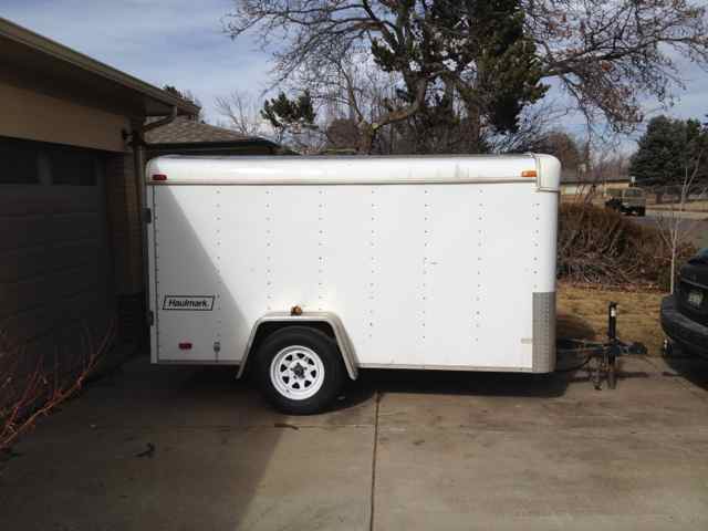

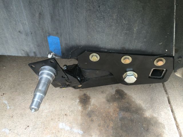

So a while back I started researching a conversion build and got some ideas in my head. I found an older 5x10 haulmark on craigslist for $1300 so I thought that would be a good place to start -

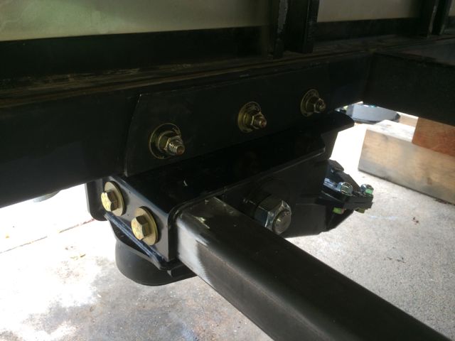

My first order of business was to upgrade the suspension. Although it did have a torsion axle I had my mind set on the Timbren axle less system, and ordered a kit from etrailer. Grinding off the old brackets was a pain in the ass on my back under the trailer. Once they were off and I carefully positioned the Timbren brackets, they went on relatively easily. I did have to find a torque wrench to make sure I wasn't over or under tightening the bolts. As most of you know, drilling holes in steel is a tough without a drill press. For those of you who have yet to drill into steel, I would advise to purchase a nice set of bits, drill slow starting with a small bit, and work your way up. Using oil will also help keep the heat down.

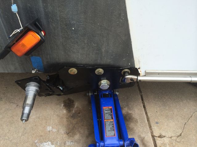

Timbren units bolted on-

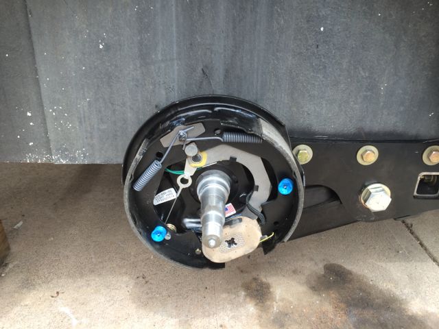

As the trailer would eventually have some weight to it I decided to opt for some trailer breaks which were not on the original trailer. Installing new drums and breaks was very easy. Etrailer.com has lots of videos that were helpful

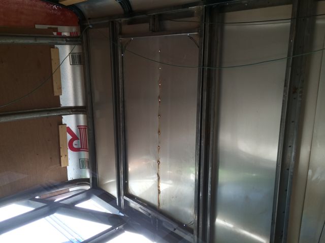

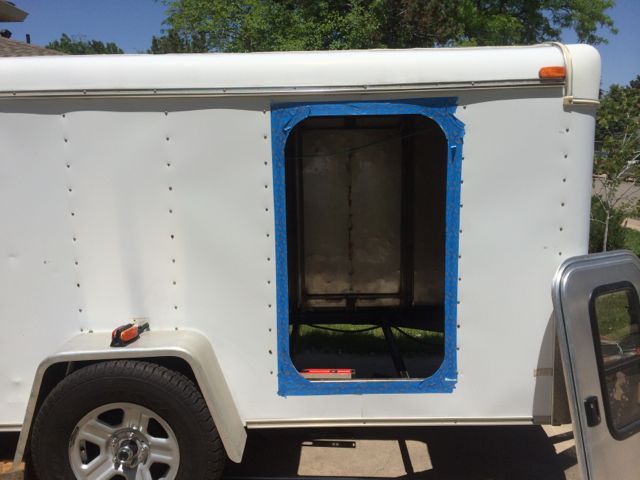

I spent quite a bit of time trying to figure out what type of door to use. There are lots of good looking teardrop doors on ebay, however the heights proved to be pretty low, and I decided that I really should get a taller door if I could find one. From a thread here on TNTTT I found some larger, nice insulated aluminum doors from KMTparts.com. They were built and shipped relatively quickly, and proved to be well made when they showed up in the mail.

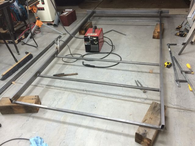

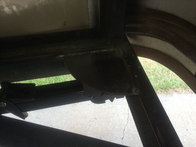

Framing in steel studs for the doors proved to require some welding. Fortunately a neighbor and friend are both very proficient in welding, and one had an old welder he ended up lending me. He gave me a quick welding lesson and helped me with the first door, then turned me loose letting me know that a weld doesn't have to look good to be strong and get the job done. We marked out the openings, used a grinder to cut through the vertical stud already in the trailer, and framed in a new opening with 1x1 16 gauge.

Once the doors were framed in, installing them went really quickly

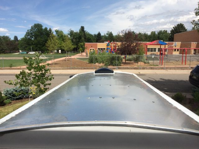

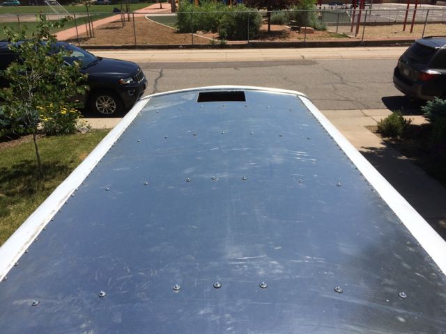

Unfortunately (after I purchased it) I realized that the roof was in pretty bad shape, and apparently had been repaired but didn't look like it would last and was leaking. They had used four sheets of galvanized steel (I think) which I thought would probably eventually leak. I replaced this with a solid sheet of aluminum. This proved to be difficult with one person, and didn't come out completely square, but I think I'm the only one that will notice.

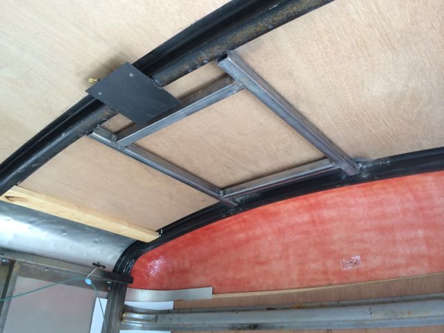

Next I framed in for a roof vent/fan

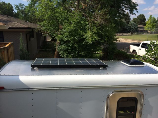

Again, once the vent was framed in, installing the vent/fan (Fantastic fan) really just consisted of some screws (and putty tape)
I had found a good deal on a used solar panel on ebay, and went ahead and mounted this as well

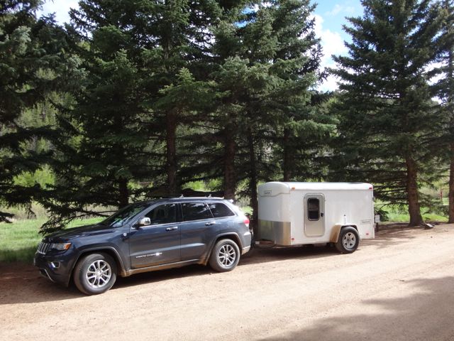

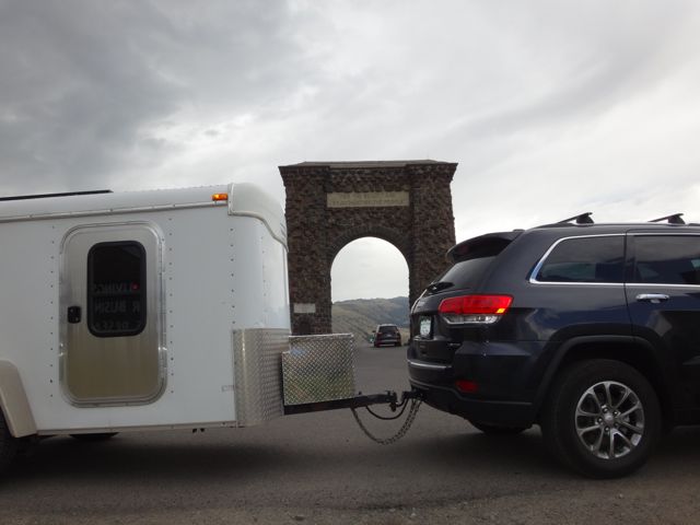

It was time for my first trip with the trailer now that I had finally gotten the suspension mounted and wheels/tires mounted. I failed to mention earlier that after purchasing the timbren kit, I later discovered that I needed longer spindles to accommodate the wheels and tires that I wanted to use. I wanted off road capable suspension that would prevent crappy roads from shaking my hard work to pieces, but didn't want my overall trailer height to be too high, so I ended up going with the Timbren ASR2KHDS05 kit, which is the 2000lb, 4 inch drop kit. This would give me a clearance of about 13". After purchasing the trailer and taking off the old axle, it sat for about 2 months before I got the new suspension - and then the correct wheels/tires installed. I was excited to take it for a test run.
My wife and I drove about 80 highway miles, and then 7 miles up a washboard road to a campground. I was thrilled that the suspension was awesome. The trailer did not bounce around in my rear-view mirror at all. I was pretty stoked. At this point the camper was simply a 5x10 open space, and we threw all of our camping gear in and had a great weekend.

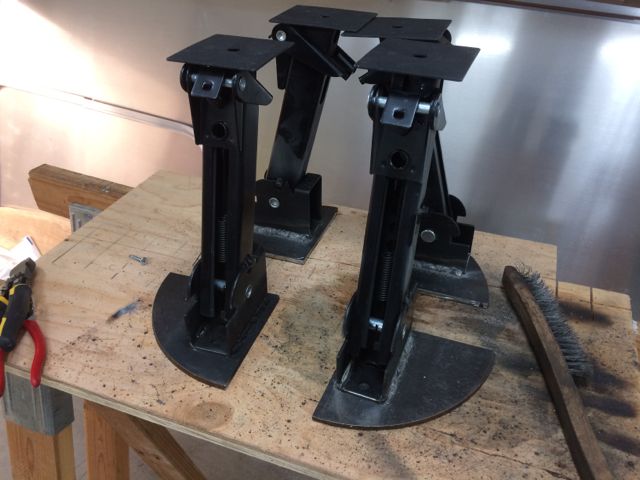

Our camping spot wasn't completely level, and after trying to pull the trailer up onto pieces of firewood to level it out I decided I needed a better system. I purchased some jacks on trailer, and found some old rusted 1/4" thick steel discs at a metal yard that were about 14" in diameter. I cut one into quarters, and welded a stabilizer jack to each quarter, then welded one unit into each corner of the trailer.
The jacks were cheap (I think about $15 each) and worked surprisingly well!

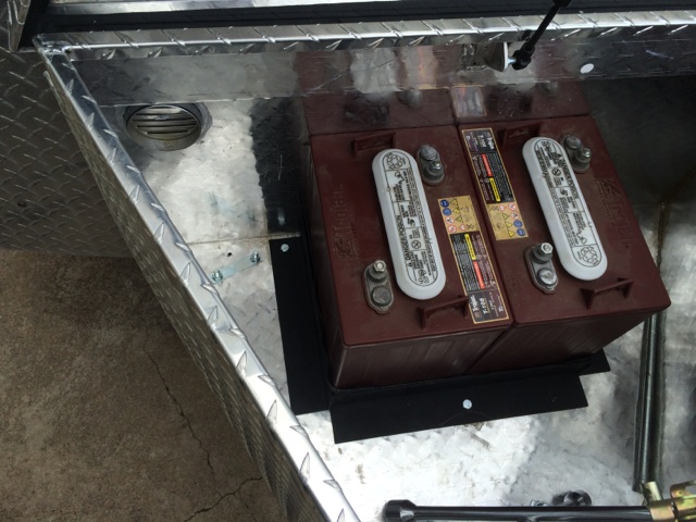

I had purchased an aluminum tongue box which I planned to use to house the batteries. However it was a bit too deep, and I had to remove the tongue jack to get it mounted, thinking that I could use the stabilizer jacks I had just installed to get it off my hitch if needed. This was a bad idea. I also followed the tongue box installation instructions and screwed through the floor of the tongue box into the tongue, however the screws supplied were tiny, and several would break during my road trip. I hastily bolted in a few elbow brackets to try to secure the batteries in place, however these also eventually got pretty loose on the trip and the batteries slid around a bit. I was in a rush to get my fan hooked up before packing and hitting the road and cut some corners in the process. But one day prior to leaving I wired the fantastic fan up to the batteries and it worked like a charm. I also quickly built a 2x3 fir stud wall in the trailer separating the sleeping/living space (approx 7 feet long) from the rear kitchen/storage space (approx 3 feet long). Now at least our sleeping pads, bags, and duffel bags were separated from our cooking gear and food. I also purchased a bracket for mounting a 10 pound propane tank to the left rear of the trailer, which I would be able to hook up to our stove, and eventually heater/water heater/camp oven.

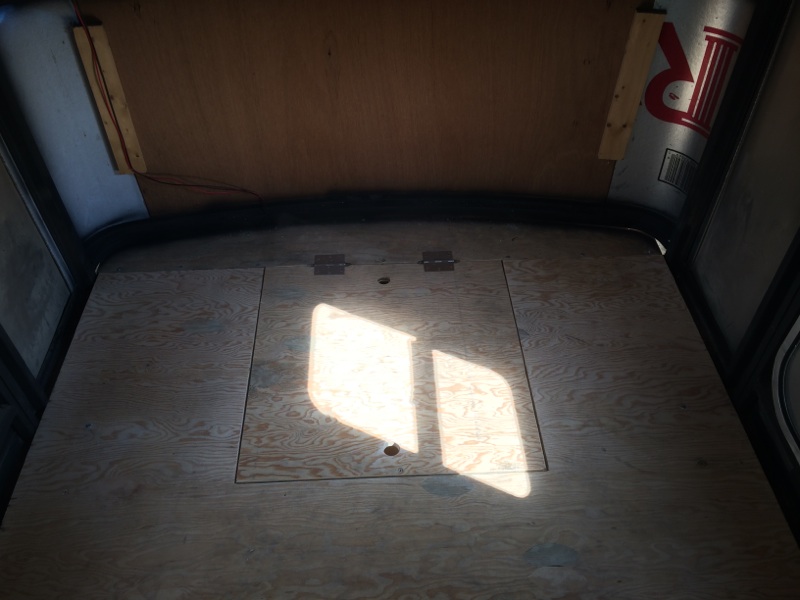

I think we traveled more than 2000 miles on our road trip, and the suspension continued to work great. As I had simply screwed a plywood floor down to the floor joists of the trailer, a fair amount of dust made its way in after travel on dirt roads....overall a great trip!

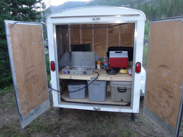

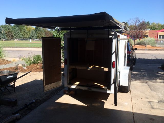

I had convinced myself that I wanted a small trailer with a cooking area separated from the living area, as I didn't want all my gear to smell like food. Although I don't own and have never used a pop-up, I figured that would be an issue, just as I had experienced cooking inside an RV with everything smelling like food (or smoke). I was quite inspired by the Moby1 XTR off road teardrop, and intend to borrow lots of ideas from their design. I was really interested in getting an awning, and after I saw the Hannibal Safari awning with enclosure walls it really got me set on the idea of a small camper with an outdoor enclosed space to hang out in during bad weather or mosquitos, or when I had more friends camping than would comfortably fit in the trailer.

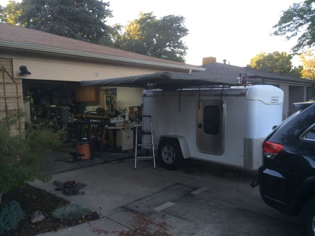

I contacted the guys down at Hannibal Safari (South African company out of Cape Town) about purchasing an awning, and they happened by be shipping an order up to the Denver Airport and thought I might be able to get a good deal on the freight. Air freight turns out to be really expensive, however I was able to get a great deal by adding the awnings to the other customers order and splitting the shipping cost. I ended up purchasing a small awning for the rear of the trailer and a larger one for the side with drop down walls. This was definitely my biggest expense in the project, however I was pretty certain that this outdoor enclosure would be worth it in the long run.

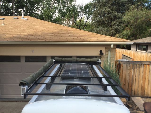

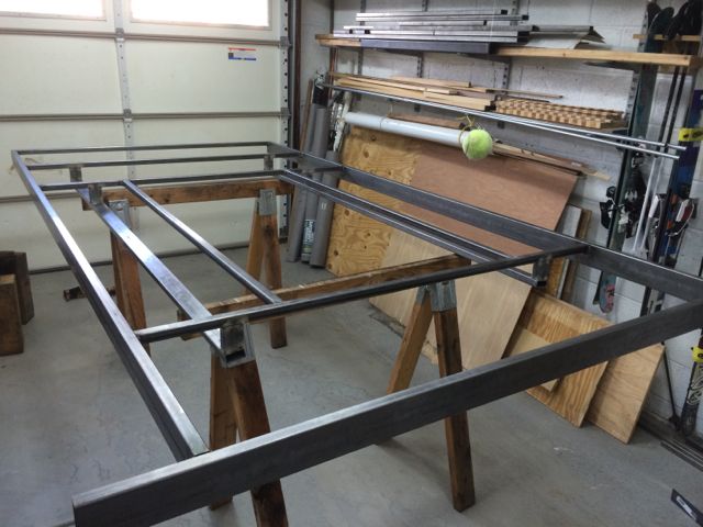

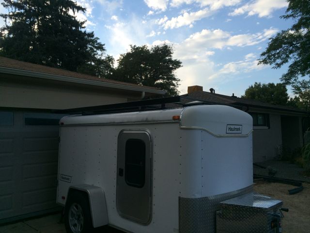

I contacted a metal fabricator about building an aluminum roof rack that I would be able to attach the awnings to, and could also be used for extra storage, and possibly even fit a raft on top (for short, slow drives). We got together and I showed him some sketches, but his rough estimates for the aluminum alone was going to be over $500. Another $500 or so in his welding time was a rack way more expensive than I was prepared to buy. I ended up welding up a rack out of 1x1, 1x2, and 1x3 steel tubing. It ended up being a bit heavier than I had hoped, but it appears to be pretty durable.
Finally I got the rack mounted and it felt pretty secure

Mounting the awnings took another long day of careful measurements and slow drilling. I had to try to position the larger side awning at the correct height to allow the bottom of the awning walls to just barely sit on the ground.

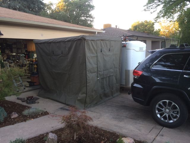

I was pretty excited when I was finally able to set up the awnings after they had sat I'm my garage for most of the summer...The awnings are pretty cool as they take less than a minute to set up and are free standing, without any legs or ropes to deal with or trip over. Hanging the walls took a couple of minutes but was pretty easy. These things seem to be very durable and well built, I guess time will be the judge...
The pics of the side awning (and walls) was actually before I had bolted the awning to the rack, I just had it clamped to figure out the right height

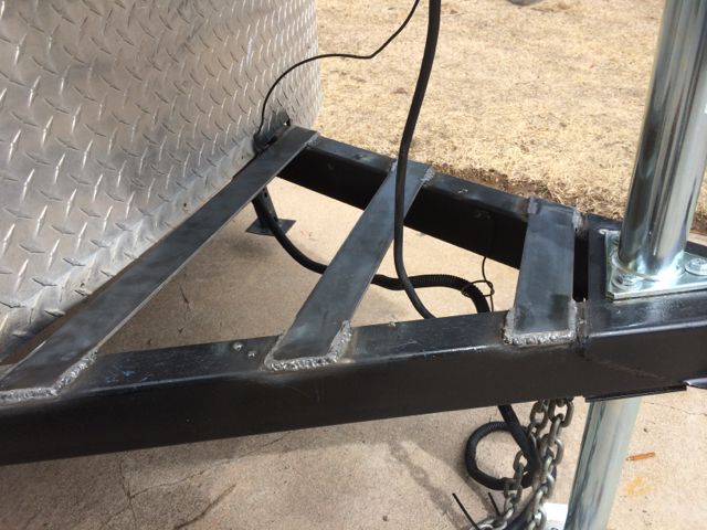

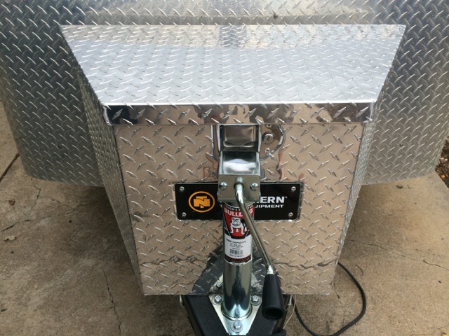

I ended up pulling the tongue box off, welding on some pieces of steel for additional support, and using heavier duty U bolt mounting brackets to secure it to the trailer tongue. I also found a tongue jack with a side crank that would work with the tongue box, as the top crank on the stock jack wouldn't turn as it would've hit the box. I bought a piece of angle iron at home depot and made a three sided bracket to keep the batteries from sliding around. I bolted the bracket down to the reinforcing pieces of steel which now feels pretty sturdy.

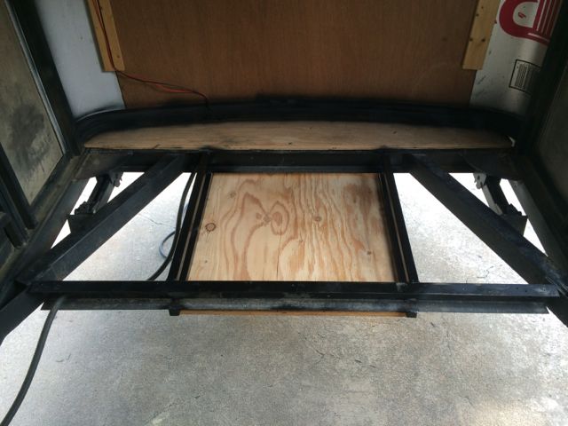

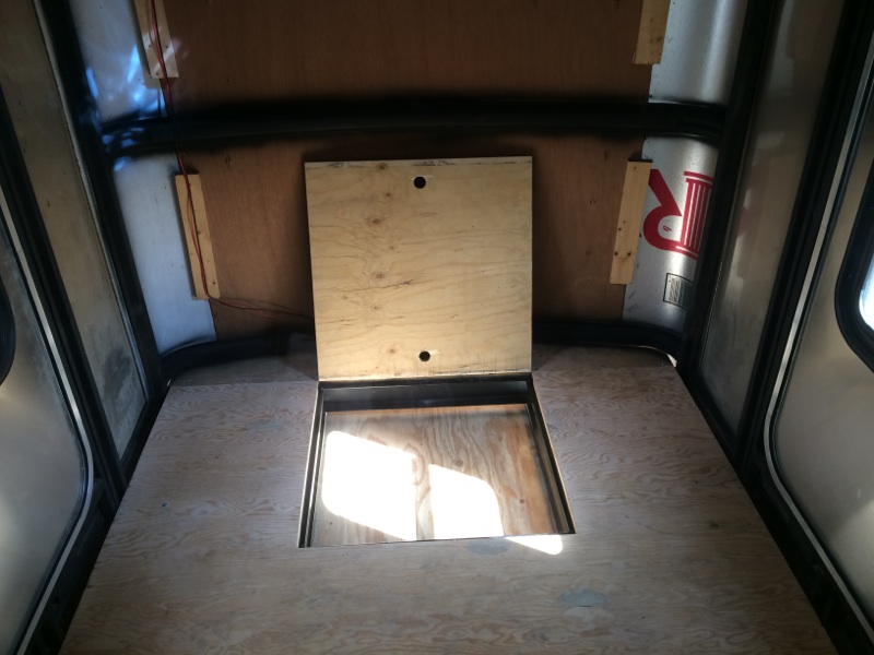

Currently I am trying to get ready to wire up the solar system. For some time I've been trying to sort out where to mount the charge controller, fuses, and inverter. I have head that the charge controller can make some noise, so I really didn't want to have it in the main cabin area as I am a very light sleeper figured it would probably wake me up when the sun came up and the system started charging. Apparently to maximize a solar setup, the charge controller should be as close to the batteries as possible, which eliminated placing the charge controller in the rear kitchen area. This week I finally decided to make a compartment below the floor to house these components. I am a bit concerned that there won't be the recommended clearance around the charge controller in the enclosed space. I am thinking that if things do heat up I can probably put a small fan down there for some airflow.
I used two 1x1 pieces of steel tubing welded to the bottom of the trailer frame to give the compartment an extra inch inch in height and a bit more clearance, however this did cut into the overall clearance of the trailer as far as going over rocks, etc. I cut a 2'x2' section out of the floor over the compartment and hinged it, to allow for relatively easy access. Now this compartment is only several feet away from the tongue box and batteries, which from what I have read will make for a more effective solar set up.
If anyone has any strong advice against putting the solar components in the compartment, I would love to hear. I think the main issue is heat, and I will be running a pretty small system so I'm hoping this won't be much of an issue. I've also read the charge controller should not be in a compartment where battery gases can accumulate, but this should not be an issue. I'd love to hear any other advice anyone may have before I make more progress which prevents me from easily correcting some of my mistakes...
