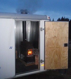

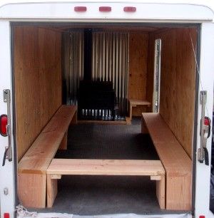

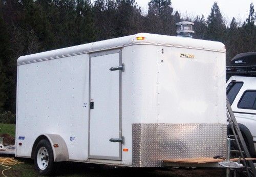

Postby shepoutside » Sun Jan 26, 2014 10:30 am
15-20 person Sauna built into a 6′x12′ cargo Utility trailer.
