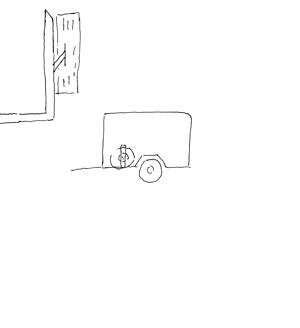

This is my plan for the spare tire. I am going to weld this to the frame on the drivers side. It will be out of the way. I had it on the tongue but that turns out to be valuable real estate when camping.

Postby hankaye » Tue Jan 12, 2016 11:15 am
Al Swope, Howdy;
Just my opinion and it's free so ... I've had to change tires a few times and the last place I want to wrestle
with a spare is with traffic whizzing by me within, on more than one occasion, a foot of the white line on
an interstate. That said, were it me I'd find a place for the spare on the curb (passenger's), side or the rear
of the trailer.
hank
hankaye
Posts: 2567
Location: S.W. New Mexico
Re: Taj Mah-Al (6 x10 CT Build)
Postby lrrowe » Tue Jan 12, 2016 1:16 pm
Good point Hank,
I too think I will built a rack for the spare on my CT right behind the fender; but on the right side. But in my case, the soon to be ordered awning upright might be in the way, and I have plans for a side mounted table which also might be in the way.
So I an thinking out how to make this mount and not hinder these issues noted. Maybe a swing away approach?
Bob
lrrowe
Posts: 3285
Images: 439
Location: SW Virigina
Postby Al Swope » Tue Jan 12, 2016 2:06 pm
lrrowe wrote:Good point Hank,
You guys might be on to something...I could add a small table that would saddle over the spare. You would throw it on when you get to camp!
