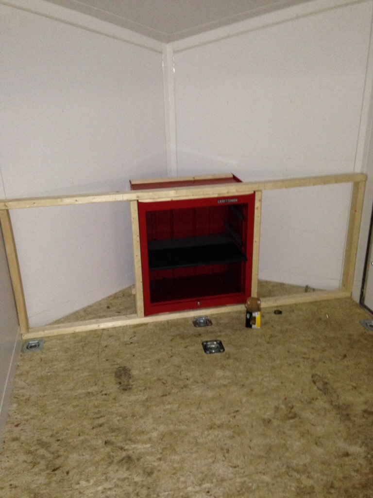

Postby MMOLLECK » Mon Apr 14, 2014 10:58 am
Well now I'm starting over :shock: , yesterday, while at my parents house my dad asked me and my brothers if any of us could use a roll around tool box. I quickly said YUP! I knew which one he was talking about cause I gave it to him a long time ago. Just a small roll around craftsman bottom box. SOOOOOO, all that framing I did will be taken apart (luckily its all screwed together) and I will build cabinets around this tool box. I figure it will give me plenty of drawer space, to be used as half tool box, half utensils (plastic knives,forks….spatulas…whatever) then the cabinets can house all else. Also thinking about leaving openings on either side for long items (bags set, folding chairs etc) to slide in for transport. Ive figured out with this, that I'm really not horrible at construction….I just need a firm direction on where to go instead of thinking of it along the way :lol: Im looking forward to this part being done so I can move onto other projects (windows, power, vents etc)

Postby AZ_Desert_Rat » Mon Apr 14, 2014 4:23 pm
Sounds like you have a plan ... Great going and we are waiting for the photos :pictures:

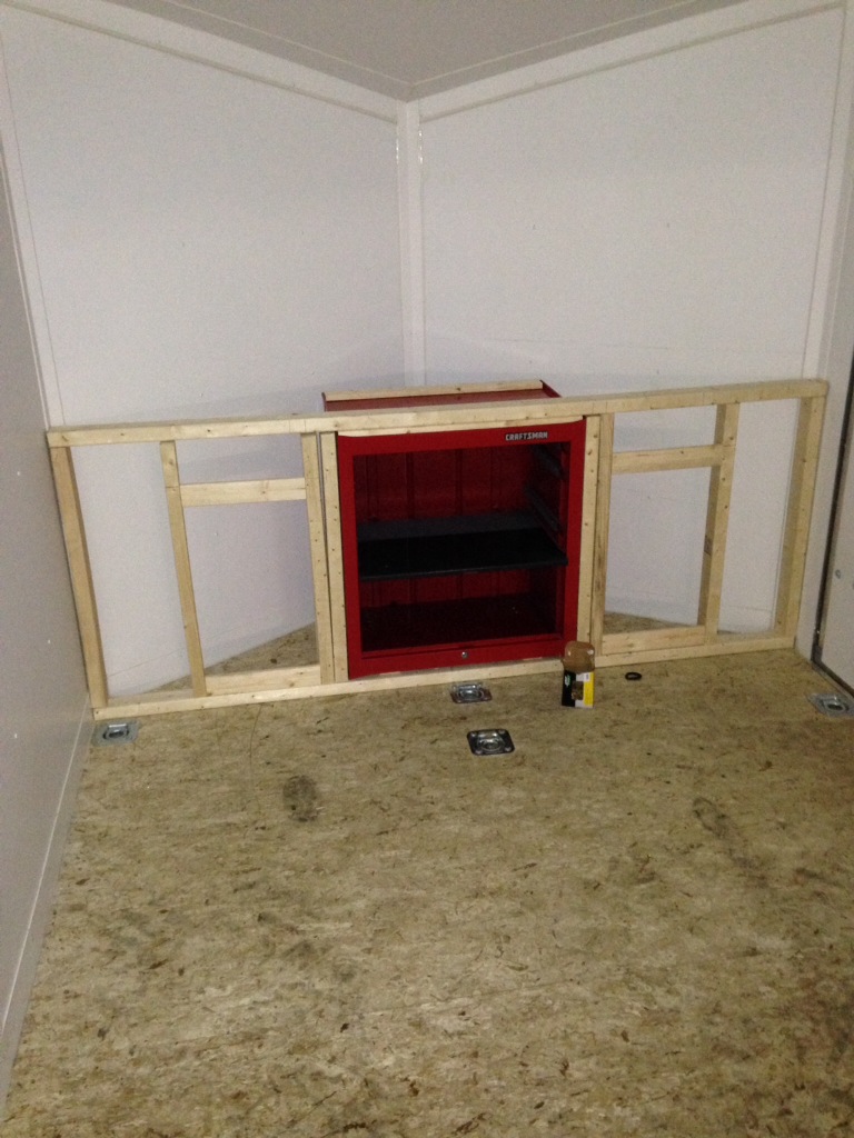

Postby MMOLLECK » Mon Apr 14, 2014 8:35 pm
Well it's snowing here (gotta love Illinois weather) so prob start on it tomorrow. But now that I have a half way plan, I think it will go somewhat fast

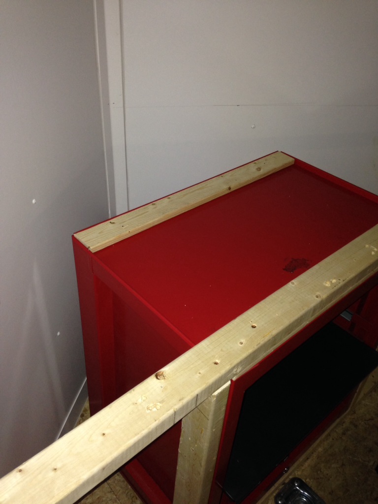

Postby MMOLLECK » Wed Apr 16, 2014 9:47 am
Well was able to get out to the garage for just about an hour last night. Enough time to get the casters off the tool box, clean it out, cut my hand on who knows what and get things in motion. Actually worked perfect. I set it in the trailer for a visual and it will fit just how I want it. Hoping this weekend to find a few hours time to get it framed in. Should go pretty quickly. I got a deal of a lifetime on batteries, that I am picking up today. My friend has 2 6 volt golf cart batteries, wired in series, WITH a solar panel. Don't know what the solar panel is rated for, but he says its plug and play, and everything is good to go and basically new. says the batteries offer 232AH….I think that'd be enough :twisted: for the bargain total of $50! No typo, $50.00! Then this weekend I have a side job coming in (hail damage car) which should give me enough money to order everything I need to complete the basics of this project……two slider windows, powered roof vent, battery cases, stereo, speakers, lumber to finish front end build and whatever I decide to coat the floor with. Ol UPS man will soon be santa :lol:

Postby MMOLLECK » Wed Apr 16, 2014 10:18 pm
Well had some time tonight to work....would have gotten a lot more done if I would have remembered to plug in my drill battery! Have all the drawers out of the tool box to bolt it down. Right now it's just lightly screwed do to hold it. Will have cabinets on either side of tool box, and the large openings on the ends will be where the speakers will be mounted. All when said and done will be covered in cabinet grade plywood and painted to match tool box (red with black cabinets) at least that is the thought as of now

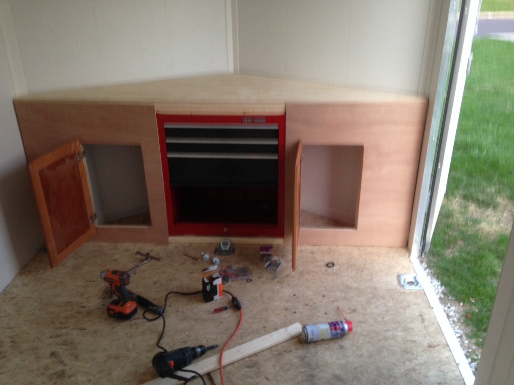

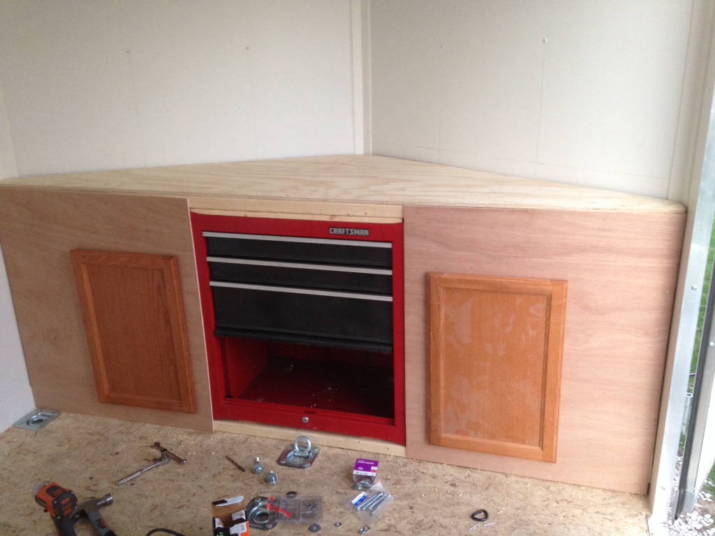

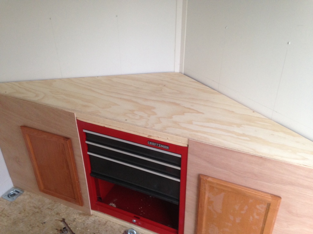

Postby MMOLLECK » Sat Apr 19, 2014 10:55 pm
I feel like I made so pretty good headway today. Wrapped up the most of it, used sanded 1/2 plywood for the top and 1/4 luan for the front. Still need to cut two pieces for top and bottom of the box, paint and trim.

Postby citylights » Sun Apr 20, 2014 8:30 am
Looks good. That toolbox is a great centerpiece!

Postby AZ_Desert_Rat » Sun Apr 20, 2014 12:50 pm
Hi MMOLLECK,
It looks like you are off to another start and the cabinet is looking good ... the toolbox looks like it was made for your CT! :applause:
