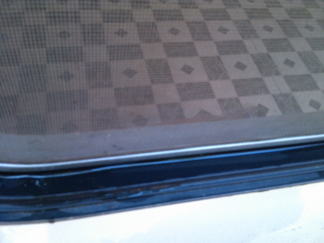

Ack!!!! My window still leaks! We got the futon out, and I brought all the staining supplies out to the trailer, opened the vent and the window before preparing to paint, and--there is water in the groove between the outer glass panel that slides open and the inner screen. Is this just normal? I'm thinking over time, and with seasonal freezing and thawing, it is NOT a good thing to have any water getting in there at all. What should be done? Is it a problem in the window itself (which I bought from a Craigslist seller so have no recourse after this much time), or something I can take back to the place that installed it and tell them to fix it right this time? :x
Jim
There is water between the sliding glass and the screen
IMG_20140530_145211 (640x480).jpg (149.25 KiB) Viewed 2309 times

Is it water that has leaked or condensation that has accreted on the window and run down? Usually a trailer's doors are opened in the daytime when it's warmer, and the trapped moisture bearing air when it cools later as night falls, drops its moisture on the best available hard and cold surface, usually the moisture will beeline for a window.
