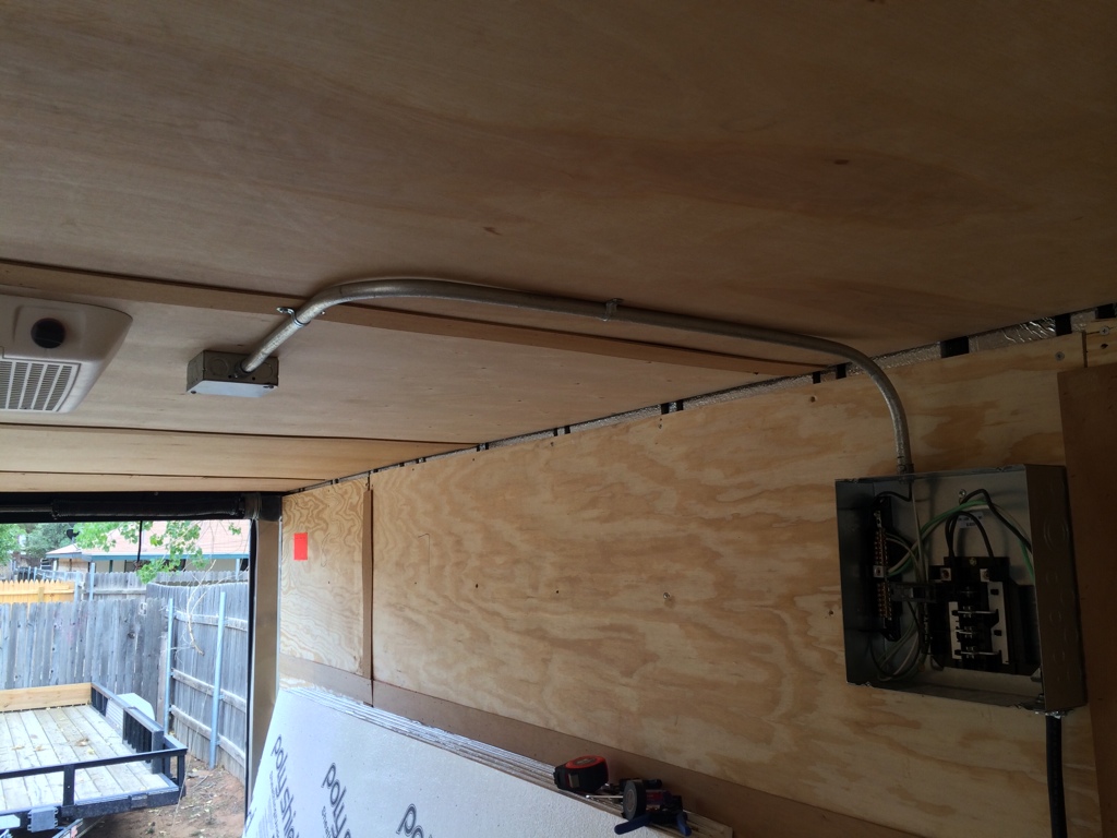

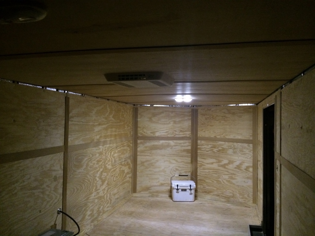

Postby brandon32689 » Sat Aug 23, 2014 12:45 am
Got ac mounted and almost all the insulation installed.

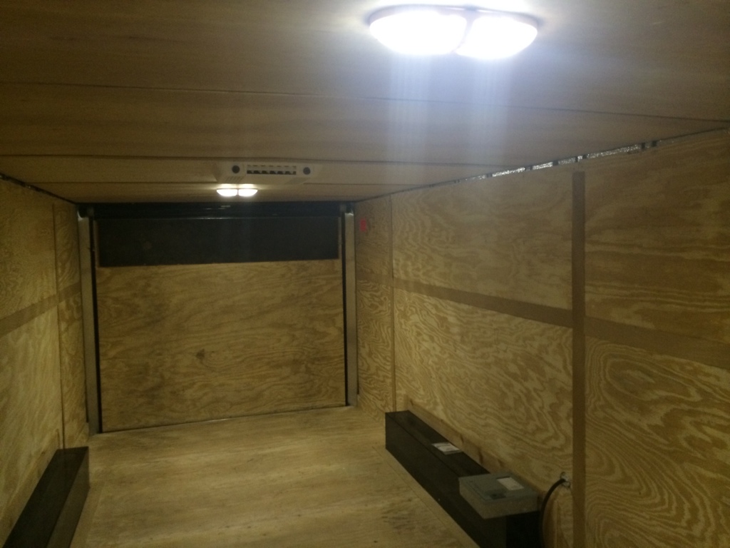

Re: Need advice on my new 8.5x20
Postby brandon32689 » Sun Aug 24, 2014 8:14 am
brandon32689
Posts: 57
Joined: Tue Aug 12, 2014 5:23 pm

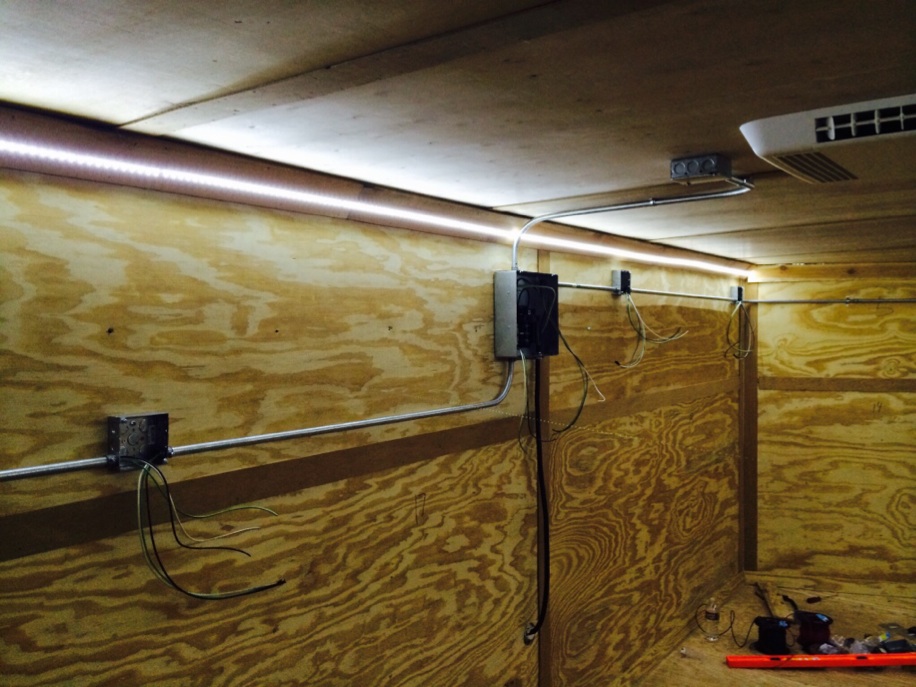

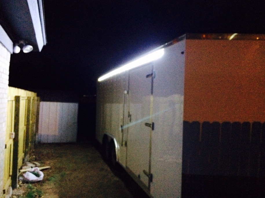

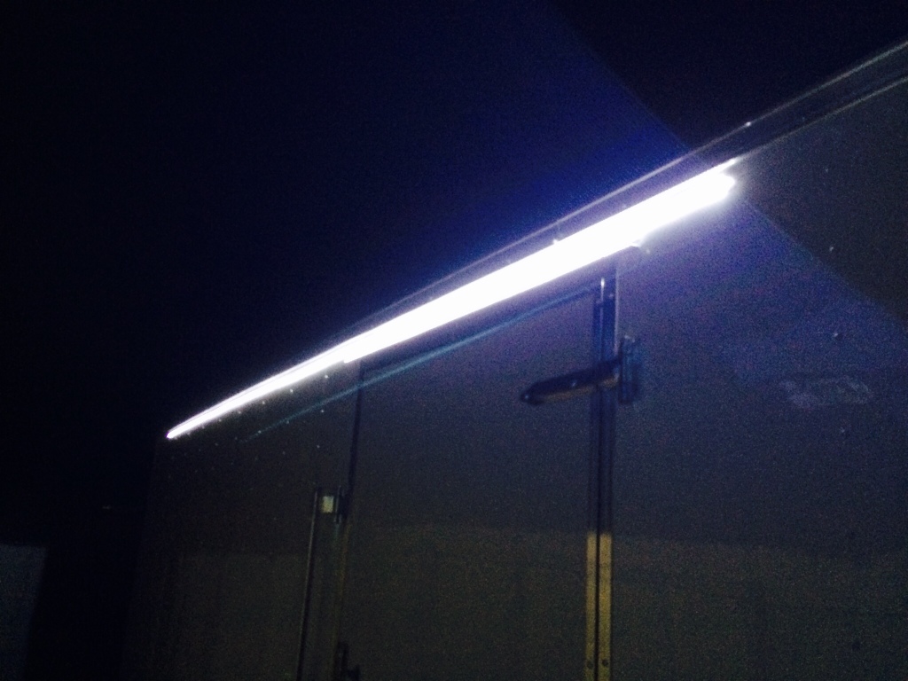

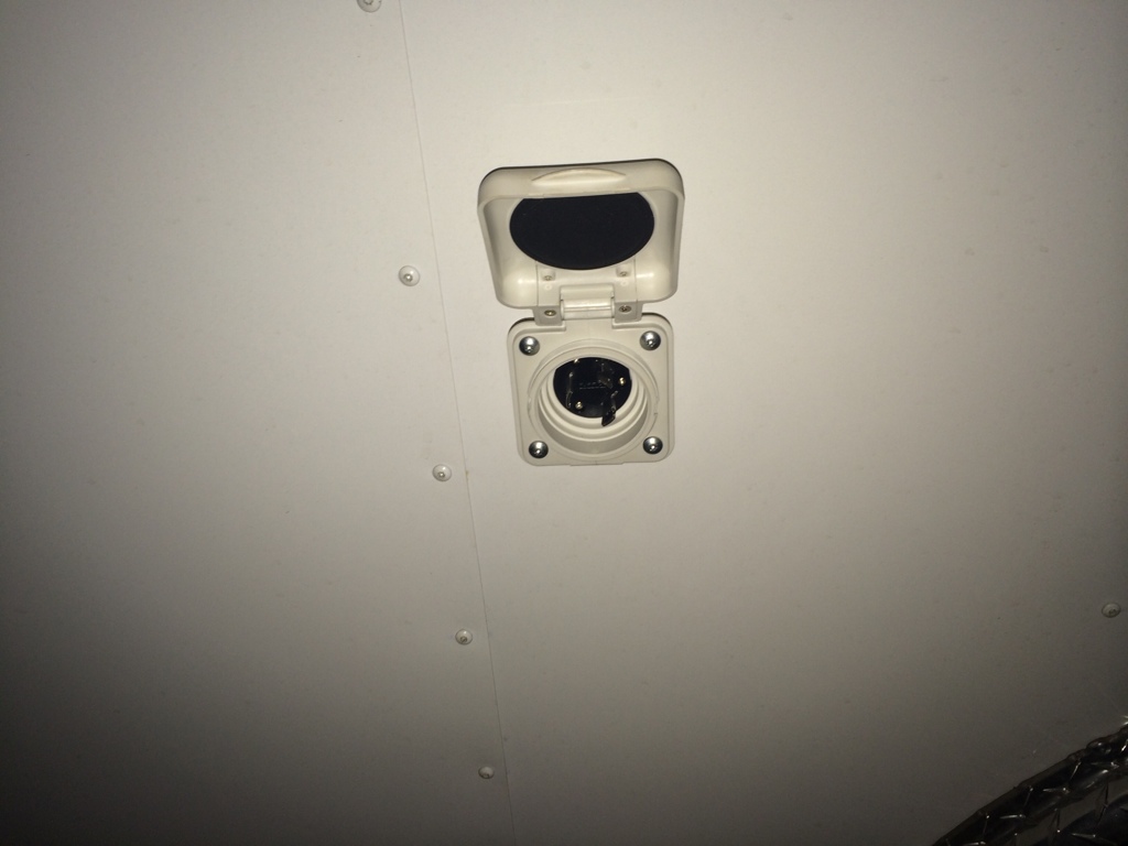

Postby brandon32689 » Sun Aug 24, 2014 1:36 pm

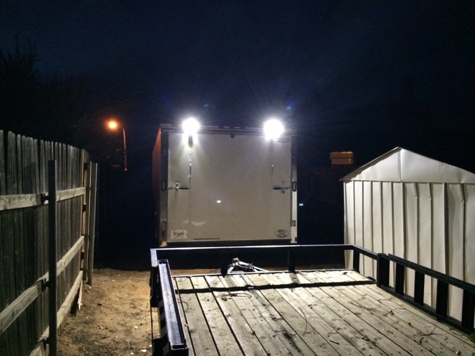

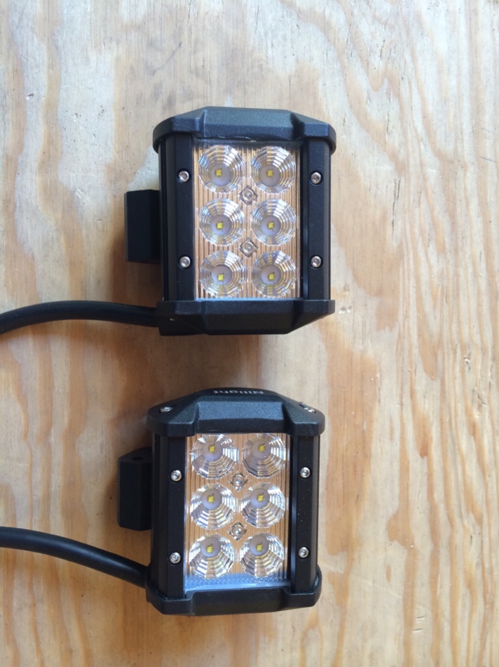

Okay so far I've got all the panels back on and a roof up, all insulation behind it and air conditioner installed. I have my new led dc lights installed.
I have 2 led strip lights I plan on putting down each side on the inside as we'll and I mounted 2 led cube lights at the ramp to see at night.
I got my 30 amp plug wires in and bolted to the trailer. I need to mount my breaker box and fun conduct for a few plugs and to the ac.
I still need to decide in a trim from where the walls and ceiling meet. I'm thinking some type of crown moulding.
I've decided to mount my batter on the tongue and will for know keep it separate from the ac. I will just charge up the battery after a weekend of use. Or maybe add a solar panel on the roof. I am looking for some dc light switches next just to break the current from the positive cable.
You guys have any advice or tips for me please share

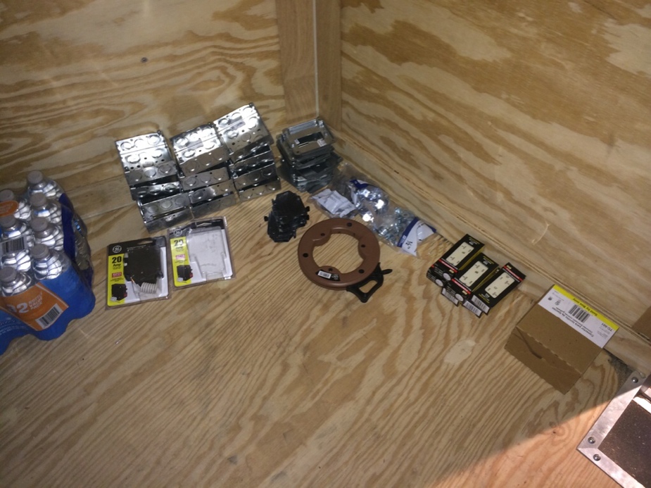

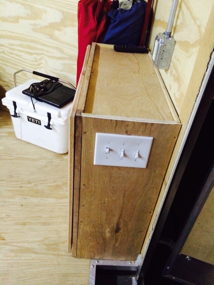

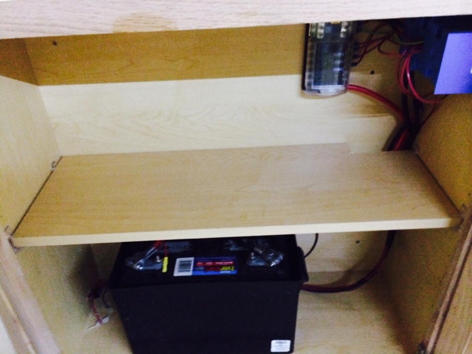

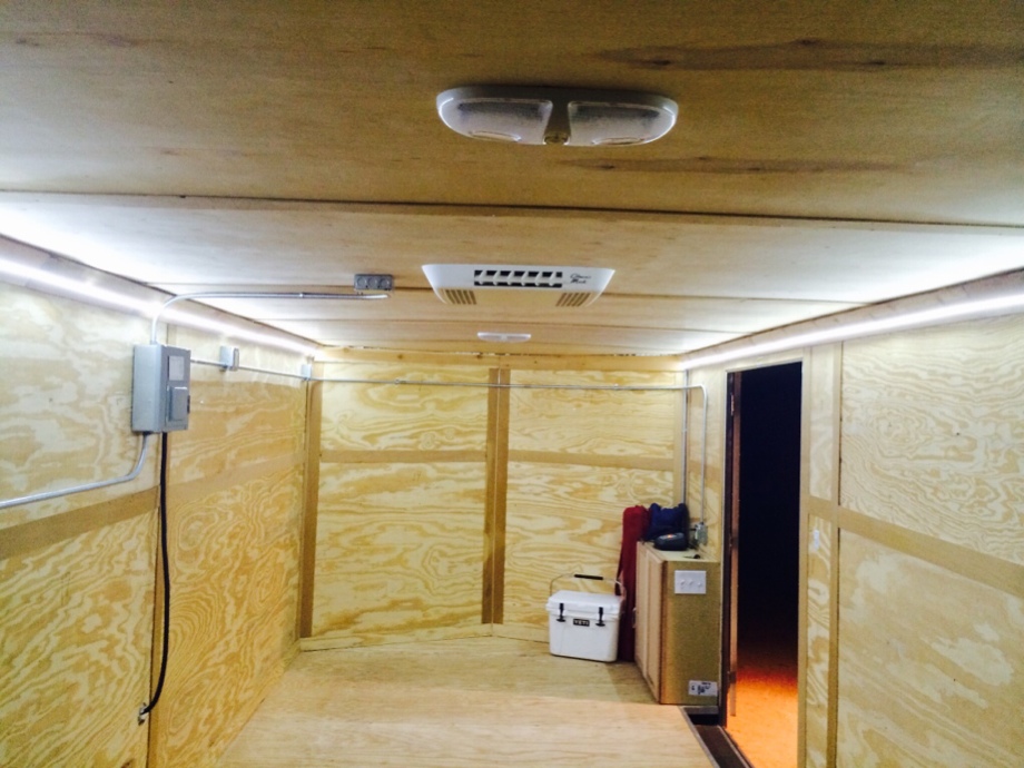

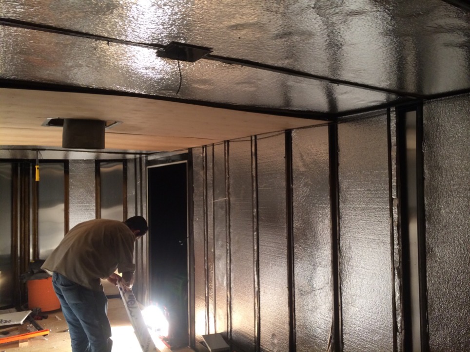

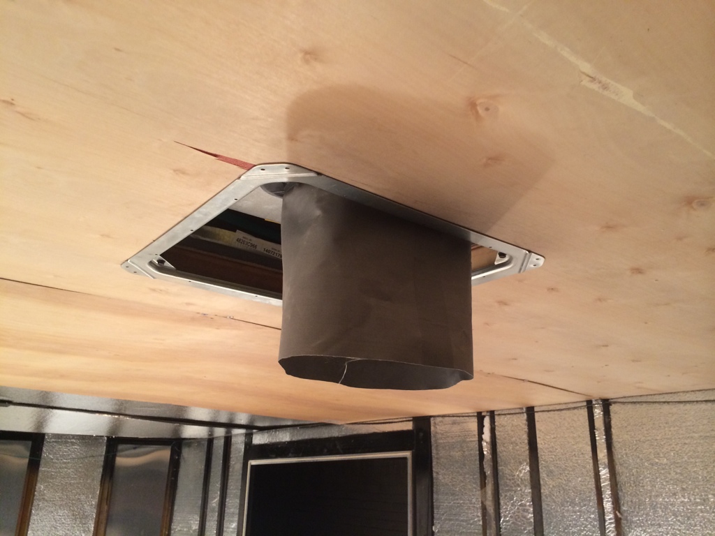

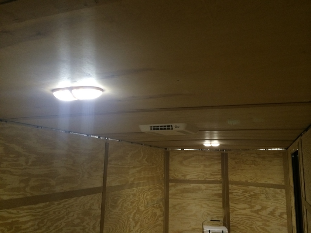

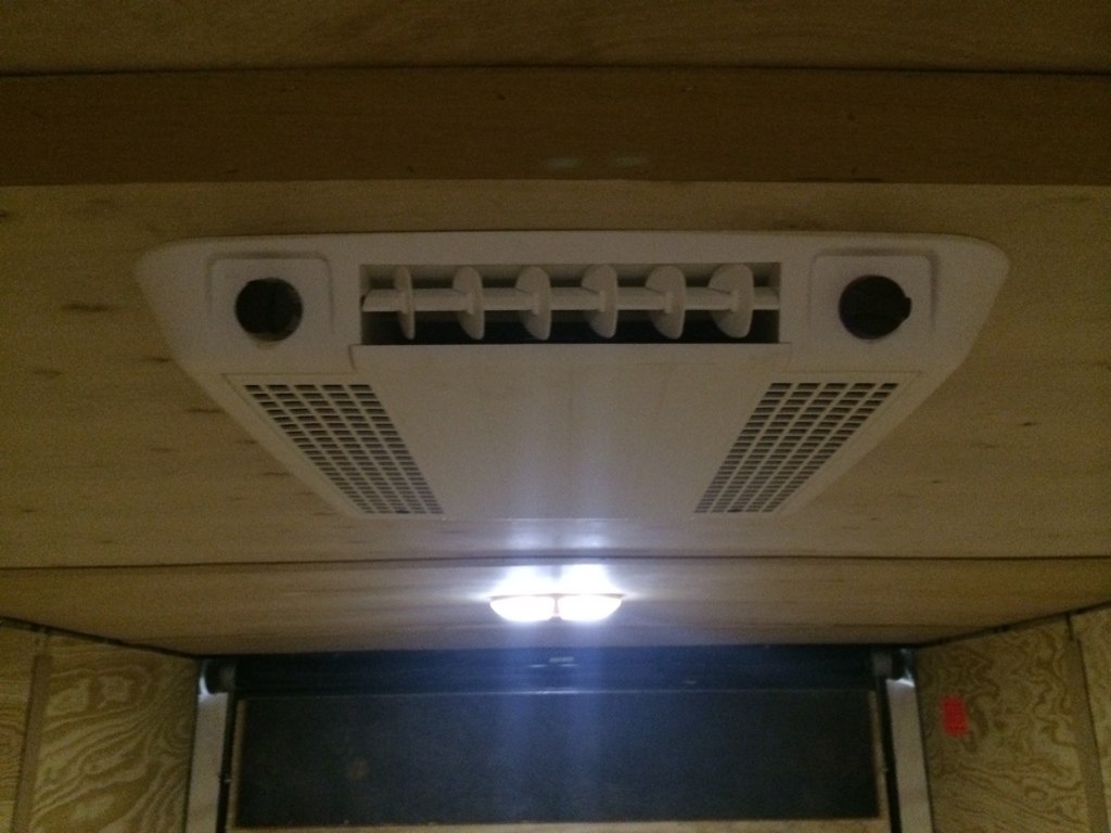

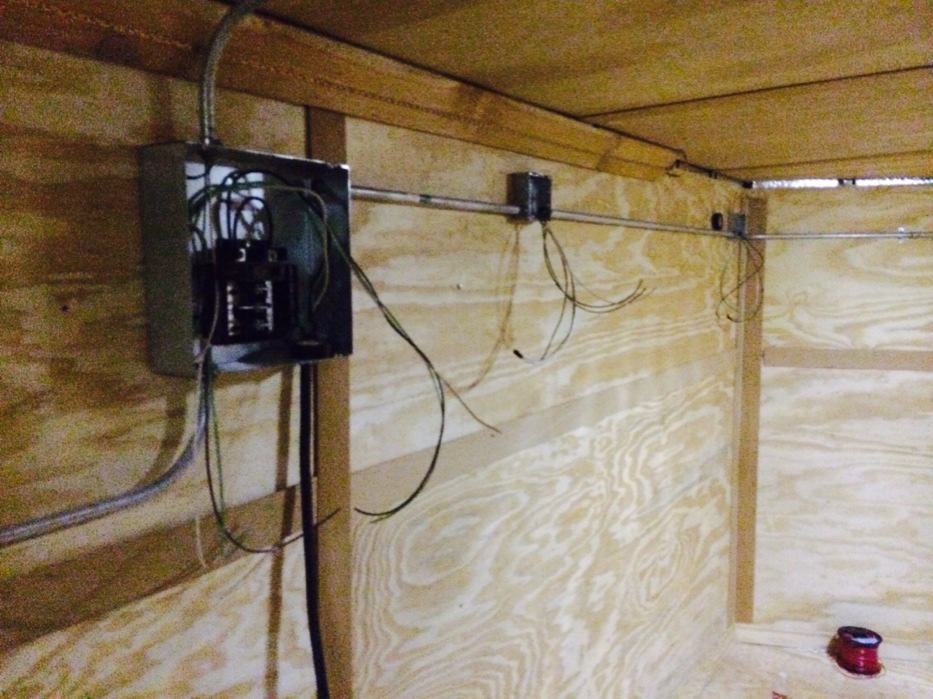

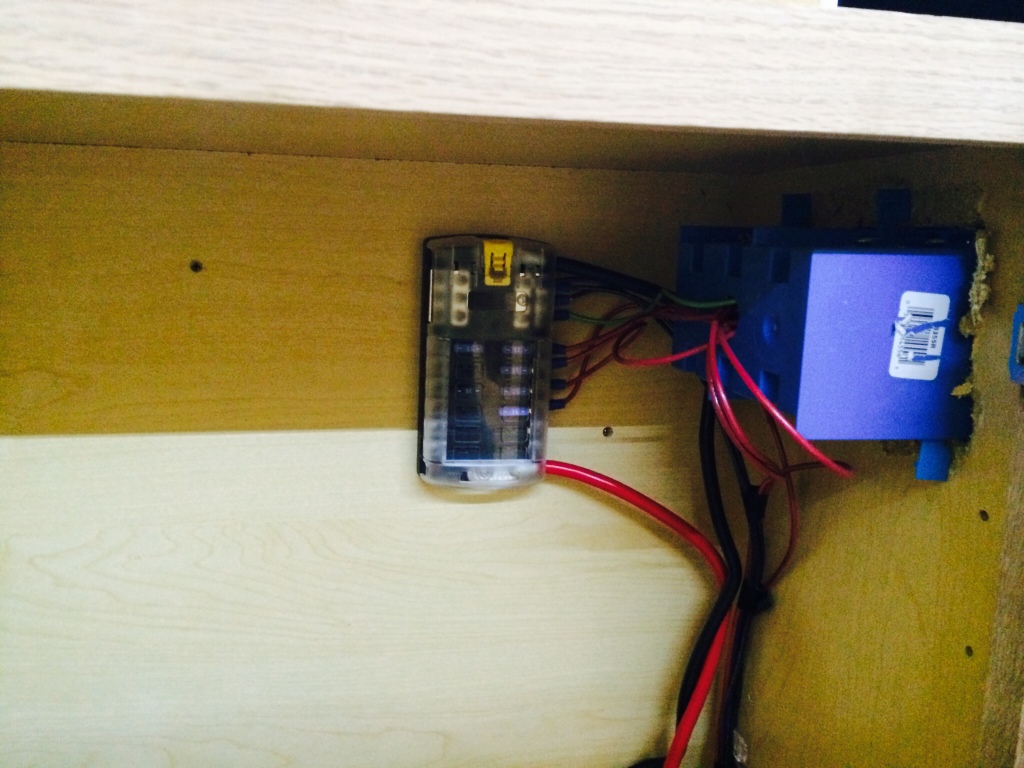

Postby brandon32689 » Wed Sep 10, 2014 7:42 pm

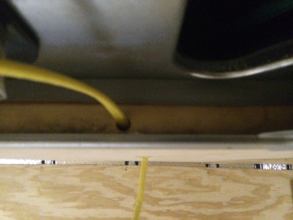

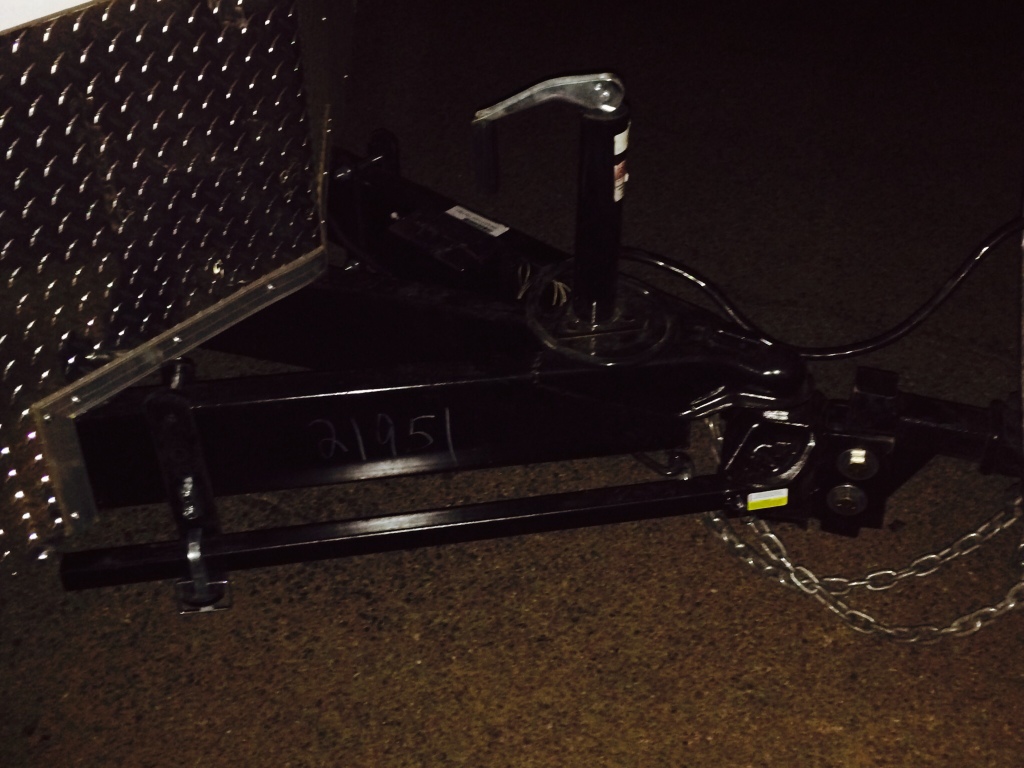

Hey guys I have not updated this in a while,
So far I have added all my panels back up after insulation, added insulation to the roof and thin plywood to the roof. Got my ac in and all wired up.
I did not realize how many little things it takes to do things like this. It's still got allot to go but as if now I got it to where I can take it to the dunes for a night and have a cool place to sleep.
Things I still need are a window of some sort I will be putting it in the door and my door is almost 4 foot so lots of room. Also I need a vented battery box so I can vent it out anyone have any ideas on that?
I'm also wanting to add a canopy outside so looking into that.
I will not start on any plumbing till prob this winter while i can't take the rzr out.
We'll guys take a look at the pics and please give me pointers, I have never done a build like this so all good/bad feed back is welcome.
brandon32689
Posts: 57

Postby chiefb711 » Thu Sep 11, 2014 3:41 pm
Your build is really looking good! Keep up the good work!
