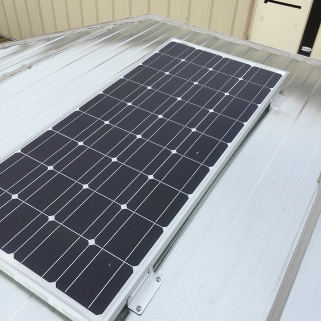

Postby abqlloyd » Mon Dec 22, 2014 3:03 pm
Renogy 100W roof mount. Used their $8 z-mounts.

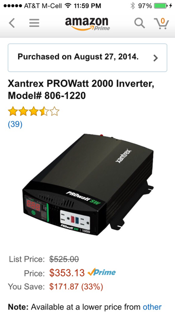

I'm curious how many outlets & circuits most have in their trailers and if they wish they had more or less? Also any great/poor experiences with inverters and converters? I'm working on my electrical layout now and leaning toward a xanttrec inverter/converter all in one (http://www.amazon.com/gp/aw/d/B00DA0CXU ... C4C55FORLO) as a single point solution for AC-DC with basically 4 total AC circuits 2 off the shore line, one of which feeds to the inverter/converter which then is passed thru to 2 sub circuits. That way I have 2 AC circuits on inverter only and 4 (or 2 depending on perspective) otherwise on generator/landline. Doing so boils it down to 2 simple panels with 2 circuit breakers each.

For that money you might be able to get a true sine wave inverter and a separate battery charger.
I bought this one earlier this fall to replace my Prosine and it has worked flawlessly.
A transfer switch is about $50 and 40amp charger another $50. While it takes up a little more space there is a huge difference between modified sine and pure sine on electronics.

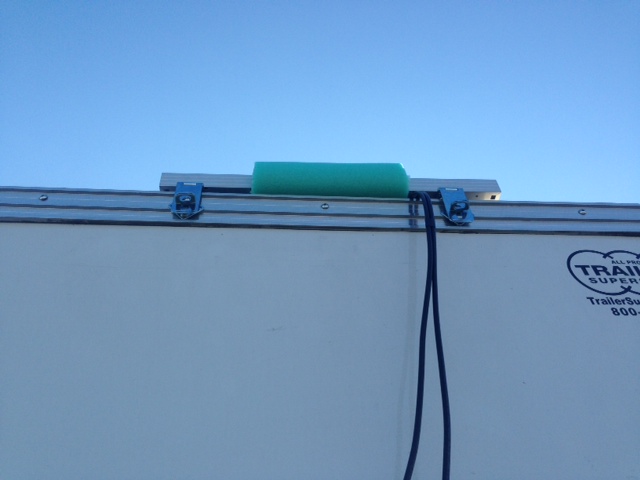

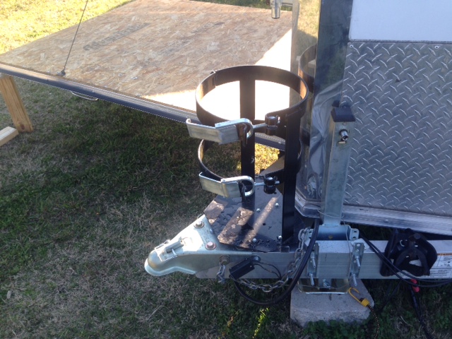

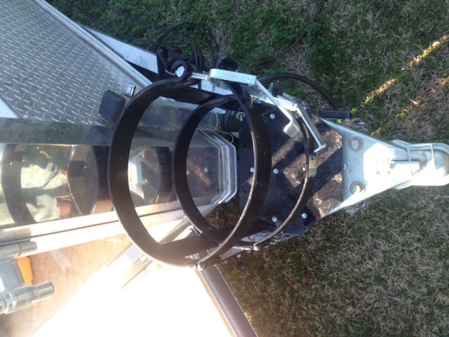

Here's my propane tank holder:

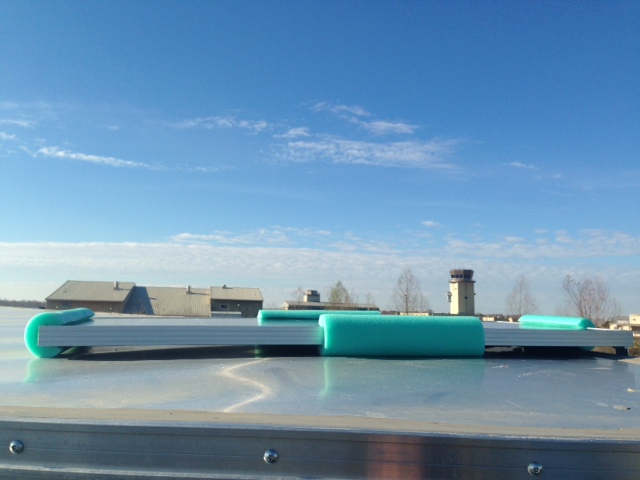

I stole someones idea for the solar mounts, and bought the swivel gate hasps. which allows the panel to be mounted in multiple locations. Here's one of spots, which allows it on the roof or side. I also have one inside for transport, and will have another one on the opposite side. Wire disconnects at the nose allow swaps.
apparently 3 pics is the max per post so...

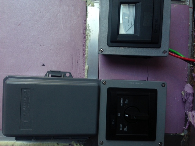

DC electrical panel is mostly put together (still need to run most of the accessory wires) the LED's will show voltage, time or temp. I bought them to show inside and outside temp. The analog meters are voltage and amperage. The other random box is the solar charge controller:
and I started mounting the AC side, but haven't finished much other than identifying where I'm putting them, and how it'll come together. AC amp meter box also contains the trailer input connection (hence wiring hanging out), and the transfer switch is next to it. I liked that the transfer switch will detect/display reverse polarity and power available. Main breaker panel will get mounted above.
Cutting the hole for the AC in allowed me to assess how the insulation actually set up. I'll post those next.

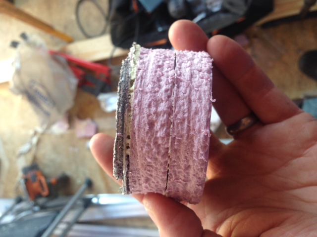

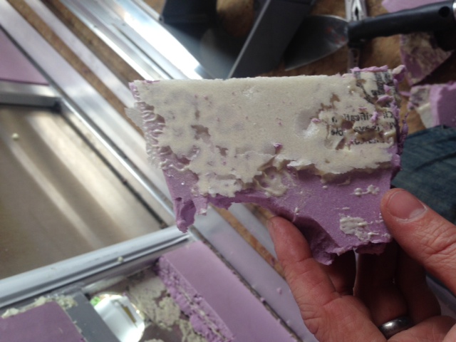

I used dual 1/2 " foam board insulation and after reading through the 'big' foamies post and some trail and error elected to use great stuff as my adhesive.
Thats my hole cut from the ac inlet. You can see good bonding and fill in from the expanded foam. Adhesion was very good with the exterior aluminum skin (back of picture, and pretty good with the foam itself.
So bottom line I'd recommend using this technique for anyone considering how they'll insulate. Spray foam would have been best, but was to expensive for me.

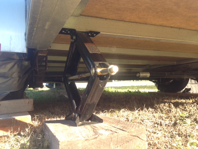

Final item of note is the stabilizer jacks in the rear... not very exciting but here you go...
