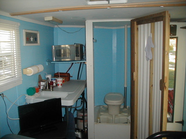

Postby Doublacola » Fri Oct 16, 2015 9:44 am
This is what we ended up with and we're not real happy with it. Thinking about removing it and going the porta potti route. In our 12' box I've used up a lot of valuable space. Also am going to try and shorten the table/sink combo.

Re: Minimum bathroom closet size
Postby Spotman » Fri Oct 16, 2015 10:05 am
Every time we go camping we come back with a list of "to do's". Does it ever end?
RT
You know as well as all of us, it never ends. Sitting in mine right now at Pocomoke, MD. campground making notes!! :thinking:
