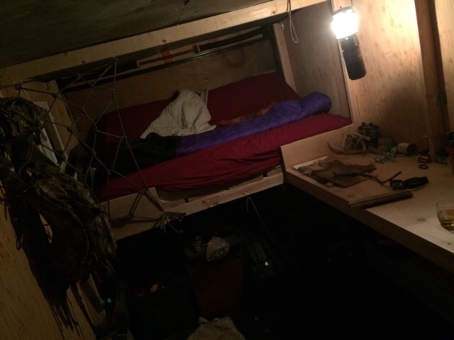

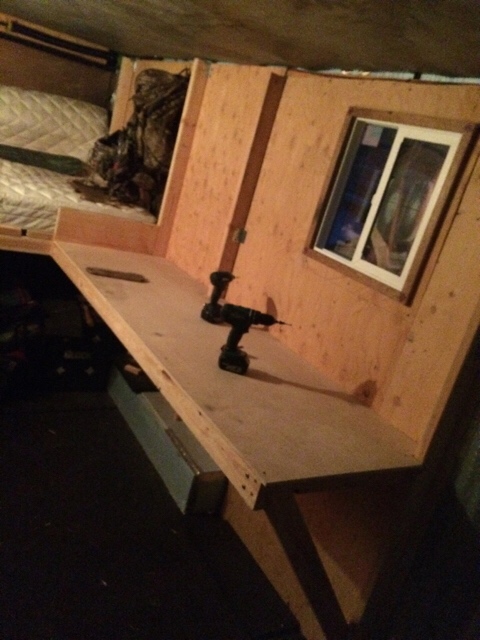

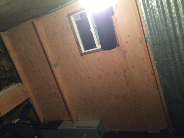

Got a bed lofted in fits a bent ikea king mattress I had lying around. This serves as a bit of a couch back so it's pretty comfy, with a flat section of the mattress at 4' wide.
Bracketed in some vertical 2x4 to the wall that are in turn mounted to some studs that run horizontal at top,mid, and bottom of the trailer. These horizontal studs are 2x4 ripped to 1x4 and fastened to the trailers metal vertical frame 1x1s.
The with the same method I mounted in this bench/counter on the driver side. It's pretty high, I'm 6,5" so I don't like low counters.

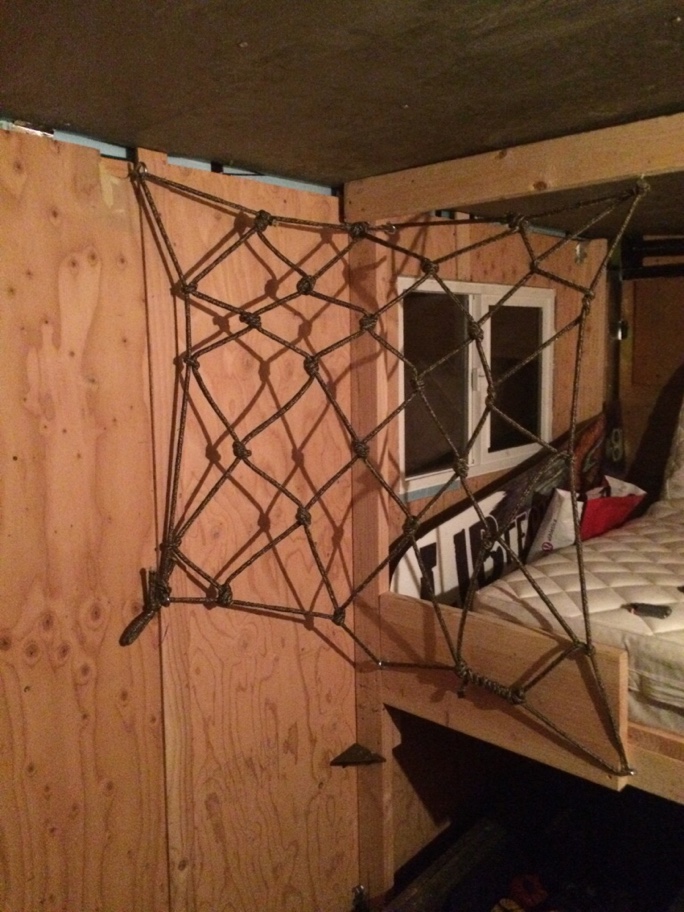

In this corner by the bed I have woven/tied in some HDepot rope to make a net wall. Since my clothes will be transported weekly back to PDX with me for washing they will constantly be in bags. So I figured hanging them in their bag (sock/base layer underwear bag, shirts bad, pants) It's the net wall dresser. Works good to drape various gear over/thru as well as hang head lamps, water bottles...
This has all become some strange version 1.0 2x4 Lincoln log build.

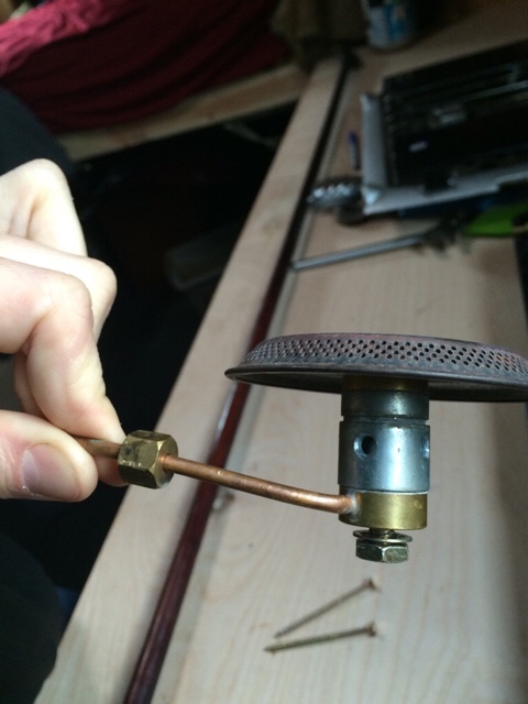

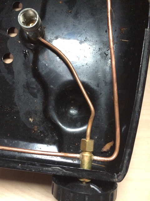

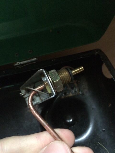

I'm currently looking to get proper tubing for this, flex tube. I'll then get a small (3x3) plate to mount the burner to. Then rig up, weld up, bolt together a small grate to put above the burner, so as to be the resting grate for pots/pans.
All in all with the flex tube and mobile burner I can place the burners a bit more freely. My cast iron and other pans did not fit the best in the restricted space of the Coleman suitcase stove.
Although I could piece it back together and delete the side walls and top/lid... Hmmm

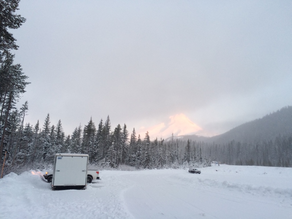

Made it up to hood I've had two nights up here. Snow both nights cold temps and a warm fire. Plus some fresh deer meat.
It's been luxury.
But...
Condensation!!!
I have some exposed metal from the trailer frame inside the trailer. I'm experiencing very abundant condensation on all "trailer" metal. Trailer* meaning any original trailer frame metal or roof.
Any advice on combating this?
Should have spray foamed the whole fawwwking thing !!!

Postby hankaye » Fri Dec 26, 2014 9:36 pm
HsPaap72, Howdy;
Ventilate! crack a roof vent if you have one.
About the best you can do for now...

Postby Prem » Fri Dec 26, 2014 10:36 pm
:frightened:
Condensation!!! I have some exposed metal from the trailer frame inside the trailer. I'm experiencing very abundant condensation on all "trailer" metal. Trailer* meaning any original trailer frame metal or roof. Any advice on combating this? Should have spray foamed the whole fawwwking thing !!!
Yeah. If it ain't the walls, it's the windows. Happened to me too. I empathize with you. About all you can do is what Hank said: ventilate it.
For that kind of winter camping an all-foam trailer is about the only thing that won't fill up with condensation. (See the Foamie trailer forum on the main board of TNTTT.) You need an igloo with a little ventilation.
In the alternative, it's sunny, mildly warm and very dry in Baja, should you be foot loose and fancy free. The trailer will dry out in a few hours.

Postby Rainier70 » Sat Dec 27, 2014 4:14 pm
Ventilation! Just breathing puts out a lot of moisture. It needs a path out. Open your vent and/or a window a bit. No matter what insulation you have, you will get moisture and condensation if you don't have good ventilation.
You should have a good carbon monoxide monitor too. A minor chimney leak can be deadly in such a small area.

Postby HsPaap72 » Sat Dec 27, 2014 8:02 pm
Thanks for all the input. I burn the fire with a window cracked at least an inch. On both windows. Last night I barley had it cracked. No difference.
Carbon monoxide detector in place and working.
I'll try keeping the upper cent open a hair and the window closer to the fire cracked. See if it drys out a bit.
Constantly brain storming.
