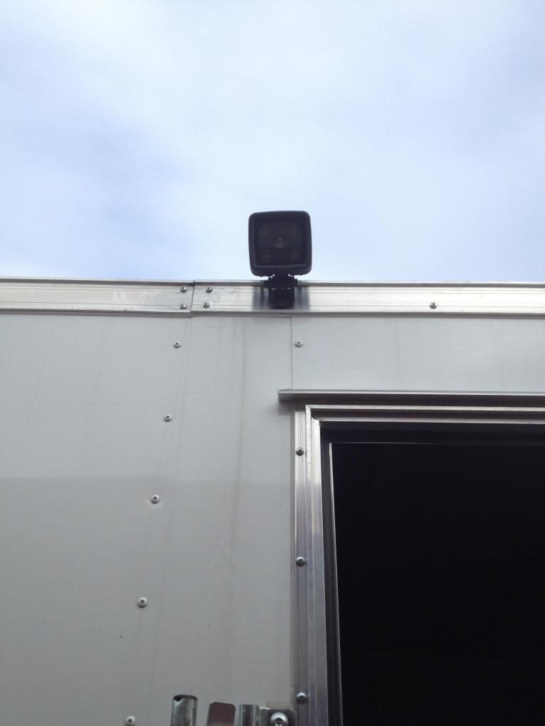

Postby 2500HHP » Mon Dec 01, 2014 5:33 pm
Another small update today. Finished the walls except for a 4' or so gap, but that's where the bathroom is going to be so it might work out fine! Ceiling insulation will be ready to pick up Wednesday. And started mounting exterior lighting. I'm going to use 4 of these (picture) 2 rear and 2 on curbside of trailer. The trim they're mounted through mounts to 1 1/2 x 1 angle iron in the trailer, so it makes for a perfect mounting point. Also started swapping all the park lights on the trailer to LED. Trailer was ordered with LED's but shipped with regular bulbs :thumbdown:

Postby Spotman » Mon Dec 01, 2014 5:41 pm
Please post more info on those lights on the back and curb side. make and model number would be good and where purchased.

Postby 2500HHP » Mon Dec 01, 2014 9:14 pm
Bob,
They are ABL 500 series lights. Link Below. I'm not sure where they were purchased from, when a manufacturing company I worked for change ownership, all loose assets were sold and their product was brought in. I was lucky to get my hands on these 4! They will not be cheap and what I paid will not be accurate. I heard they're in the ballpark of $200 each. 12v-24v, Class 1/ Div 1 etc etc. They are awesome but even Rigids would be a cheaper alternative!
http://www.abllights.com/products/accessories/service-lights/led-lights/abl-500-led-1200-reverse.html

Postby wtcreaux » Mon Dec 01, 2014 11:19 pm
Bob,
I have used Kawell on my truck and am trying these http://www.amazon.com/gp/product/B009ES3F0Q/ref=oh_aui_detailpage_o04_s00?ie=UTF8&psc=1 and these http://www.amazon.com/gp/product/B008XZAQDU/ref=oh_aui_detailpage_o03_s00?ie=UTF8&psc=1 on my trailer

Postby 2500HHP » Tue Dec 02, 2014 2:14 am
WT,
Those look pretty reasonable! I will admit, what I'm using is 200% overkill for what I'm using them for. The lights I'm using are designed to be run 24 hr on a 24v system on frac pumps and other stimulation equipment. But since they've been sitting in the tool box for a couple years, I'm going to put them to use!
Report back, let us know how your lights turn out, I have a 12v light addiction. You can never have enough light! :shrug:

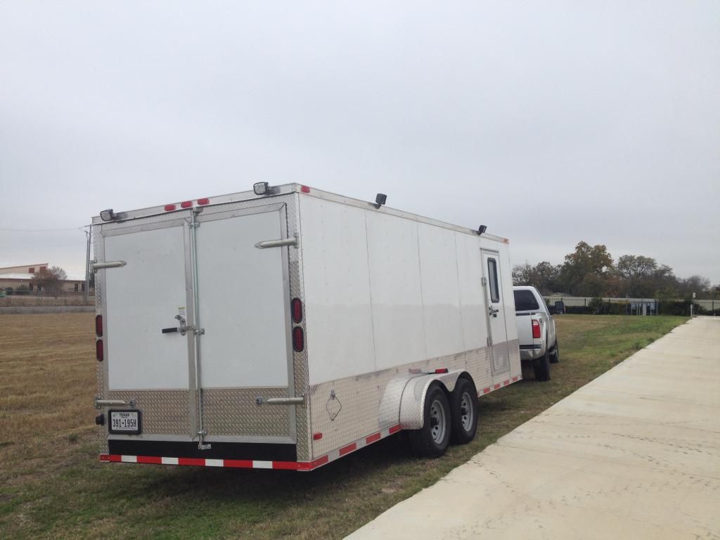

Postby 2500HHP » Wed Dec 03, 2014 8:28 pm
Got the ceiling insulated today, also finished adding exterior lights. I plan to put these on a relay to be back up lights as well as on a switch.

Postby lrrowe » Wed Dec 03, 2014 8:39 pm
I like the positioning of the lights. And if hooked to one switch, you sure could see what is outside when things go bump in the night. And boy is that a big trailer. Nice.

Postby 2500HHP » Wed Dec 03, 2014 8:52 pm
That is the plan Mr Bob! It's not really small, is it haha. Clowns the 8' bed F-350. Still can't feel it back there, yet!

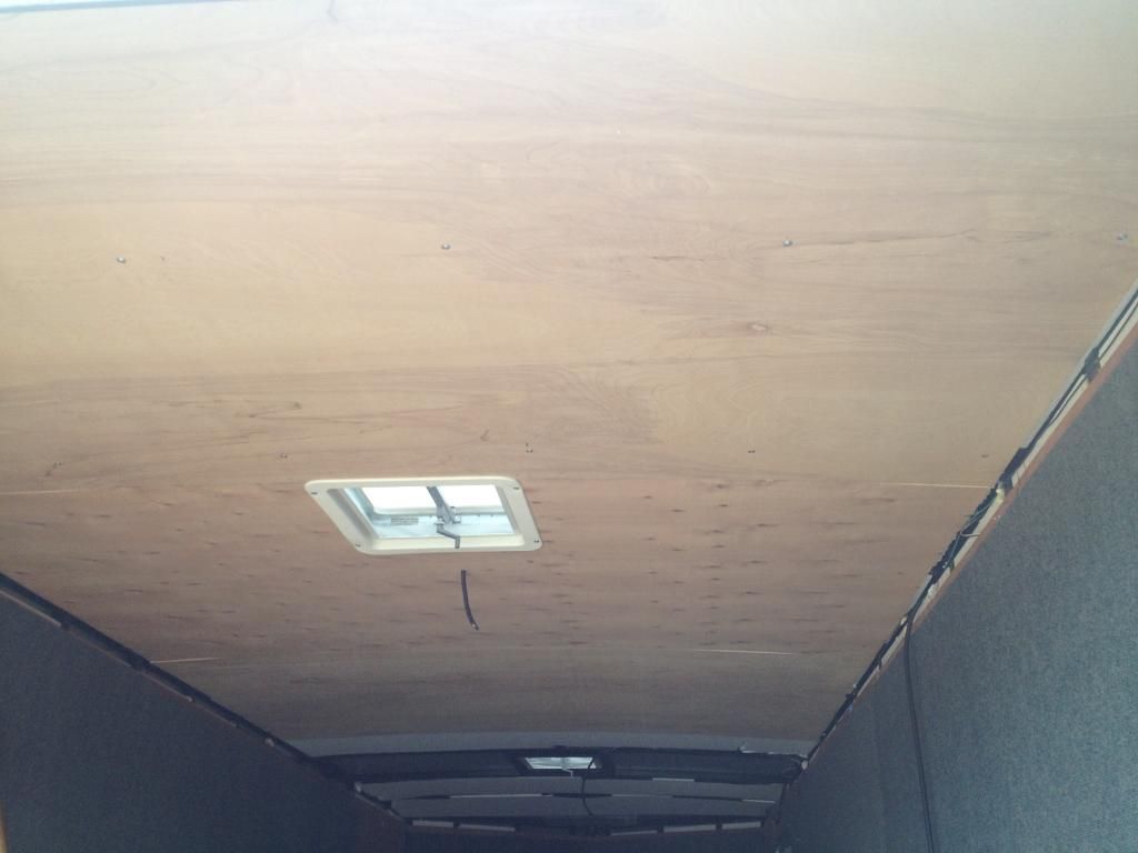

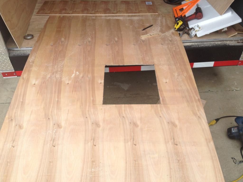

Postby 2500HHP » Thu Dec 04, 2014 6:03 pm
Progress report with some real progress! Ceiling insulation and ceiling panels will be done tomorrow! Cutting the hole for the vent when it's offset will seriously test your math skills!

Postby lrrowe » Thu Dec 04, 2014 7:05 pm
I like your plywood. What is it? And are you,using 1/4"?
Bob
lrrowe
Posts: 3285
Images: 439
Location: SW Virigina
Re: 7'x22' Diamond Cargo Conversion
Postby 2500HHP » Fri Dec 05, 2014 12:09 am
It's 1/8" backing board. $10.99 from home depot for a 4x8 sheet. so far its working great!
