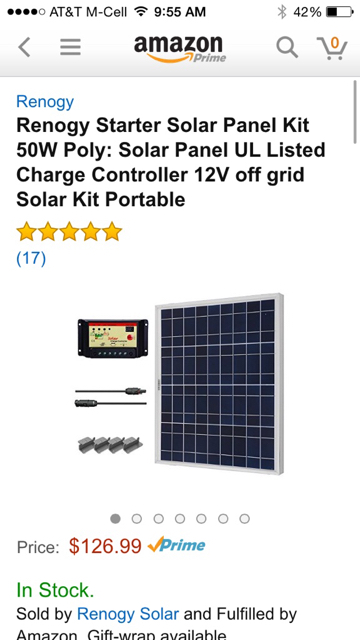

felixx wrote:small solar charger...
can you please quantify this?
Sorry I suck at math
A 50 watt panel at 12 volts will, in theory, give you 4 amps at 100% efficiency. Laid flat on the roof and accounting for the loss on a cheap charge controller, you can get 2.5 amps real easy. I tried it.
That's enough to keep your battery topped up forever for simple lighting.

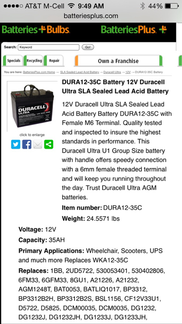

Postby abqlloyd » Sun Dec 14, 2014 11:51 am
This is a small SLA that requires no venting. You can leave it inside to charge. This is a name-brand good one. $70.
There's a guy here locally selling surplus UPS batteries, brand new, same spec, for $38.

Postby abqlloyd » Sun Dec 14, 2014 11:56 am
Basic solar. The 100w kit is about $150.
abqlloyd
Posts: 273
Joined: Mon Aug 08, 2005 11:47 pm
Re: battery powered lighting
Add some puck lights or just about any RV LED lights and you can light your cargo trailer indefinitely on solar.
