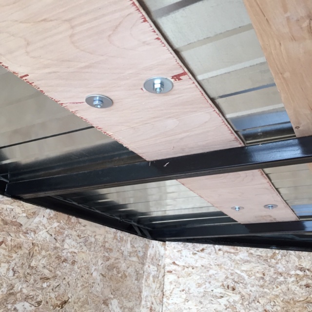

They run the luan across the roof down the middle only.
To keep the roof metal from rattling and wearing thin against the ribs/roof joists, since they don't want to dot the roof with holes for rivets or screws. It's just enough soft thickness to take the flop out.
I'm thinking of adding two more strips down each side for additional roof rigidity. Any pros or cons?
That will just stress the roof at the fasteners and/or seams. Spray foam into the gap instead if you are concerned about it and plan to put weight on the roof (like a person crawling around).

I added a couple of strips to give me some added strength for the solar panel mounts.
Don't plan on ever crawling on the roof. I made them 4" wide and they slid right in. Instead of drilling even more holes into the roof I just used construction adhesive at the roof cross members.

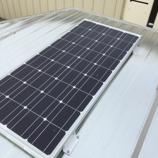

100w Renogy panel installed in front.
Underside mount.

100w solar panel installed.

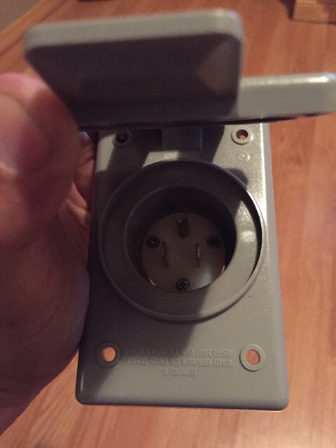

Amazon dropped off the power inlet for my AC power. I have a Honda EU2000. We seldom camp at developed sites.

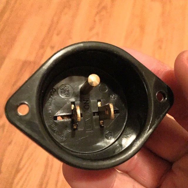

Also picked up this outlet for $7. I would rather use a round box as holes are easy and clean. I have a round weather box and if I can make it work the other goes back.
