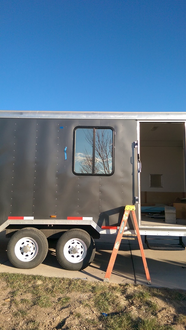

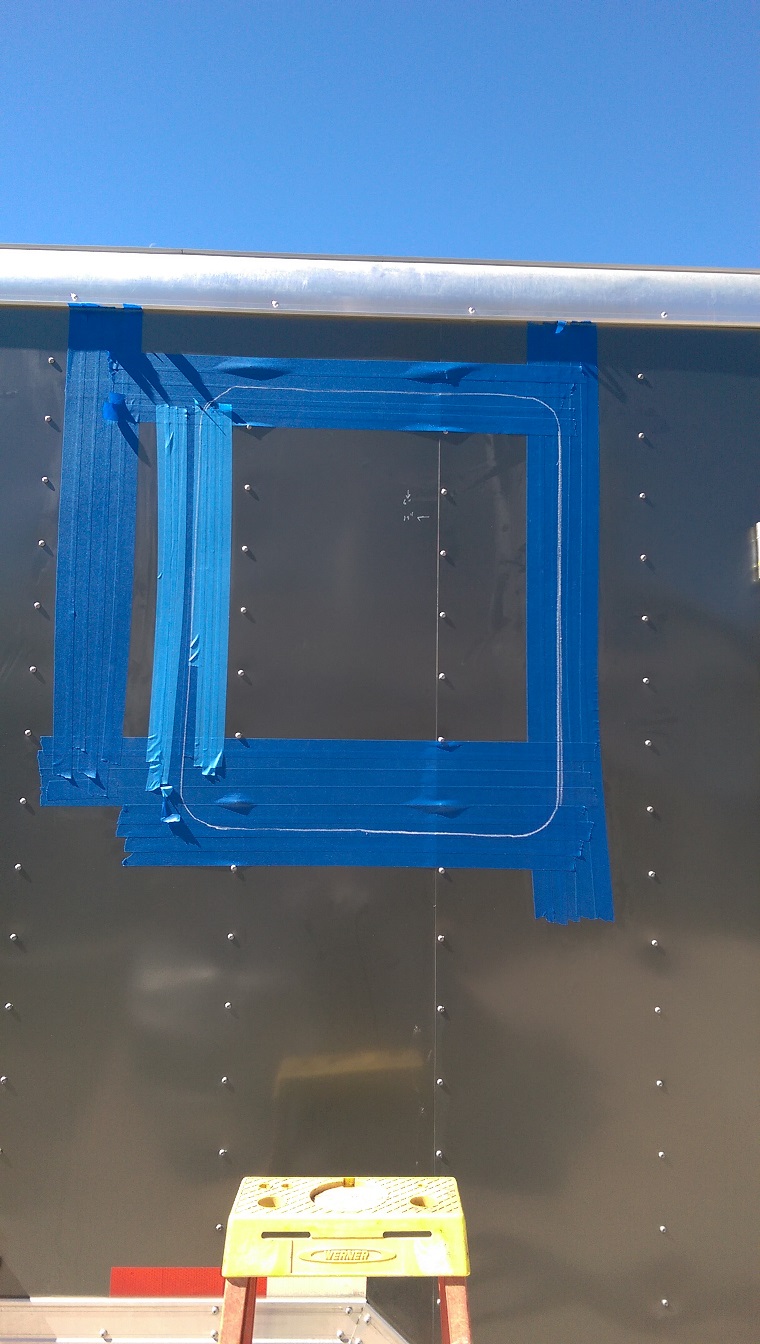

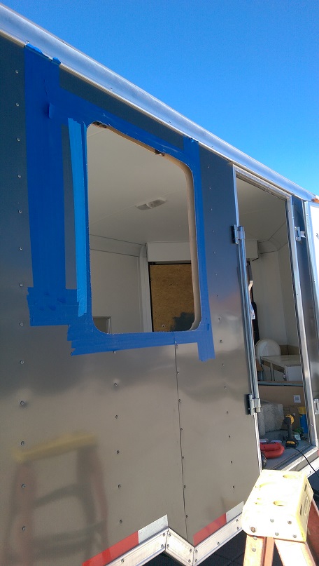

Postby Wookie97 » Sun Apr 03, 2016 10:22 pm
Well it"s been awhile since I have been able to work on my trailer project due to deployments and weather. This weekend the weather was nice and it was time to get back to work. First task was the Window install. I ordered a Kinro Window from Ebay, doesn't seem to be top quality but for the price and the project it will work for me. I will say that this was much more a pain in the @$$ than I originally thought it would be. Once I had it all measured our and the orientation set I layed out a large area of blue painters tape to trace my outline and to keep the Jig Saw from scratching the siding.
Once I had the outline where I wanted it was time to take the plunge and cut the hole out.
The cut-out was actually just about 1/8" smaller, which for me was ok and allowed me to slowly trim out the opening to fit the window without having to large of an opening and dealing with major gaps in the end.
I think it turned out pretty good. I used some butyl tape from Home Depot on the flange and I added some Clear Window Silicon just to be safe. Would much rather have a little extra and no leaks than not enough.

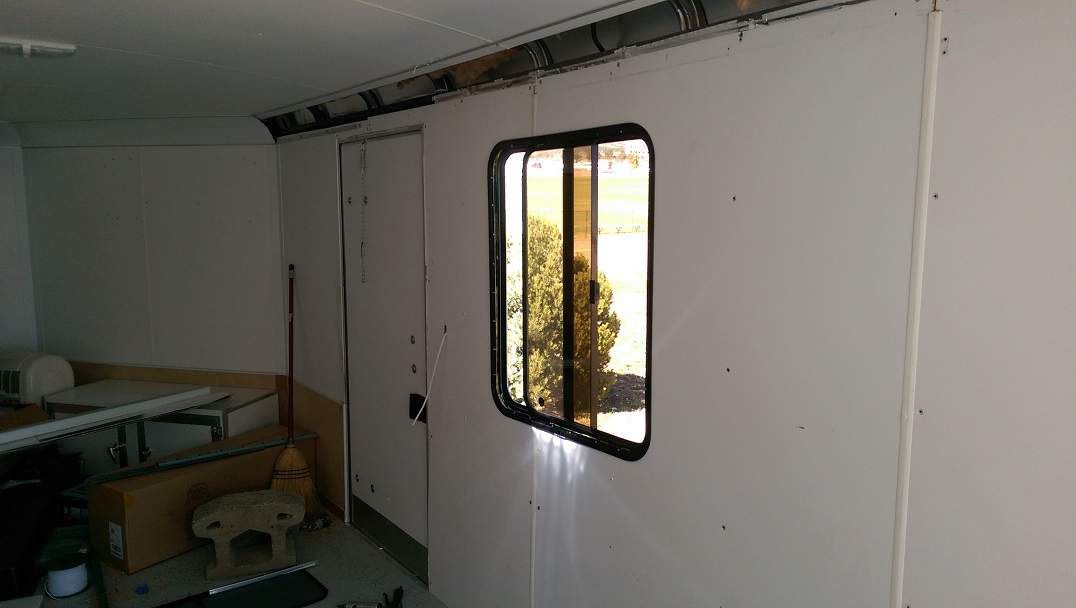

Postby Wookie97 » Sun Apr 03, 2016 10:29 pm
I guess we can only add three pics at a time. This is how the window looks on the inside. You can see there is about a 1/4" gap between the trim ring and the window frame. Right now everything is holding tight and placed well. I have an idea of using some aluminum C-Channel from Home Depot to fill the gaps. I tried a small piece and it will work out real well to seal up the gaps.
