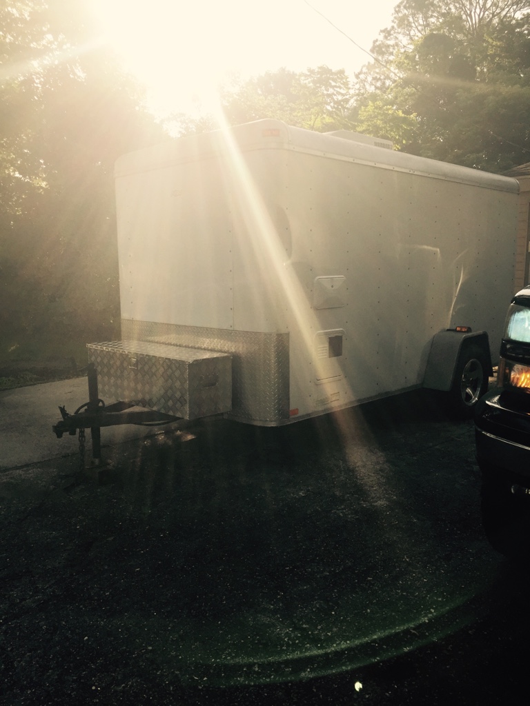

Postby gisclair615 » Fri May 22, 2015 2:54 pm
Finally installed the tongue box. Now time to figure out how to secure my battery and propane tank inside of it.
