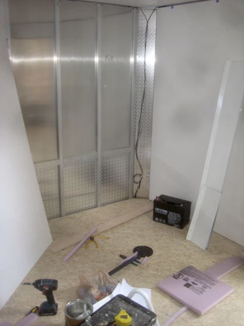

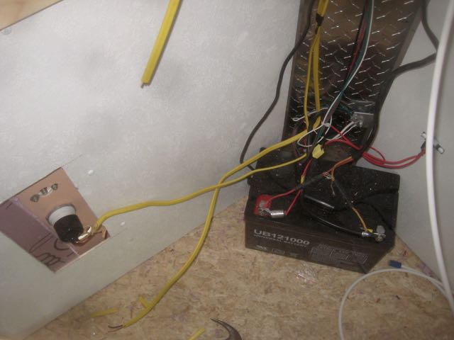

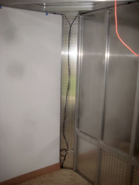

I managed to get off some of the interior skin to see what was underneath and how the wiring was done as I'd have to tap into it. Since the ProLine Company only put minimal screws into the interior skin as I requested, the panels came off pretty easily. I'm glad to see they are actually plywood not fiberboard. I guess I'll be able to leave them as they are. The wiring from the tongue to the lights (interior and exterior) and ceiling fan looks straightforward and easily tapped. There is a channel at the top edges of the ceiling where they run with room for more.
Wiring from the V nose up and over. Easily tapped.

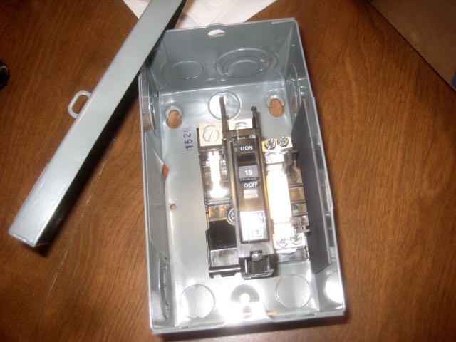

small two 15 amp breaker box. one breaker for heater, other for microwave and battery charger.
134883 8 sheets of 1" R5 insulation. For heat but also to keep heat out.
My plan is to have two circuits. One for 110 Volts for the heater and the other 110 volts to power other appliances and generate 12 volts. The first 110 volt circuit will have an outside plug to tap into the campgrounds 15 amp circuit. I have a circuit breaker box with two 15 amp breakers in it. This breaker will only run the baseboard heater (I'll rarely ever actually plug this into the campground) I've purchased a baseboard heater and thermostat. But the heater is 110 volts instead of 240 volts. It's 500 watts so it should easily do the job.
The other circuit will also have a 15 amp from an outside plug to tap into the campground's power. Who two cords and two separate circuits you ask? Well, I've never seen a campground that has power to not have multiple 15 amp sockets. I've been to some that don't have a 30 amp one though. Yes, I'll have two outside connections on the trailer, but one is just for the heater. It may hardly ever be used. Anyway, moving on. The second 15 amp circuit will be for the meager counter that will have a small microwave and coffeepot. the circuit will also power the battery charger.
In my old camper... Little guy teardrop... I only had 12 volts. The battery did a good job and if plugged in the charger easily kept up with the power I was using. I also had a small inverter to convert to 110 volts for my laptop. It worked well, but if I didn't have power for the charger it sopped up enough energy that it drained the battery in a few hours. This time no 110 volts converted from the battery... no inverter. Mine used to send out a whistle when the battery voltage dropped below a certain threshold. I hated it. This time around all is from the battery or a battery that is charging.
My charger is one of those green boat battery chargers from the sports stores. It will charge two batteries at once and is compact and works really well. I've had it for a long time. So, the battery will run

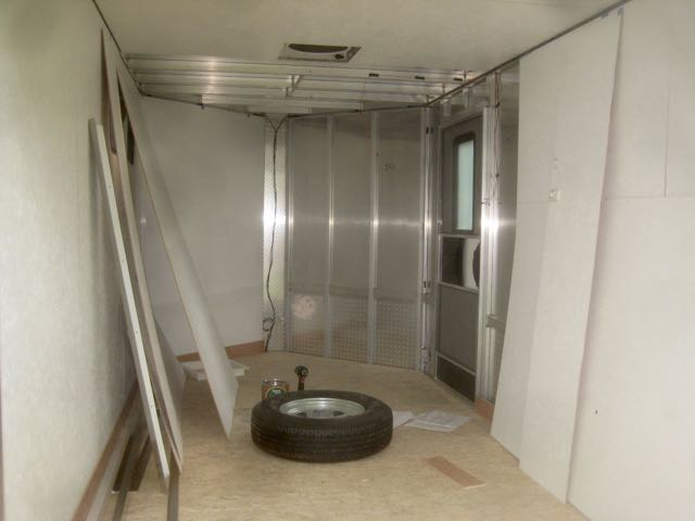

Insulation almost in
Postby deceiver » Fri Aug 07, 2015 2:24 pm

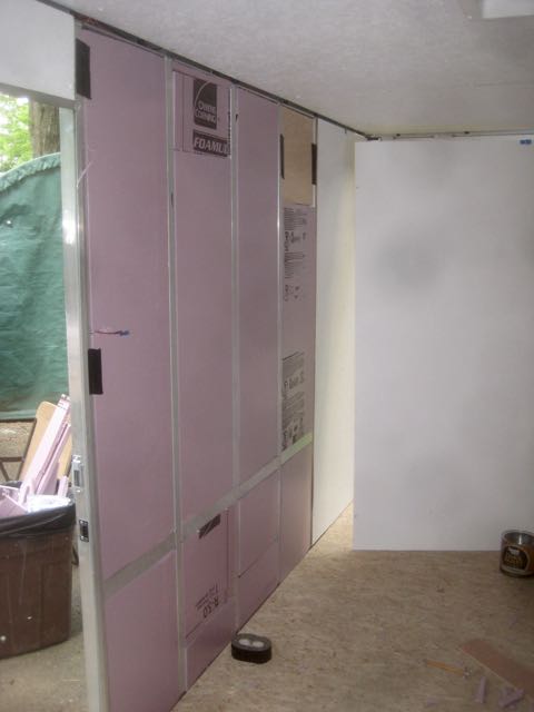

Today I nearly finished insulating. I'm short one sheet. Right now, barring waste and scraps, there are eight 4x8 sheets in this trailer in walls and ceiling. In a few places I will put plywood. One instance shown below is where the mount for the Naxa TV will be on the upper wall at the foot of the bed. The battery came in today. It will be mounted on the floor in the V nose where cabinetry will be. I will be building a base enclosure for it but will also build a second one above it (battery bunkbeds) in case I should decide to add a second battery. Tapping the main cable will be easy as it's right in the nose. I'll be needing some hefty cable as the battery switch will be in the upper cabinets along with the charger and circuit breakers. I've ordered #4 cable but that's overkill as I'll be running a tv, led lights, and fan. The main 12V wire running through the trailer looks like #12 or #10. All parts aren't in yet so I guess I'll start framing up the platform bed/drawers unit in the shop tomorrow.
Battery and the V wall where the power inlets will be
Some of the insulation

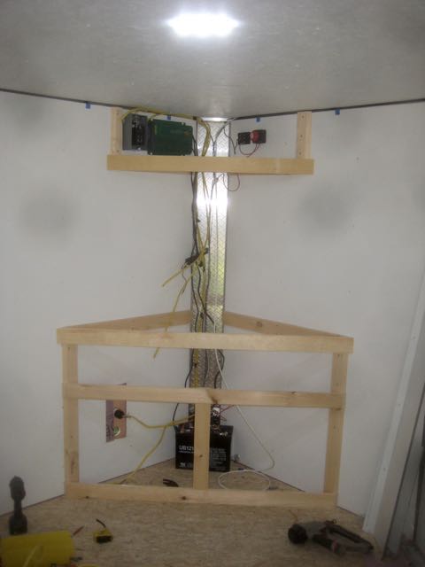

The past couple of days I've managed to finish the insulating and I've gotten in most of the electrics

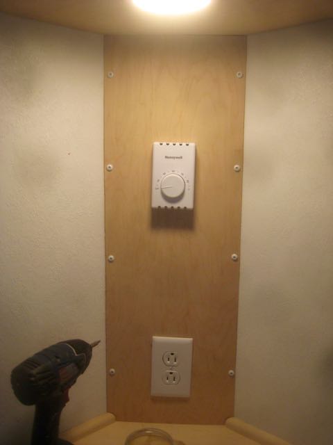

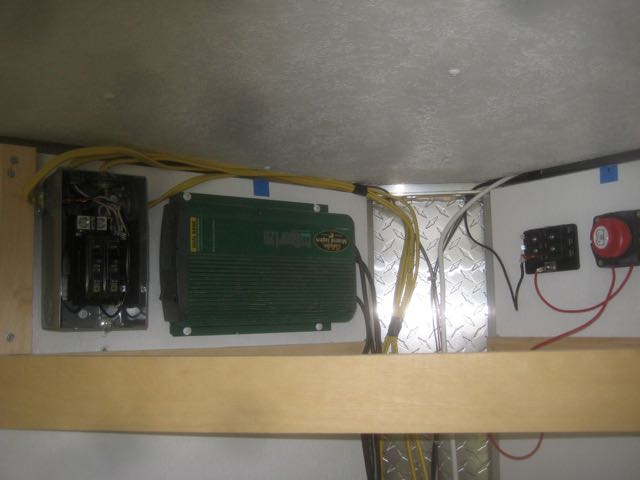

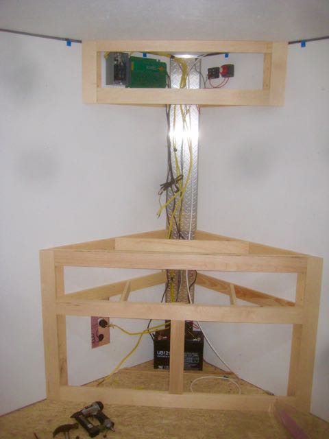

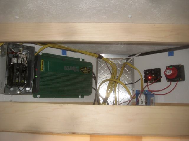

The next pictures mostly show the electric setup. I have 110 volts only for a plug that will be on the front counter, to run a 110 volt 500 watt baseboard heater, and to run the battery charger. All the rest of the electrics are 12 volts. Fan, lights, TV, ipad charger, etc. I've found from my 18,000 miles on the road with a teardrop that when we stop at a campground, and we like to frequent public municipal, state, and national parks, we almost never are without at least a 15 amp hookup. So, we either run off the battery or plug in and charge as we use it. I'm done with inverters.
In the picture with the closeup, on the left is a breaker box with two 15 amp 110 volt breakers. Next to it is my old reliable Cabella 20 amp battery charger. To the right is a 12 volt fuse box and the red thing next to it is a battery cutoff switch. The large white cable is coax to the TV. The bottom picture shows the beginning of the cabinetry. The top will be a small two door cabinet that will open the the electrics. The bottom will be a countertop with a top drawer and two cabinet doors below that. Here it is framed in. The facing will be maple.
I had two outside plugs, one for the heater circuit and another for everything else but one came through with a broken lug and is being sent back. Of the three exterior plugs the top one is for the coax.
Battery and 110 volt connections
Closeup of electrics

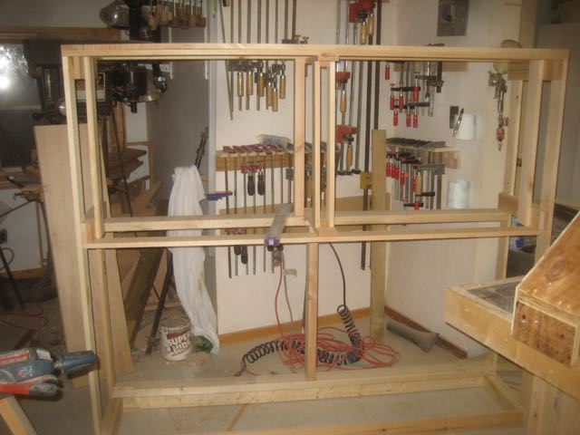

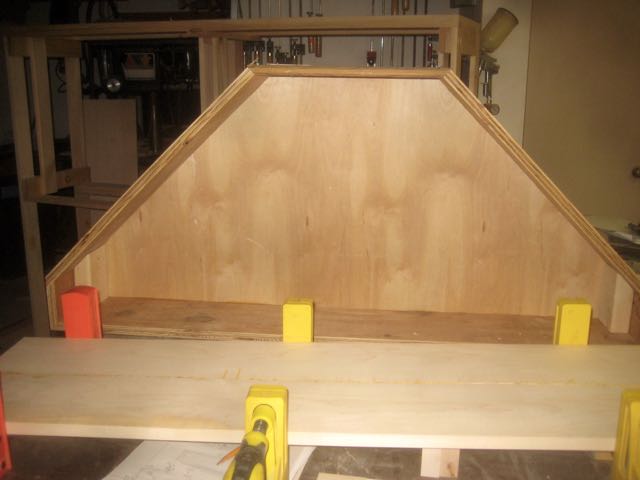

The front cabinetry is framed up and has the maple facing on it awaiting the doors, countertop, and drawer. The drawer poses it's own challenges as it's triangular shaped so will have drawer slides on the bottom instead of the sides. The counter will have a large drawer at the top (see it's profile on my bench), Two large cabinet doors on the bottom, and two small doors for the top cabinet. The countertop will also be maple. I chose maple because it works nicely with nice sharp edges and won't clash with the light rest of the camper interior.
I also have the bed framed up. Here it's on it's side to make room in my shop. It will have two large personal clothes drawer (two bottom squares) for my wife and I, and the back half will be accessible from the rear cargo doors of the trailer to carry the outdoor rug, folding chairs and for now the spare until I can figure what else to do with it. The tongue is short and not a good place to mount it. I'm working up plans to mount it beneath the rear of the trailer. Since the trailer is all Aluminum I need to be mindful of any electrolytic oxidation by using any other metal into contact with it. The bed will also be faced in maple and will look a lot like a platform bed. I already have an 8" miracle foam mattress that we kept from our previous trailer.
The Bed fits across the camper nicely as the interior is about six and a half feet across. The wall at the foot of the bed will have the LED tv.

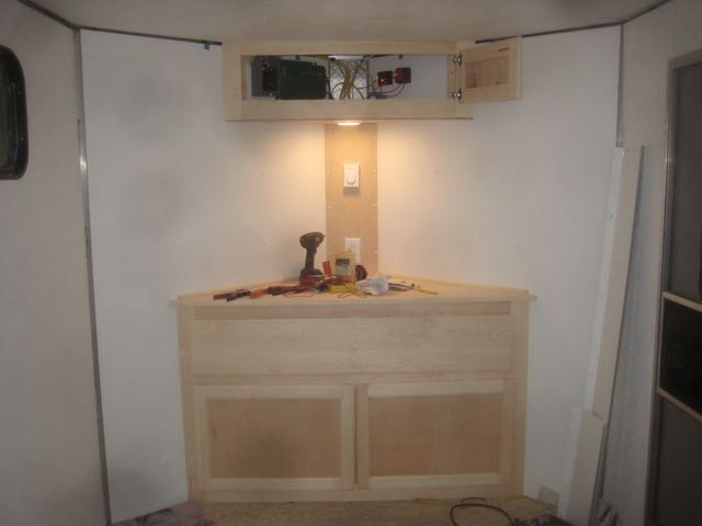

The front counter is pretty much finished. The pictures show how it looks, with lots of building junk on it. The upper left door isn't on as I bought one set of hinges the wrong size. Got to exchange them for new ones. Above the wiring is complete. Two 110 volt 15 amp breakers. One for the baseboard heater, the other for the battery charger and counter plug (microwave, coffee pot, etc). The back has a plug for those and the thermostat for the heater. No picture of it but I've got the platform bed finished with drawers. It's made of maple along the same lines as the counter.
Remember, after the teardrop I had, I'm into camping. A bed, light, maybe heat, and being able to stand up to put my pants on. After that I'd rather be outside with the fire.
breakers, charger, 12 volt fuses, battery switch
Counter top pretty much completed, poly comes next then on to installing the platform bed
Rear of counter with plugs and thermostat
