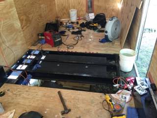

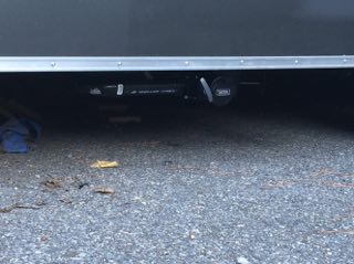

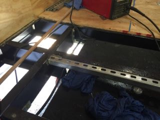

Postby badfish » Wed Sep 16, 2015 7:46 am

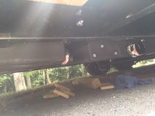

I had to split and reinforce two of the floor joust in the trailer. I also stayed away from the seams in the floor when I did and as close to the axles as I could stay.

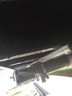

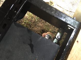

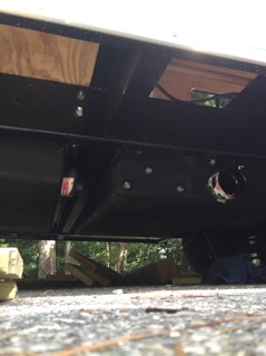

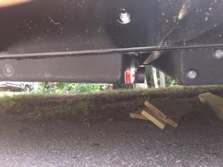

Re: 8x24 toy hauler build
Postby badfish » Wed Sep 16, 2015 7:50 am

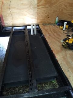

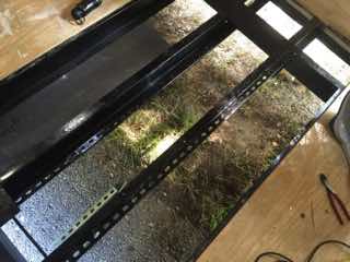

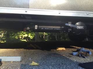

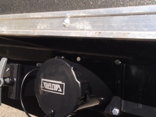

The floor is 16" centers 6" tall so my tanks are 30" wide and 9" deep. I only lost 4" of ground clearance.

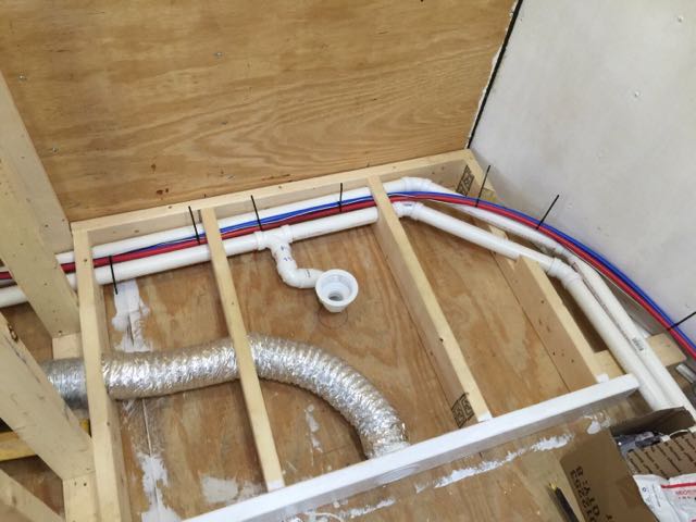

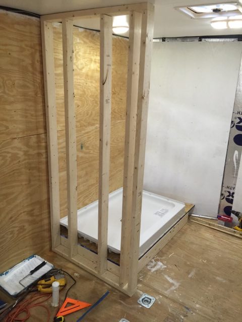

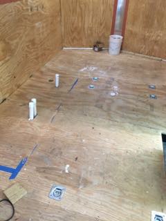

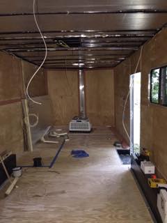

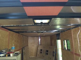

Postby badfish » Mon Oct 05, 2015 4:24 pm
Started working on the shower. The pan and plywood are just sitting there. I need to run the water lines for the sink and drains through the platform.
Postby badfish » Sun Oct 18, 2015 1:47 pm
Got a little more done. Hope I can get the pan done today.

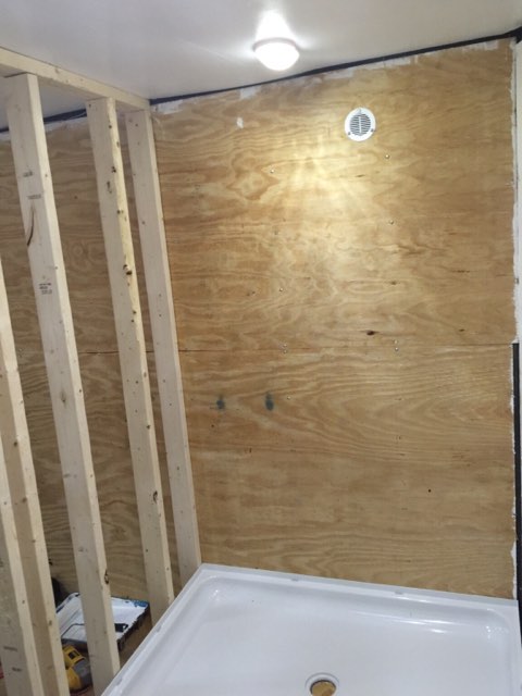

Postby badfish » Sun Oct 18, 2015 1:51 pm
I painted the plywood that may be exposed to moisture in the bathroom. Til I can decide what I'm going to do with the walls.
