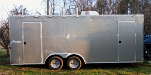

Picked up my trailer friday.
really liking the 2 RV doors
dealer installed spare tire mount.

Postby flboy » Sun Mar 06, 2016 6:57 am
Very nice. Now the fun can start! Enjoy.

Postby chiefairwrench » Sun Mar 06, 2016 7:03 am
Wow that looks awesome and alot of room :shock:

Postby Maximus » Sun Mar 06, 2016 10:35 am
That's ginormous. Curious...What is your TV ??
You have a lot of work on your hands. I just started tearing into my trailer over the weekend. Getting ready for windows and insulation. I made a list of parts I need. That's a big list and it keeps growing. Yours must be a really big list. Good luck. keep the pics coming.

Postby Wolfscout » Mon Mar 07, 2016 1:04 pm
My TV is either '91 Ford Explorer or if it's heaver I use the Wife's Toyota Tacoma . The tacoma has a max of 6500. Explorer is 5000.
Either one we probably won't be at the limit of either vehicle.
Luckily I have been buying up parts and filling my lists for about 2 years. The only thing I don't have is the toilet and I might not even put one in as the portapotty serves us well enough.
