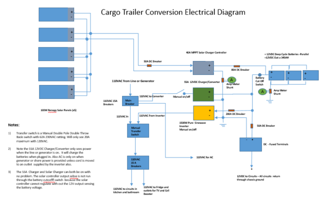

You are correct. I had this same schematic for my previous toy hauler that used 2 12V is Parallel for more capacity. Tx. (Edit... updated schematic.. going with 3 12v in Parallel)KCStudly wrote:I think you meant to label the batteries in "series", as shown for two 6v cells in a 12v system, not "parallel".

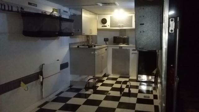

BTW, thanks for the confirmation on the window AC being more then enough to cool your last and this new build. Have you decided where your going to install the AC in this build? We got similar uses for our conversion builds.
I haul a full dresser 2011 Harley Roadking to events as well as two 4wheelers several times a year to ATV parks. I rode Enduro & dual sports for years prior. I'll have to keep a watch on your build here.
Martin
