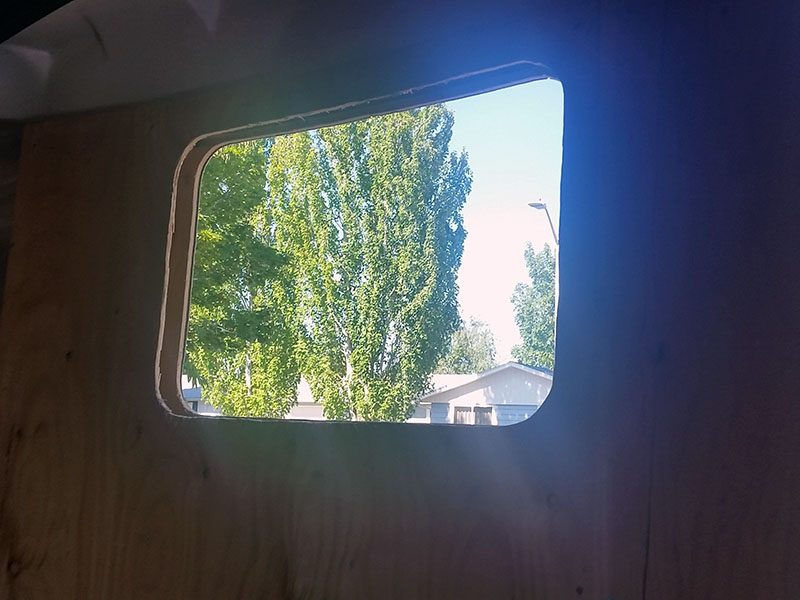

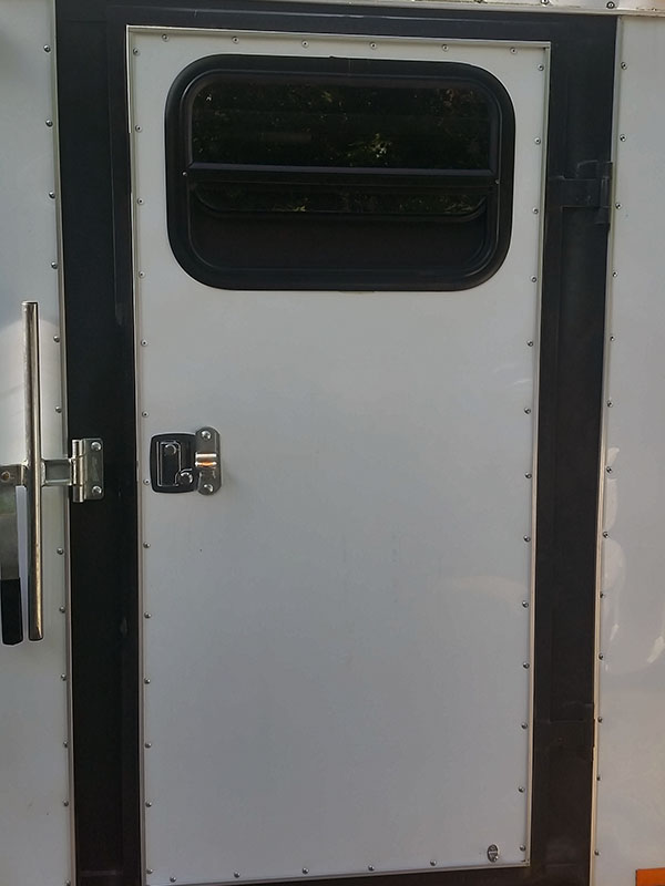

Thanks for the pep talk McDave. First one is looking better the more I tweak it, just psyched myself out.

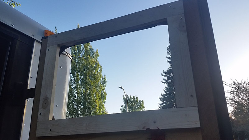

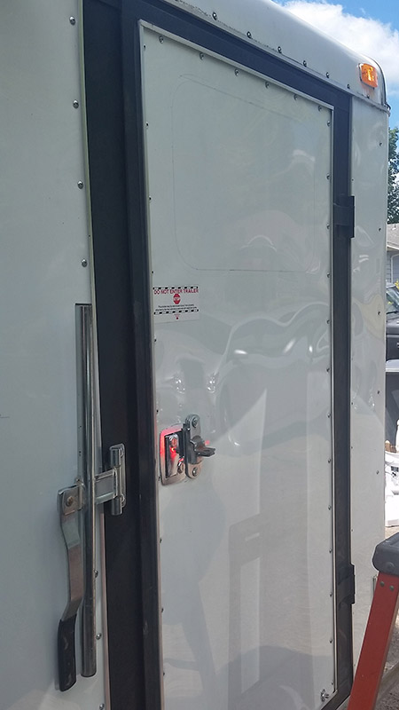

Drew an outline on the door after marking the top - measured from the door, lining up the trim ring and using it as a rough guide. I then took my calipers and locked them down and used it to trace around the initial drawing to make a bigger hole layout. Calipers are great for doing this, both points are sharp.
Don't know if I snagged any pictures of the hole before adding the inside wood and welding in the frame. My welding gun fit inside between the walls to weld the tube steel easily.
After mounting those 4 pieces of wood I took the jig saw and cut it to the same size as the hole, to act as a shim for the window and trim ring.
The finished product, after quickly patching the hole I burned through the skin. I will be filling and sanding and blending it in but it is functional and not ugly now. You can probably find it, but might not have noticed it if not told it existed
I still need to take the window out again, now that I know it lines up good I can touch up the paint I scratched and then use the butyl tape and finish it with a bead of silicone.

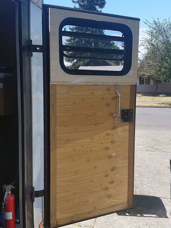

Postby Mark959 » Fri Jul 15, 2016 4:17 pm

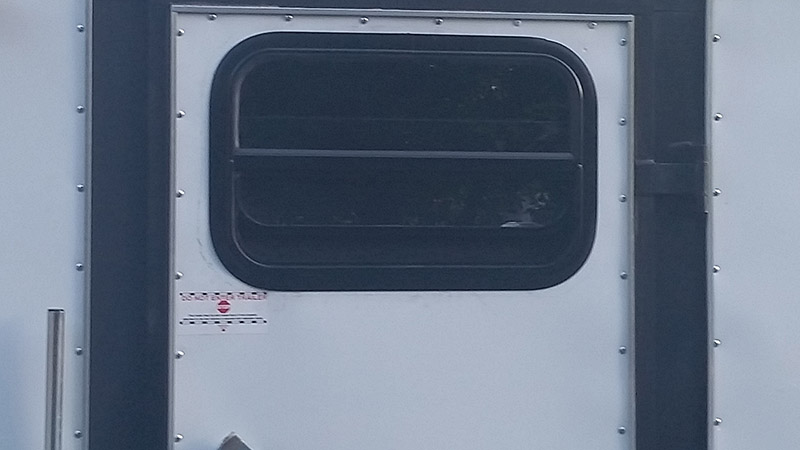

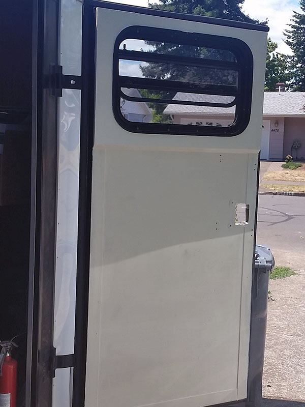

Finished the window and painted the door inside and out. Need to go around the inside of that aluminum, it isn't sealed so rain runs through at the bottom, when I had the holes cut I could see daylight easily. Just going to silicone the whole thing.
Also redid the wood "spacer". Didn't like the look of my frame. Pics continued on next post

Postby Mark959 » Fri Jul 15, 2016 5:06 pm
Ran butyl tape along the whole window, overlapped at the ends. Going to run a bead of caulk around the outside probably, just in case.
I used my table saw set at a 45º to cut a bevel on the bottom of the 3/4" sanded plywood for a nice transition. Real size was roughly .7", honestly I could of used some thinner - 19/32 at a minimum but then I think the ring would hit the window. I wanted to make sure there was a small gap so I could get a good clamping action. I will run a bead of black dap around the gap to seal it up. Caulked the ring and where the bevel meets the original wood sheeting.
I also didn't like how the window barely opens when opened and locked into position. I could manually move it up another inch and a half but it fell back down into the "catches", there are holes on the sides of the frame for the window to catch. So I took my calipers and auto-punch and marked both sides for the catch-pins around 1/4" below where they would be at when the window is opened at its limit. Then I matched the drill bit to the pre-existing hole size and used a smaller bit to start the hole from the outside, then ran the big bit from inside the window. Worked perfectly and now I can have it closed and barely open which is stock, or very open. The picture shows where it sits after I modified it, before it would sit halfway between where it is and closed. Ridiculous if you ask me, but it wasn't that hard to fix either.
Finished it with some paint & primer AIO, I may sand over some spots where I filled in roughly. We will see. Much happier now. The walls are thicker than the door, I believe 1/4" sheeting should be more than enough to do something similar for the front and side window.

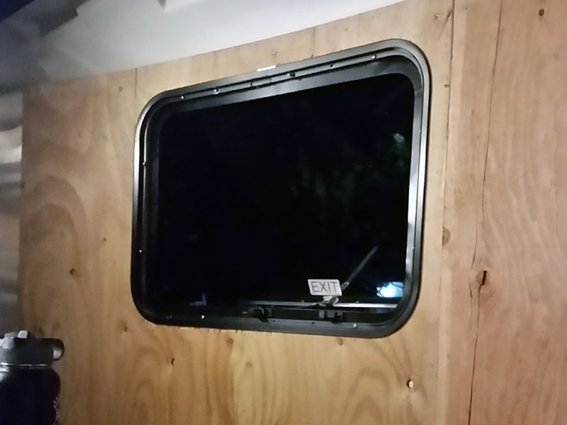

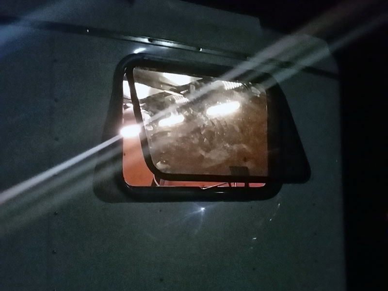

Got the window in and done. I shimmed the sides up a quarter of an inch, ran one full ring of butyl tape on the window and then another layer around the sides just in case. Just need to caulk the window and it will be perfect.
The inside is a little bit of a nightmare, the trim ring isn't perfectly shaped, so I can't square it up or it looks worse. Curtains will hide the top and I may put a small sill on the bottom. The sides are ok. There is a huge gap between the window frame and ring, not sure how I will fill that in.
Since it is an emergency exit too, I made sure the wall can support weight. I framed it much like a home window.
But the breeze that came through is amazing :thumbsup:

Postby Mark959 » Sun Jul 31, 2016 2:36 pm
Front window worked out better than expected. Waited for the 100º heat to hit it and then tightened all the screws patiently. Pulled it in real tight, no gap at all around the outside, inside most of the ring rolled in to remove the gap, doesn't look bad. Just wish the ring was truly square

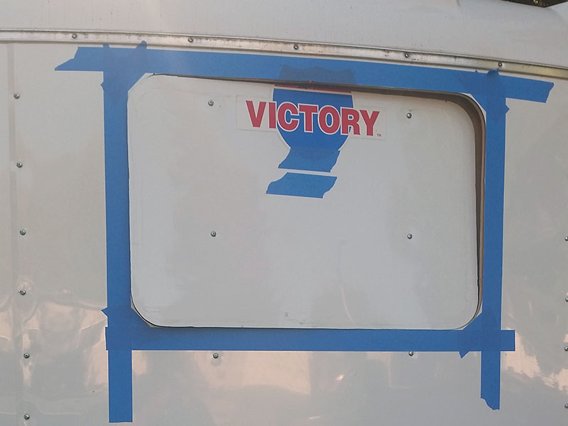

Once you have the general layout, tape it off so that the foot of the jigsaw doesn't ruin your paint. 2" masking tape should be perfect. Honestly I drew on the trailer skin - using the window frame for measurements and adding an 1/8" all around. I used the trim ring when drawing to estimate the rounded edges - just make sure it is close to the same as on the window frame. Then I taped it all off by making a box on the outside of my lines, and a diagonal in each corner to get "close enough" to the rounded edges. The frame I used has a 1" lip to hide anything else so it didn't need to be a perfect tape job at the rounded corners.
I then drilled a big hole and went to town with my jigsaw, start at the top middle and go around to finish at the top. That is how I did it, if you start at the bottom it might flop over and bend the skin up when you finish. The radius is so slow that it shouldn't be a problem, I powered it out in only a few minutes. Take a deep breath, see if the window fits. If it is too tight you have options - tin snips, cut off wheels (remember this is aluminum, I prefer the disposable quick-swap dremel blades), maybe even a pass with the jigsaw again. If it fits, hooray! If you cut too much off (measure!) it isn't the end of the world. You can buy this aluminum skin sheeting, or just buy aluminum plate from almost any hardware store and drill then rivet/screw it down, coating underneath and all holes with your choice - silicone for instance...
That is where I pull the inner walls off to frame it up. The trim ring and the window frame sandwich the walls, so you *could* probably just shove 2X material between the walls, screw it down to the wall and slam it in. But I didn't want to take that risk especially since the front window is an emergency exit window. After I framed it up I jumped all over it without any give. As for the door, everyone here slams doors so I welded up square steel tubing that matched what the trailer manufacturer used.
