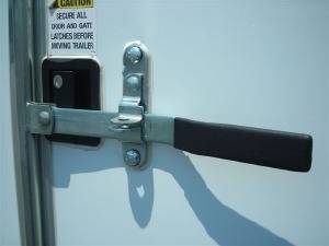

this is the same type of latch i have and this where i would like to mount it

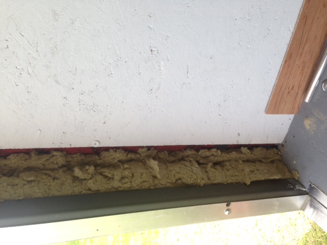

finished insulating the rear bulkhead using roxul instead of the foil backed foam insulation that i used on the walls and ceililng. it doesn't absorb moisture, is fire resistant, works great as sound proofing, isn't itchy like fiberglass insulation and easily removed to access trailer wiring. i still need to insulate the barn door and install the rv latch but that will require removing the door and stripping it down. i haven't found much info on latch installs so i'll post up pics when i do mine.

Never heard of Roxul. Just checked it out, interesting stuff. Stone and wool.
I look forward to any tips on your lock install. When I picked mine up from the trailer dealer, I was in such a rush adding accessory trailer stuff to my pile of goodies that I failed to realize my lock has no other hardware, and only has one plate screw. Looks like I will be ordering up a new lock on line, that should have all the parts. And maybe some templates........

I used Roxul on my trailer. Very quiet and warm on the inside.

I am pretty sure I have only seen Roxsul installed while wearing a full Tyvek protective suit,it is incredibly bad on skin and when inhaled?
I am doing a big house in Maine right now and everyone in the trades feels it is the worst material to work with that is sold.
It is good sound barrier but NASTY!

i used roxul when i renovated my house and found no issues at all with it, no irritation at all. pink fiber glass is much worse.
from msds sheets:
Potential Health Effects:
Inhalation: Temporary mechanical irritation of the upper respiratory tract (scratchy throat, coughing, congestion) may result from exposures to dusts and fibers in excess of applicable exposure limits.
Skin Contact: Dusts and fibers may cause temporary mechanical irritation (itching) or redness to the skin.
Eye Contact: Dusts and fibers may cause temporary mechanical irritation (itching) or redness to the eyes.
Ingestion: Ingestion of this product is unlikely and not intended under normal conditions of use. Ingestion of this product may cause gastrointestinal irritation.
Existing Medical Conditions: Pre-existing chronic eye, skin and respiratory conditions may temporarily worsen due to exposure to dusts and fibers.
