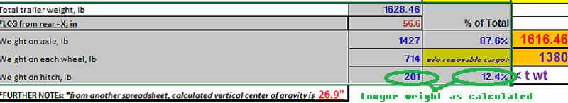

I agree, in part, with you all. My TV is a '04 2500 HD regular cab Chevy pickup, with 300+ lbs of gear in the cross-bed box, and a crane mast at the rear of the bed. When camping, I load in extra jacks, 10-12 gallons of gas in gas jugs, a 60-75 lb extra cooler, and sundry other items in the bed of the truck (usually separated by heavy wood "compartmentalizing" 2x8 lumber. I estimate the curb weight at 6000+ lbs. I don't think the 1700 lb. trailer is going to lift the rear wheels at any time. I addressed weight shifting by securing my loads, in truck and trailer, so everything should remain stable. Since my TTT is a single beam trailer, I used a 3"x3"x.1875"x72" tube to weld to three crossmembers, and to a spine running all the way to the trailer rear (I won't break the tongue). Its' already survived both TV and TTT being launched into the air by a giant pothole; the truck suffered busted tire belts, but the trailer just flew over it all. My trailer weight bias has been shifted forward over the years; at present, I can't lift it without killing my back. The last calculated balance sheet I did, at 1628 lbs (I've since added more-forward- weight, about 75lbs., in structure and content), showed 201 lbs tongue weight/12.4% when loaded for travel. I'm only using one spring bar, so I'm not putting so much downforce on the trailer tongue, but as I was trying to convey, enough downforce to even out any see-sawing over bumps, and to ensure that the coupler has "incentive" to stay "on the ball". I don't need it, but I trust it, and I think it makes the trailer travel better.

working on it wrote: I'm only using one spring bar, so I'm not putting so much downforce on the trailer tongue, but as I was trying to convey, enough downforce to even out any see-sawing over bumps, and to ensure that the coupler has "incentive" to stay "on the ball". I don't need it, but I trust it, and I think it makes the trailer travel better.
The rule of thumb I read said that WDs were recommended when the Trailer was over 50% of the weight of the TV. In your case, with a heavy truck and a light trailer, its unlikely that you would have a problem with lifting the truck, but that might not be true for someone with a front wheel drive car and an empty trunk. I'm not suggesting that you change it, but others that read this thread should understand that your solution might be a mistake with a different vehicle. The weight shifting I'm talking about is when you are going up or down hills or over a rise. The tongue weight will increase if you lower the tongue ( as in going down hill) and the tongue weight will drop if you raise the tongue ( as in going uphill).
