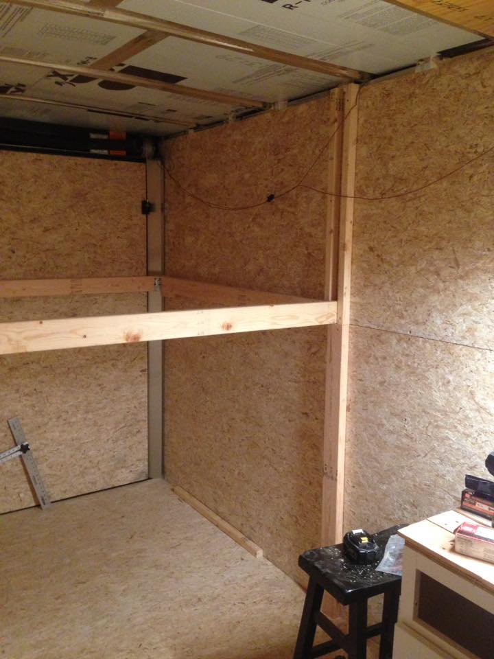

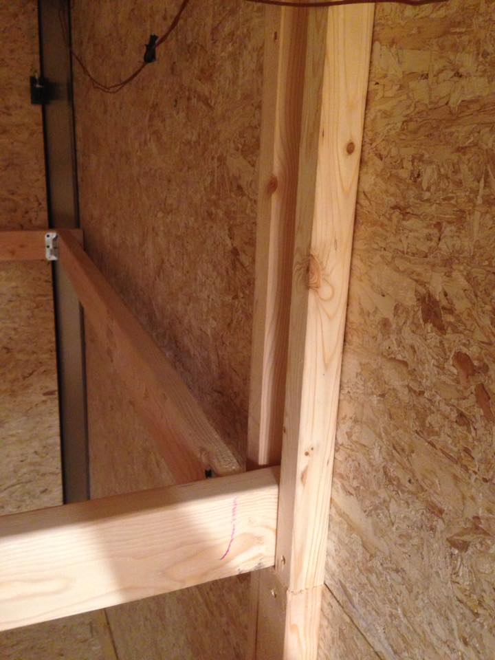

Well after messing around with it for a bit this is what I came up with. Most of it is just set in place, checking clearances etc. I left plenty of space between the 2x2's so it shouldn't bind or anything. It should allow me to raise it if needed although it might not be very easy until I come up with a pulley system.

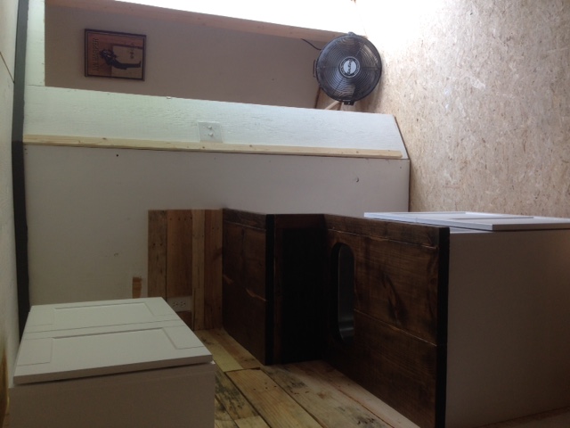

Well progress has slowed down to a halt lately, Mainly due to funding but also a bit of second guessing myself. I had planned on having the A/C in by now but I had to divert funds to repair my daily. In the meantime I have been working on finishing the kitchen area which is a pretty crucial step for me. Unfortunately I still have quite a bit to do...

Not too sure why that photo came out sideways as soon as I uploaded it..

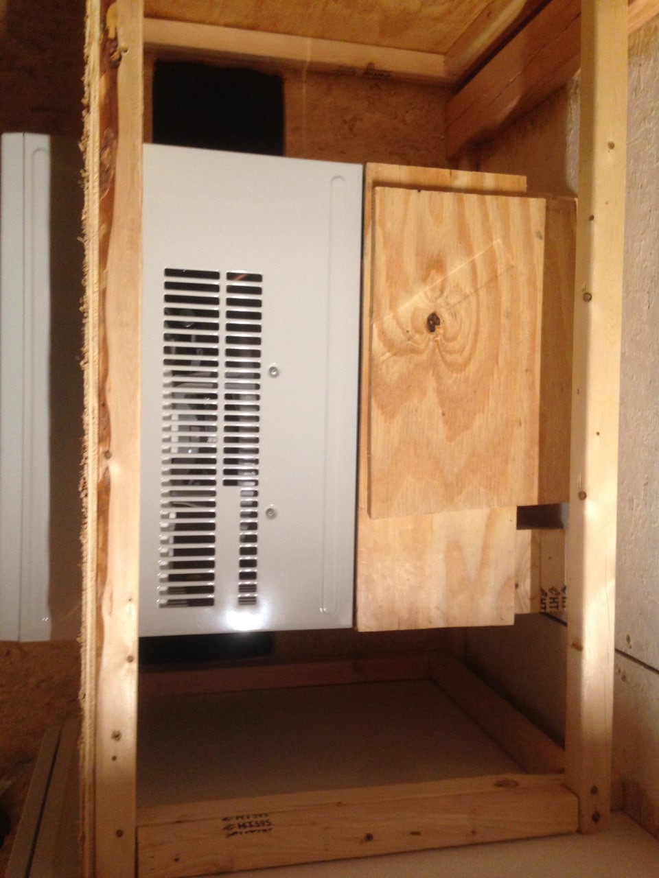

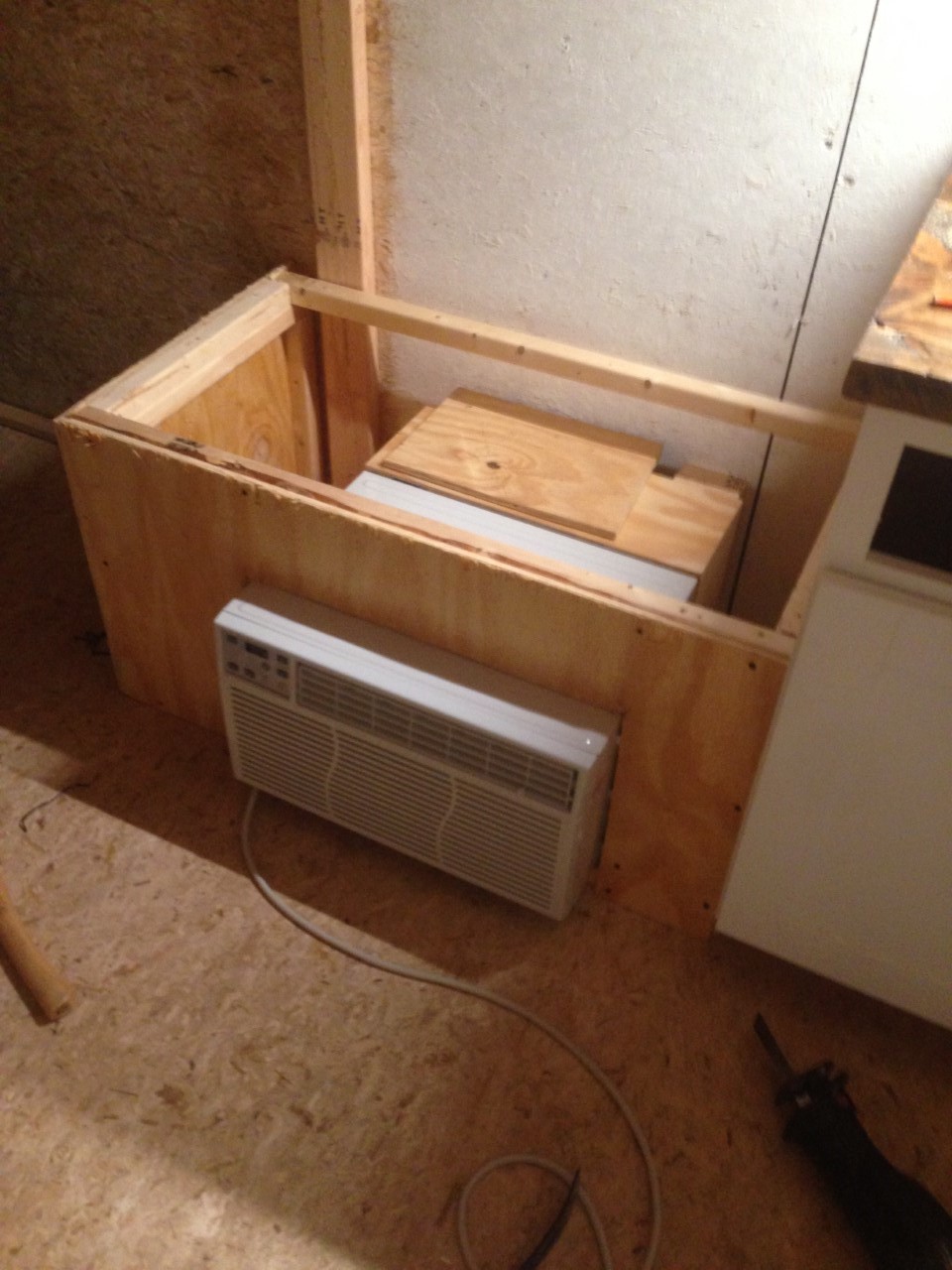

I got the A/C in (8k unit). Seems to be doing pretty well, in the hottest part of the day it's pretty pleasant in here. Still need to finish it up a bit with insulating inside the box and putting the top on as well as vent covers. I copied this idea from a blog.

So I've been running the unit today, admittedly for the longest I have yet. There is one downside to this design I hadn't considered. And to be fair the blog I read never really talked about the outcome. Although, that isn't the only time I've seen a trailer with a window unit on the floor.
Anyway the cold air tends to pool down in front of the unit dropping the temp on the thermostat pretty quickly, which in turn the unit thinks it's cooled the trailer already and the compressor kicks off only to come back on once the temp goes back to ambient. For a quick fix a fan circulating the air seems to work well but a friend of mine had suggested opening up the unit and extending the thermostat higher up on the wall. I've never opened one of these and am hesitant to because of that. Does this seem doable?

Postby aggie79 » Wed Apr 26, 2017 8:16 pm
The bed seems to be working nicely!
Regarding your HVAC installation, you may have already done this but if not you'll need to supply outside air to the intake vents on the sides and top of the unit.
The thermostat can be relocated. But before you try that, I'd make a deflector to send the cooled air upward. I have a feeling that it is just "looping" back to the return air grill.
If the deflector doesn't cure the situation, then I'd have a go at moving the thermostat. Check the wiring diagram - either in your manual or inside of the case of the window unit - to see how the compressor and fan motor are controlled. If relocating the thermostat requires moving any of the 120 volt A-C wiring, then be sure to discharge the capacitor before doing so. It looks like the membrane button controls are part of the front cover. If so you may have to cut out that portion of the plastic from the front cover.

I haven't completely got the bed able to raise and lower yet. I think now that I have more understanding of adding counter weights I will use the garage door springs/pulleys.
As for the A/C I do have pretty big holes cut in the floor on the sides of the unit. So it has access to air but I'm not actively forcing air up into the enclosure. There is good size gap between the top of the unit and the "lid" as well. My friend also mentioned building some sort of deflector. That does seem like the easy solution and I will definitely give that a shot first.
