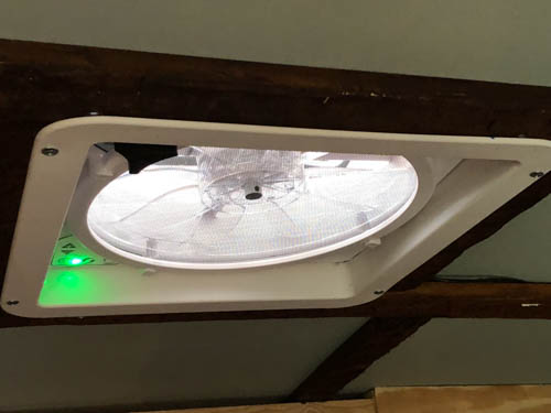

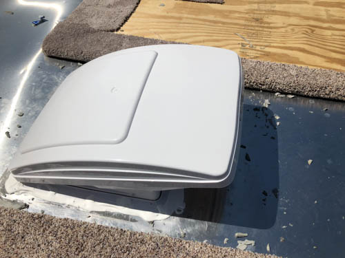

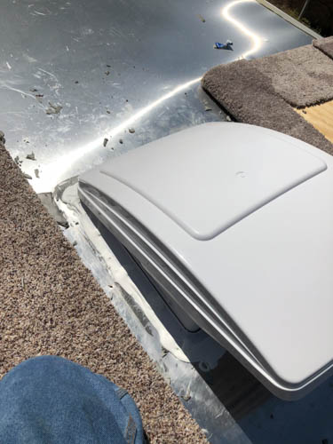

This weekend we installed a Maxx Air fan the one we can leave open in the rain and has a thermostat. :D It took a lot of time to get the roof vent putty off that the factory put on there. Other than taking longer than expected, the install was pretty strait forward. I was using a plastic putty knife for the most part and a metal one to pry up the actual vent. The butal tape really had it stuck on.
Is there an easier way to get that old stuff off of the roof?

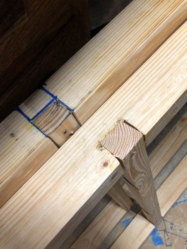

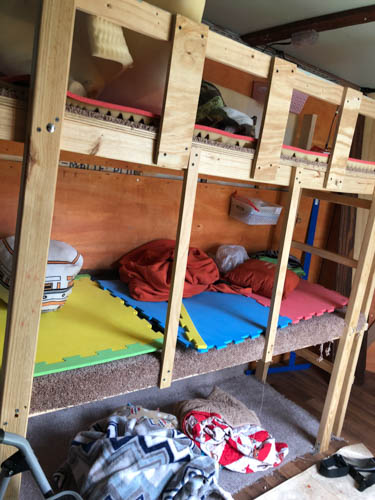

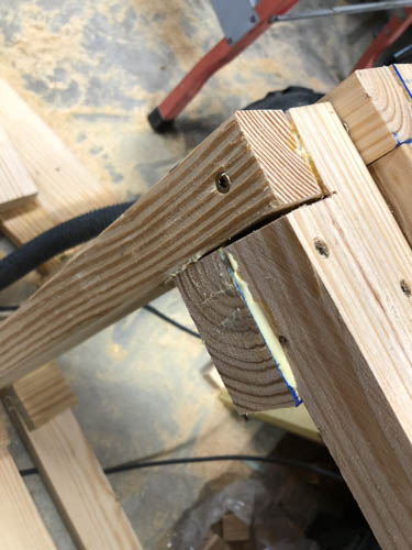

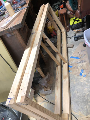

The folding bunkbeds didn't work out so well, so we built a triple bunk bed.
Here are a couple pictures of the Maxx Air vent/fan

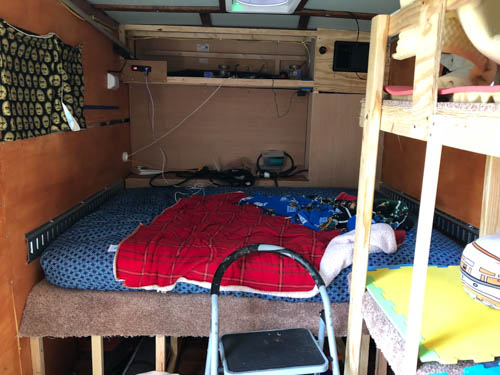

We installed a flat panel tv on a wall mount in the front V and ran some 110volt outlets. We are starting to get there.
