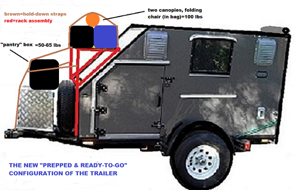

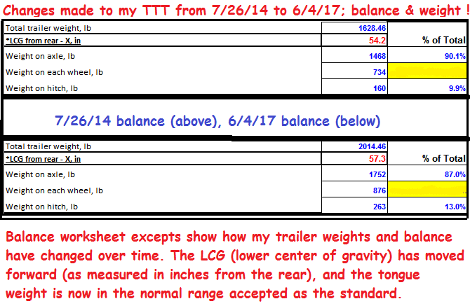

working on it wrote:I used a trailer balance worksheet, that was on this forum's design pages. I altered the format for more detailed item-by-item installation, accounting for small changes in position and/or weight. Since I started my TTT build with the heaviest items all behind the axle, I always relied on the worksheet to help me keep the rearward weight bias under control, until I could get everything I needed to put the trailer in balance, which I eventually did. I originally started camping with the nose too light (about 7-10% tongue weight), before I modified to bring it around to conventional norms (10-15% tongue weight). I'm still adding more to the front, since I have a heavy-duty truck to tow with, and a weight-distributing hitch (I always tow everything using one) for stability. My 4x8 TTT has crept over 2000 lbs now, with a tongue weight over 220 lbs, but it's been a long struggle to get there, and the worksheet kept me apprised of where I stood in that process.
  • I had been wondering about the accuracy of my post, quoted above, since I actually had not weighed the trailer in years, and not modified my worksheet in three years. I had noted the weight of items I had moved, changed placement of, or added, all along, but just kept a mental picture of what was happening, overall.
  • I located what I judged to be the most accurate worksheet, from 7-26-2014, and modified it to reflect the changes I made to my TTT since then. All my worksheets were based upon travelling loads, since that is most realistic, and useful, to judge the road-worthiness of a trailer. From the start of my build, I never stopped trying to balance the trailer, though my inclusion of everything I could possibly need on a trip, was packed (overpacked) inside the 4x8 trailer. The 1000 lb goal of my trailer build was doubled, but the strength of the trailer was of foremost concern, so I am still pleased with the way it turned out. No more additions to come. ???
    my 4x8 trailer's travel weight has changed significantly.png (26.76 KiB) Viewed 1238 times
    my guesstimations were pretty close to calculated figures
  • I figured the loads as I will pack up for my next trip, with the canopies and pantry strapped in place on rack and tonguebox. The foodstuffs in the trailer pantry, the water aboard, and the cube-in-cube rear "perishable storage" cooler will all be loaded at the last minute, to ensure freshness, since my garage stays over 100 degrees all summer long, and I don't want spoilage.
    PREPPED & READY.png (374.36 KiB) Viewed 1238 times
    the new travel configuration gives better balance to a once rear-heavy trailer
