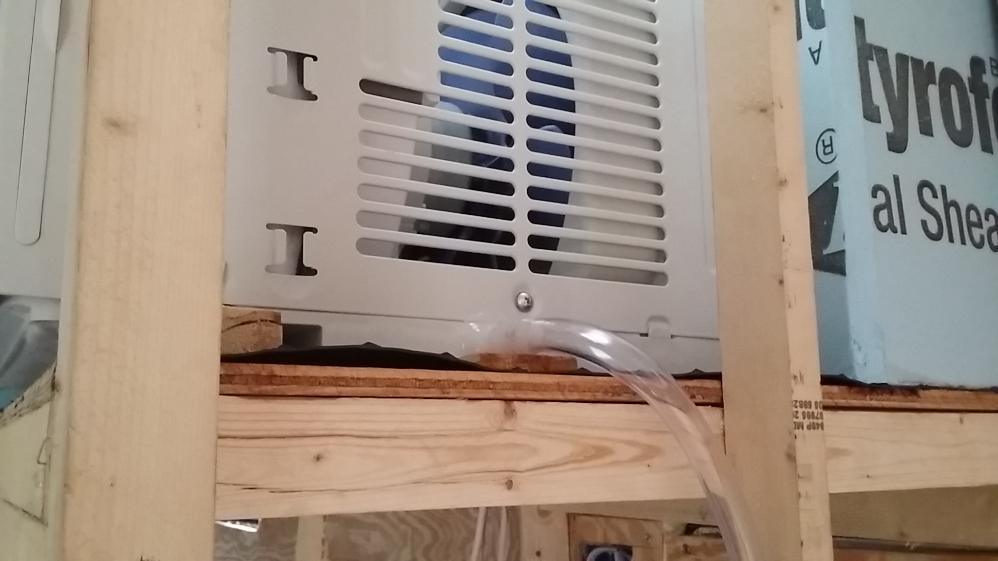

Don..do you have any pics showing how you dealt with water runoff..I think you mentioned a pan and I shroud go back as you may have a pic. What kind of pan did you use as A 50lb AC would crush most..Then next question would be once you have a hole and route your tubing to the exterior, how did you seal the tubing to the water collection pan..Did you use some kind of flange and silicone

I did not use a pan. I drilled a hole in the AC Pan right where the condensation channel was from the evaporator and put a 1/4 fitting to connect a hose. The Pic below shows about where I put it. I ran the hose down the frame and drilled a fole in the floor.
afterr I drilled the hole and put it in, I siliconed it in place as you can see. So far, it is working well.
