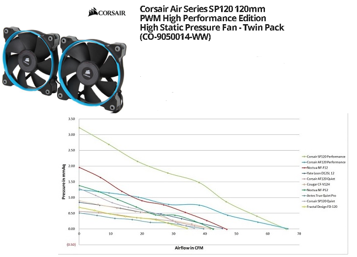

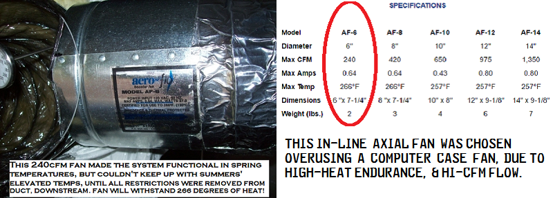

m.colley wrote:your two 5" holes on each side may not be large enough. Here's why I say this. On my 8000btu unit I have two side intake louvers and one intake louver on the top. The side intakes measure 5x11 inches which equals 55 sq inches, the top measures 4x11=44 sq inches. 55+55+44= 154 sq inches. A 5" round hole equals (radius x radius x3.14) 19.6 sq inches x 2= 39.25 sq inches. By only having the two 5" holes on each side I would be shorting the ac unit my top vent equivalent (44 sq in) as well as the 15.75 sq in difference from the side vents. This will affect the way your AC performs.
The AC manufacturers size the intake louvers to equal the rear exhaust opening size.
You might want to measure your louver openings and see how yours size up to compare to my example.
Martin
  • In my two previous posts in this thread, I suggested using either a case fan, or a duct fan to increase the airflow in through one of your 5" holes, and out the bottom exit 5" hole, just to ensure fresher air from the outside gets forcibly moved into and around the chassis. The rear exhaust exit doesn't need help, as long as hot air doesn't build up in the styrofoam enclosure; the extra fan is only suggested to prevent the build-up of hot air inside the enclosure (where two sets of louvers have no free ambient air source), and, being outside the chassis itself, the hot air isn't subject to the direct action of the exhaust fan, so another fan can help remove it.
  • I used a case fan to move ambient air thru the chassis,; it wasn't a powerful fan, just something to move the air quicker, The chassis enclosure is much larger than yours, because it is my whole galley (when the hatch is closed), and the great outdoors (when opened). The side wall vent is always open, and lets fresh air in, always. My exhaust is sent into a large plenum, turned 90 degrees, then ejected with the help of a 240 cfm fan inside the duct, thru an open 6" hole in the right side wall. No "exhaust" air contaminates the "fresh" air intake of the chassis.
    CORSAIR SP-120 cfm.png (199.26 KiB) Viewed 2273 times
    case fan with similar specs was used to move ambient intake air
    Aero-flo 6 inch-diameter duct fan for exhaust work.png (303.45 KiB) Viewed 2273 times
    exhaust ducting was aided by this 6" fan
  • I didn't use a case fan near the actual exhaust, fearing that the heat would damage it, and that the cfm wasn't high enough to quickly eject the heated air. I preferred the in-line axial duct fan, for those reasons. However, it is noisy, and becomes quiet enough to use, only because it is completely wrapped inside the fiberglass and foil ducting.
