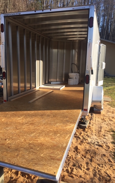

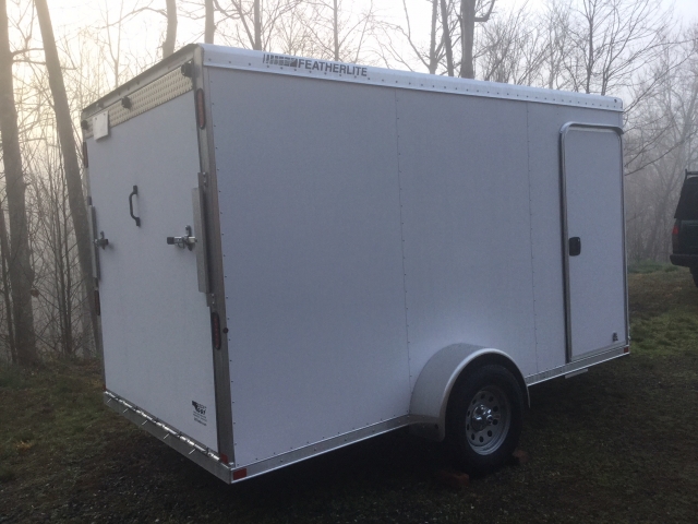

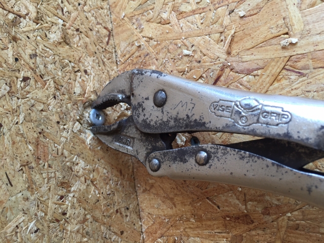

Finally got home with my Featherlite trailer from the dealer on Monday after over 4 months of waiting from the date of order.
I got it situated and leveled where I’m going to be transitioning it into a cool camper.

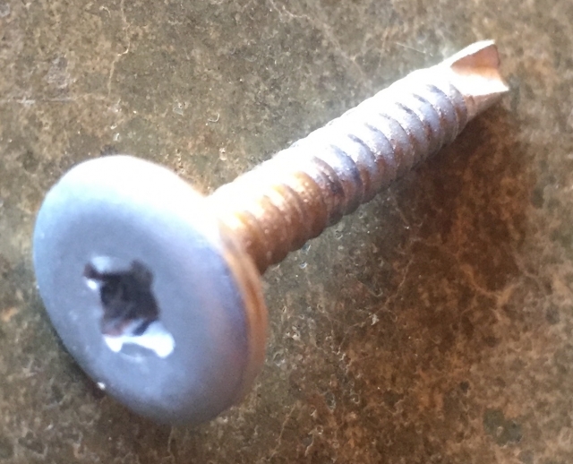

First thing was getting all the interior OSB panels off of the walls so I can insulate. Several of the screwheads were rounded out so I had to chip away some of the wood so I could get a bite on the screw head and turn it with vice grips to get it out.

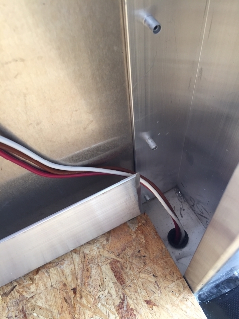

I was a little disappointed at the quality of the wiring. Some of the wires were rubbing up against sharp aluminum edges and I’m sure would have cut through and given me problems down the road, other places just had a little bit of putty between the wire and the sharp edges and I’m sure they would’ve cut through overtime also. I’ll put some protective plastic conduit in those places.
Also had a little bit of rain and I noticed about a dozen rivets all around the top edge of the walls were leaking water, I’ll have to go around and seal all those with some good sealer, any recommendations?

And the trailer looks great too!
Pretty much just like mine but new. :thumbsup:

That is a nice rig. Sorry about the delays and such but all good things in time. I'm not sure why the manufactures don't put the effort into a proper wiring harness and installation for these trailers. I have yet to see a new trailer that didn't have issues waiting to happen. It is scary to think about what the wiring looks like in a pre-manufactured camper where everything is installed and all those connections and runs are hidden. This is definitely the time to do the job right.

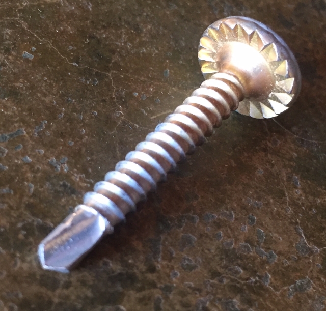

Were those screws the double square #2 Robertson type? They look like Phillips and kinda work with Phillips drivers but the square bit will make life a lot easier.

Not sure what the name of the screws used by the factory are. They have a combo philips/square head.

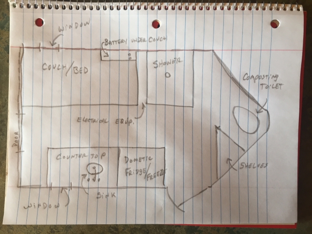

Here is a rough draft of my floor plan. I’m also considering building an insulated 2 or 3 inch wall with a door and window next to the closed ramp, so I don’t have to deal with trying to insulate the ramp.

Re: 6X12 Featherlite Cargo Conversion
Postby EZDog » Fri Mar 23, 2018 12:00 pm
In my minds eye the Ramp is referred to as "The Porch" in which case the extra wall is what I am considering as well.
This would also be a great way to use a $100 AC unit in that wall rather than an expensive and heavy unit in the roof!
