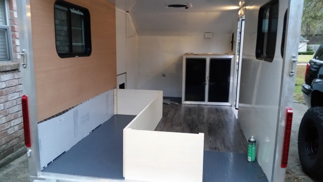

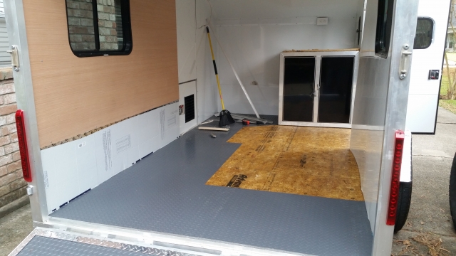

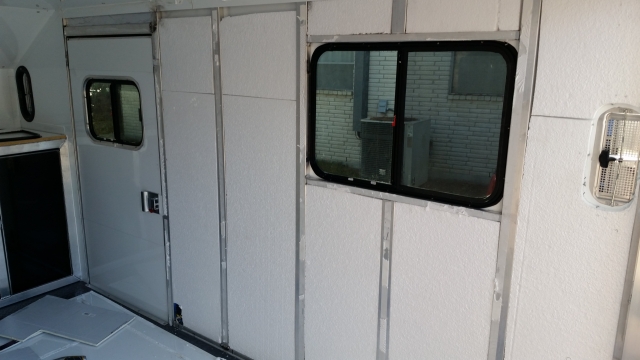

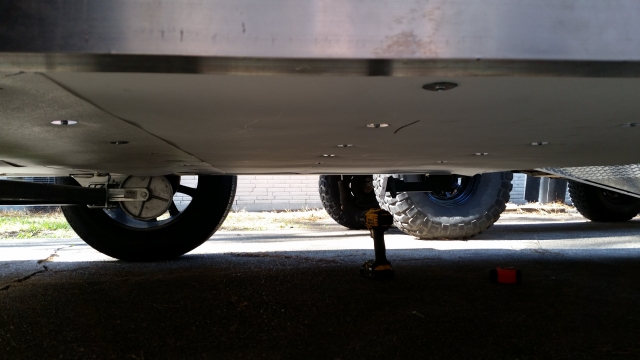

Postby onlyridepark » Fri Jan 05, 2018 1:10 pm
I've got the bottom side complete.
Now I've decided to go ahead and tear out the walls and insulate them a bit better. adding 1/2" foam then wood strips with another 1/2" in between. I'll be off for the next week and hope to make some decent progress with this thing.
This is what was under the walls.

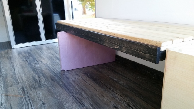

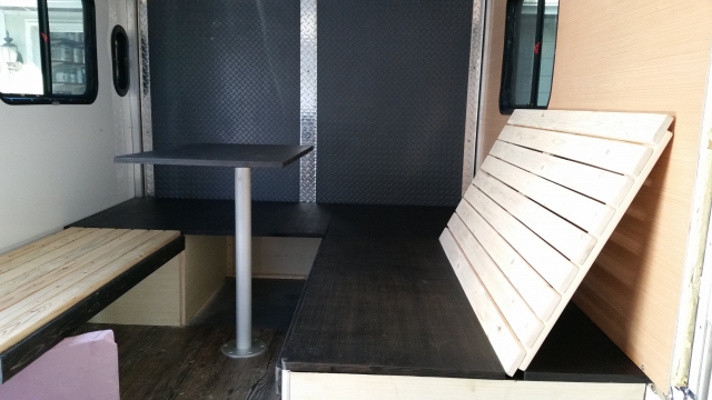

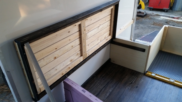

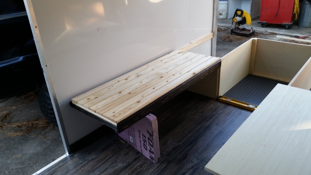

Postby onlyridepark » Mon Jan 15, 2018 9:22 am
Happy with my progress last week. Still need to build a backrest for the bench that will double as a filler on the middle section for the bed. I am really enjoying this build, it is exciting to see ideas come to life.
This bench needs a folding leg but I'm still debating what to do there. So for now it just gets a block of foam.

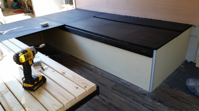

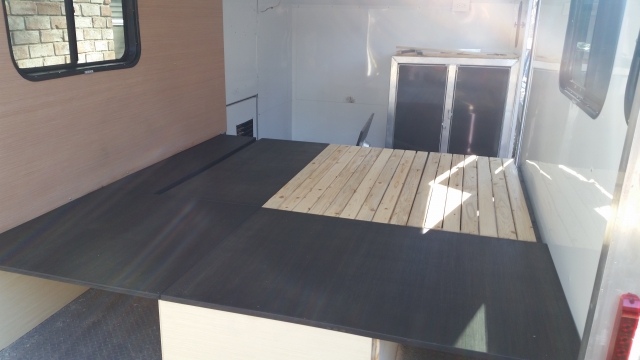

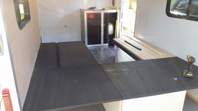

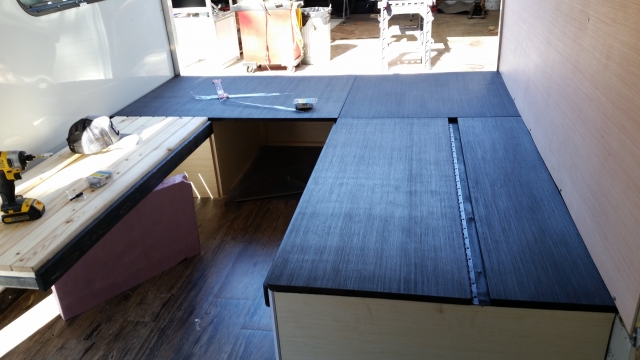

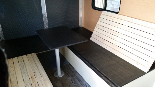

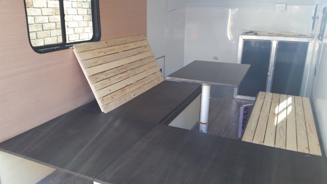

Postby onlyridepark » Wed Jan 17, 2018 3:10 pm
small update. Finished the table and backrest that doubles as the filler piece for the bed. Trying to figure out what to do for cushions, priced having some made but way more than I'd like to spend. Now waiting on my AC and Refrigerator to show up so I can build the cabinet for those. Also got most of my electrical ordered.
