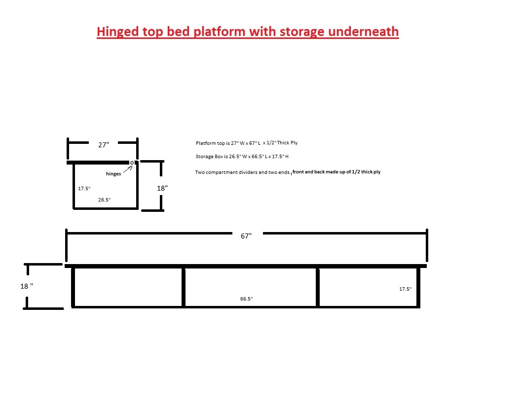

Attached is my solution for a bed platform and storage. I decided to keep this a permanent thing. There is enough room on the side, 17 inches, for me to get up and get out of the trailer through the teardrop door I will install in a rear inside wall. I will also have a 15"w x 30" L drop down table I can use to eat on, or place my small 12 Volt TV, propane heater, or small 12 Volt fan. And I have enough room that I could add a second if the need arises.
With these two things, I may still be able to put some small cupboards in the front at the ceiling for additional storage.
To test all these building plans, I will have to plot out in pencil everything lightly on the existing plywood inside the trailer. Hopefully I will be able to move around without trouble with all of it in place.

I've done designing my basic setup for this trailer. I will have a platform that is 27 inches wide, 18 inches tall, and 63 inches long. The top will be made up of three fold up lids so I can access the three compartments underneath. One of those compartments will be for my battery and electrical The other two will be for general storage. This bed, while looking from the rear of the trailer will be on the right side. I have to put it on that side, as I have to install the teardrop doorway (24x36) on the left side. This ensures I have room to get in and out of the trailer without having to crawl over the bed platform. I'll probably have to round the corner of the platform near the door in order to make it easier for me to move in and out, but I don't think that will matter, as my head will be to the rear of the trailer when sleeping. That allows me to swing my legs over the side and turn to get out.
This also allows me to put cupboards at the front of the trailer, which will be 12 inches high, and 15 inches deep located just down from the ceiling. My feet will be under those cupboards.
On the other wall I will install two small fold up table tops. One can be used for munching a meal on, and the other can have a fan or whatever else on top. Unfortunately they have to be folded down at night in order for me to be able to move in and out of the trailer. This trailer is just tiny, so there isn't a lot I can do with it like add a fridge, A/C wash basin, shower and toilet. Maybe someday I will have a vehicle that can tow a 7x16 cargo trailer that I can convert to contain those. But for now, I will have to rough it. But it isn't quite like living in a soft walled tent, which just gives me the heebie jeebies.
