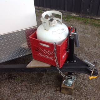

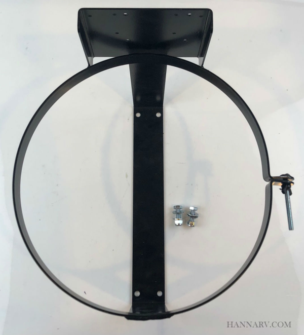

Postby Iconfabul8 » Mon May 21, 2018 12:31 am
You were talking about propane tank mounts on Haders page and I didnt want to hijack his page, but thought you might get some ideas from my confabulation.
I did a search on "propane tank mounts" and there are not a lot of mounting options out there for hanging a 20 pounder. But I did find these two, I especially liked this one: Haha
With a heavier backing plate running the whole length, I think this one would attach to your frame rail and possibly work.
https://www.hannarv.com/P/35420/Propane ... rRegulator
Your pic and original comment so others know what we are talking about and to chime in.
Joel.brian wrote:I still have to fabricate a mount for a propane tank on my trailer tongue. There’s hardly any room though
On yours, I invision 2 bars attached to the bottom of both frame rails extending out the drivers side and forming a base for a mount.
My tank mount:
http://tnttt.com/viewtopic.php?f=42&t=6 ... 0#p1210654

Postby onehoser » Mon May 21, 2018 6:44 am
i found the milk crate works great for 20lb tanks plus it holds a 10 liter gas can or propane bottles, wood blocking, scissor jack etc.
