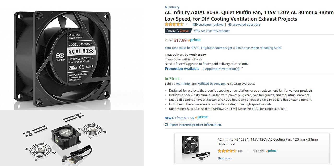

Postby phoenixbound » Mon May 21, 2018 7:15 am
Checked on Amazon, if needed these should be pretty easy to add:
https://www.amazon.com/AC-Infinity-Cool ... muffin+fan
Muffin fan.JPG (146.07 KiB) Viewed 3280 times

I used to have a PetCool (now ClimateRight) HVAC in my teardrop. The unit was located in he tongue box with the supply routed through the front wall of the teardrop. The return was located in the galley bulkhead and returned underneath the teardrop to the unit. Initially, the coils would freeze due to the additional "resistance" from the long run of the return air duct. I added a blower in the galley to help "push" the return air back to the unit. This worked fine until the PetCool unit "died".
If you add additional "fans" to the Whynter, be sure to spec/size any fans so that you don't create a worse situation than no fans at all. The specs for the unit are rather vague but the duct sizes are either 5.0" of 5.9". A maximum airflow is given as 212 CFM but it doesn't specify whether this is for the evaporator loop (cool side) or the condenser loop (hot side). In general, I would suggest that our auxiliary fan match or exceed the CFM of the unit.
In my teardrop, I initially tried bilge (axial) fan and "muffin" fans. The bilge fan worked but sounded like a screaming banshee. The computer type muffin fan did not work. Often the CFM ratings for these fans are stated for "free air" conditions. When they encounter any static pressure, the airflow drops dramatically. The muffin fan could not push the air through the return air duct. I ended up using much more substantial 12-volt "squirrel cage" blower fan that maintained the CFM when under static pressure.

So, there is no way to know how much is enough without more data and controlled conditions. As a general rule I doubt you could have too much air across the condenser, so more cfm = better. What you do not want to mess with is the evaporator air flow. Let the machine do what It does, just get rid of the heat more effectively. I would start with something cheap and easy and readily available, like a scrap computer fan to push air. If that helps, try it in the pull instead and note the difference, if any. If needed try 2 fans, push and pull. If that does not show significant improvement, you are probably at the limit of the work that BTU's can do.
So to recap, shortest possible length of hose, as straight as possible, if one fan helps but not enough try 2. Those computer fans are everywhere so should be almost free. The booster fan needs to move more air than you are currently moving so as not to further restrict air flow.
