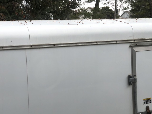

I think you might be mistaken. All the rounded roofs Iv seen lately have a seam above the radius like this interstate and the one behind it. But it might just depend on the factory and how they want to skin it..
http://www.needatrailer.com/interstate/ ... 675-06.JPG
This is a H&H rounded one piece, and has water shedding lap seams. None of them have a true one piece metal roof. I just feel this is the best design.

rebar, Howdy;
That H&H is a Galvalum sectional roof, with seams every 4' and at the front, rear and along
each side of each section. Yea, the Interstate has the radius on either side, however the
longitudinal section is one piece. One seam at the front, another seam along the sides and a
seam at the rear. I dunno, :thinking: , shooters choice, flip a coin ... both work well or they
wouldn't keep on makein'em. Here's a nifty link if your curious;
http://www.cargotrailerguide.com/trailer-construction/
