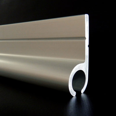

rebar wrote:Yup. That's the shape.. I just wish I could find it in aluminum with the beaded strip that fits inside..
https://www.youtube.com/watch?v=jIHpckH1RDg
I think this is what you're looking for:https://www.kedersolutions.com/what-is-keder/.
BINGO!
Thanks for finding that aggie79. I was thinking I might have to use snaps..

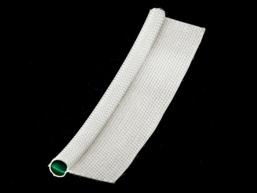

I attached flexible Keder rail to my TD and made an awning. The plastic rail can be bent using a heat gun. All of the Keder products are available from Sailrite.
https://www.sailrite.com/Flex-A-Rail-White-45

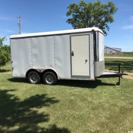

Thanks rkanz.. What made you decide to use the plastic rail in your link instead of the aluminum rail in the picture?
I'm hoping I can form the rail over the last inch of round roof of this trailer and down the walls to make a sealed bug proof room. I figured going over the roof vs trying to bend the rail the "long way" to attach it to the back wall would be easier, but I'm not sure how tight a radius the awning rope can fit through.. The trailer roof looks like it has maybe a 6" radius transitioning from the walls to the roof and then back down again.

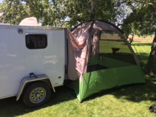

the napier backroadz suv tent arrived in the mail today, it sets up pretty easy and i found that the umbilical/tube just fits perfectly around the back of my ctc. if my 5x8 was even an inch bigger in any direction it would not have fit at all. So far i like it and will post up pics shortly. i do notice that rain may build up over the umbilical as i don't have a rear hatch door to hold it up.

Postby rkanz » Fri Jun 29, 2018 9:48 pm
The plastic rail attached in the best way to my trailer. The plastic is attached with screws through the center and has a narrower width than the aluminum. Plus I was able to bend it slightly to match the curves of the roof. You just need to pick the best rail for your application. Sailrite has a video that shows how to bend the plastic rail.Image
