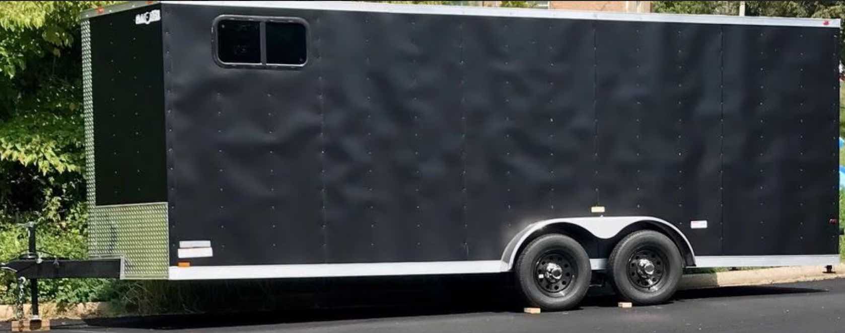

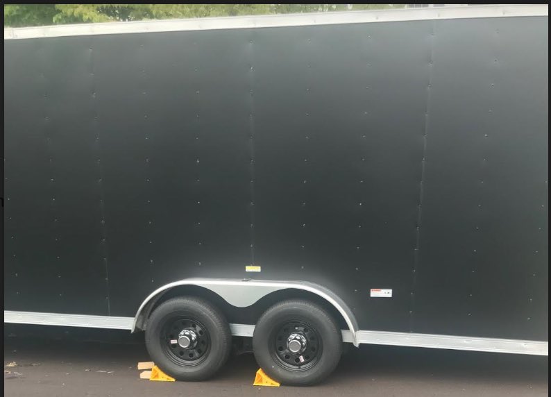

Trailer delivery pics.
Trailer Pic 3.jpg (44.47 KiB) Viewed 1293 times
Trailer Pic 2.jpg (97.83 KiB) Viewed 1293 times
Trailer photo 1.jpg (70.94 KiB) Viewed 1293 times
