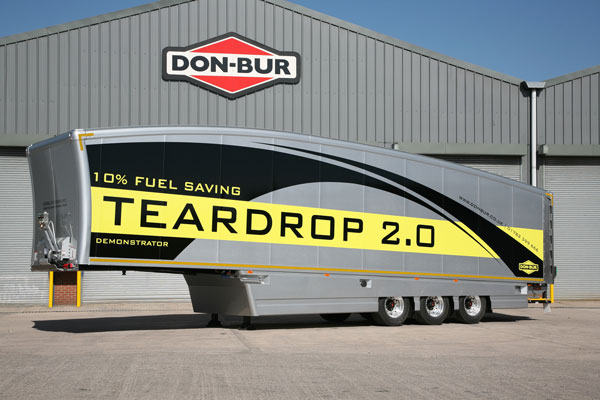

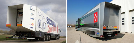

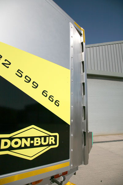

I guess one could arch the top and add these flow devices to decrease the rear "suction" drag:
Re: For all the "Flat Nosers"
Postby McDave » Wed Sep 19, 2018 7:01 pm
Yes, yes! This is exactly the kind of stuff we can learn from and copy, imitate, steal etc. I'd take 10% to start with.
Thanks! You wouldn't have a link by chance?
McDave
PS. That is one biga** teardrop!
McDave
Posts: 2288
Images: 412
Location: Tiny Town, Montana
Postby aggie79 » Thu Sep 20, 2018 1:29 pm
Those were pictures from their website that I "captured" several years ago. Here is a current link: http://www.donbur.co.uk/gb-en/products/aerodynamic-teardrop-trailer.php.

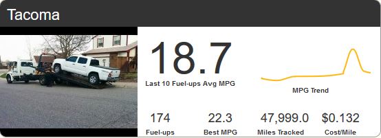

I have a Tacoma and I've tracked the mileage for almost 50K, basically from when it was brand new. My best mileage was 22mpg and my average according to Fuelly is this:
My TTT is fairly short, and narrow compared to a a lot cargo trailers and my mileage goes *DOWN* to 14 mpg when I tow, not exceeding 65mph.
I need to know what kind of magic trailer you have that increases mileage as I'm going to buy one. :shock: :lol:

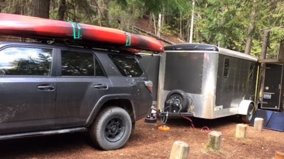

robctc wrote:So I don't have a ton of experience towing and haven't started my CTC build yet, but I am the kind of person that researches for literal days, and as a result bought a flat nose trailer after reading many forum posts and other internet commentary from old curmudgeons with decades of road experience.
So heres what I found, summarized (hopefully) with simple explanations.
- Those air tabs DO make a difference, but the worth is more in preventing trailer sway and feeling more stable by breaking the suction at the back. Don't expect more than 1 MPG difference, do expect to stop feeling the sway when a semi passes.
- V-noses don't actually help aerodynamics, though many swear they do. If your vehicle was pushing the V-nose, it would help, but the air is already broken by the front of your vehicle. What happens instead is that there's more surface area on a V-nose for wind to hit both those sides, and add to sway. However, this is a difference you could see in a wind tunnel. The average person could pull both and probably not notice. If there is a MPG difference between the two it couldn't be more than 1-1.5 MPG.
- Those nose cones DO help, but you're probably better off with a DIY solution. 1-2 MPG difference but commercially they're around $700, so the math doesn't work out well.
Other things to consider doing:
- Insulate the underside of your trailer to the bottom of the supports. Air moves down there too, so the less pockets for air the better.
- Get the top of your vehicle level with the trailer. Personally, I'm going to add a rooftop carrier to my SUV because right now the trailer sits a good foot higher, and thats a big sail.
- Distribute the weight inside evenly. Thats just trailer 101.
So if you do all the things I wouldn't expect more than a 3-4 MPG increase, and that will vary per driver and vehicle. Doing all those WILL do a lot for trailer sway and safety, which arguable is worth way more than an extra stop at the pump.
Hope this helps, but take it all with a grain of salt because its just research.
[/quote]
Pretty much sums it up.
The nose cone needs to be a sphere like the commercially produced. Build a mold, make one out of fibergrass, attach to trailer.
Put the angle flaps on the rear of the trailer like tractor trailers use.
Soften the wheel wells and include covers over the wheels to enhance air flow.
I gained 1 mpg by putting kayaks on roof of tv changing the air flow.
Go to the ecomodder forum. Lots of discussions about trailer design, air coefficients, etc. https://ecomodder.com/forum
It was interesting to learn that the flat back of a cargo trailer is more efficient than the teardrop trailer. But can still be improved.

What about the trailing edge gizmo you sometimes see on semi trailers? If built right, could serve as a awning roof when the ramp is leveled to be a deck..

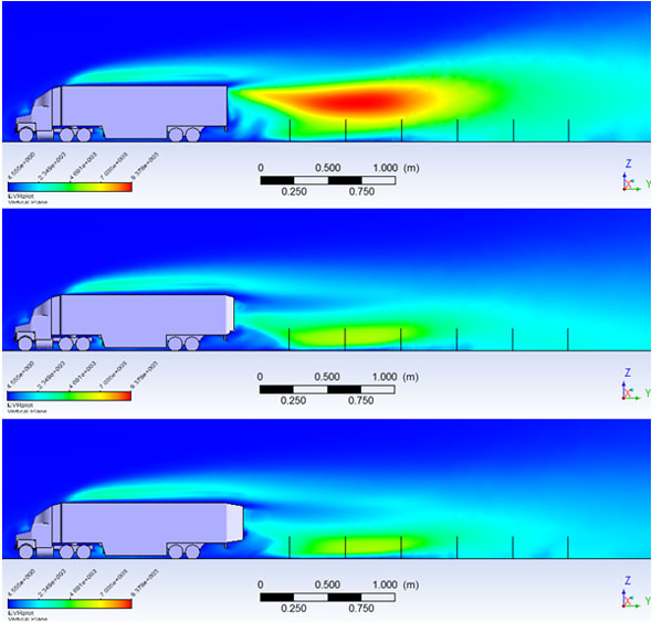

So, it would seem that the "gap" between the TV and Trailer is responsible for about 25% of the drag of the combo. No surprise really. with both high and low pressure, trailing and leading faces and different body width/height. This being the case, possibly this is the area that would yield the most mileage gain. Also no surprise, this would be the most complicated because of the articulation and vehicle differences. Here is an ingenious solution for big rigs that could be possibly scaled to our trailers.
http://www.donbur.co.uk/gb-en/docs/1503 ... ochure.pdf
Put on your thinking caps and have some cold barley thinking fluid and lets see how do-able this could be. For pickups lets assume there is a topper, or a van as the tow vehicle.
