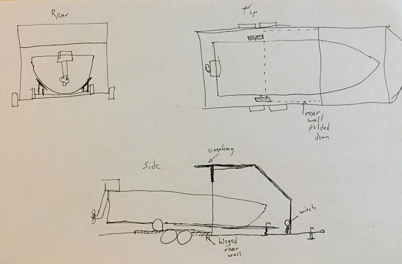

Postby Elkins45 » Fri Oct 12, 2018 8:08 pm
Here’s plan B if I don’t love the homemade truck camper.

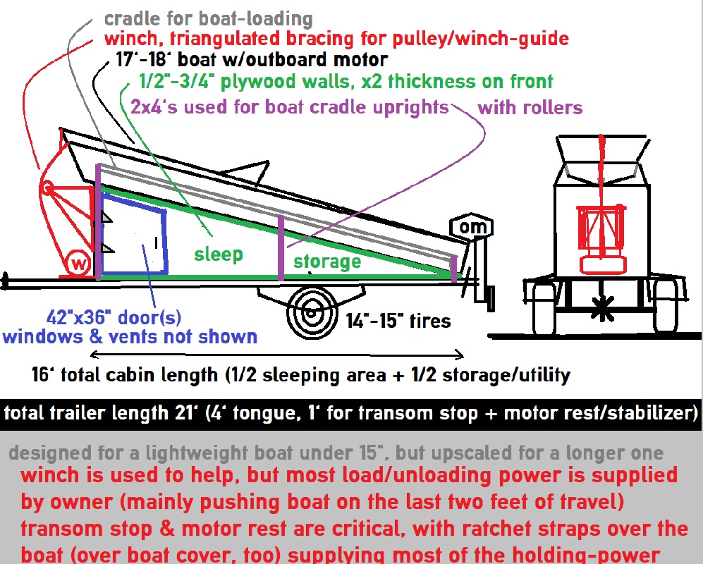

  • I know this isn't what you're probably looking for, since you posted this in "cargo trailers", but here's a modified version of an older plan I made when contemplating variants of my 4x8 plywood TTT. Not that I intended to chop-up my present squareback, but as a "what-if", in case I needed to start over after catastrophic failure.
  • My trailer is 12' long overall, and if I were to get a small boat for fishing, I probably wouldn't get anything over 14' long (to store inside the short garage bay), but I altered it for a longer length boat, to fit your requirements. My trailer's axle height is lower than in the drawings, but I raised it in case a mounted outboard motor is involved. In my imagined boat carrier/camper, the boat would've been a motor-less Jon boat, or similar.
