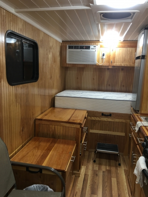

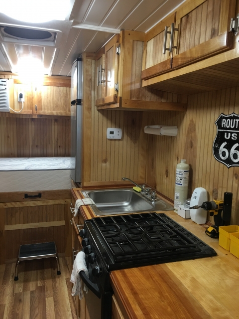

Postby McDave » Sun Feb 24, 2019 5:49 am
Chasein70 wrote:I've been building my cargo trailer/camper since May of 2017. I'm into it for about $22,000 so far. It's pretty much done but like you say, mine also is never ending. I keep adding and changing stuff. I'm a wood worker so I had a lot of fun.
Wow!
That looks like one fine trailer. I'd like to see more.

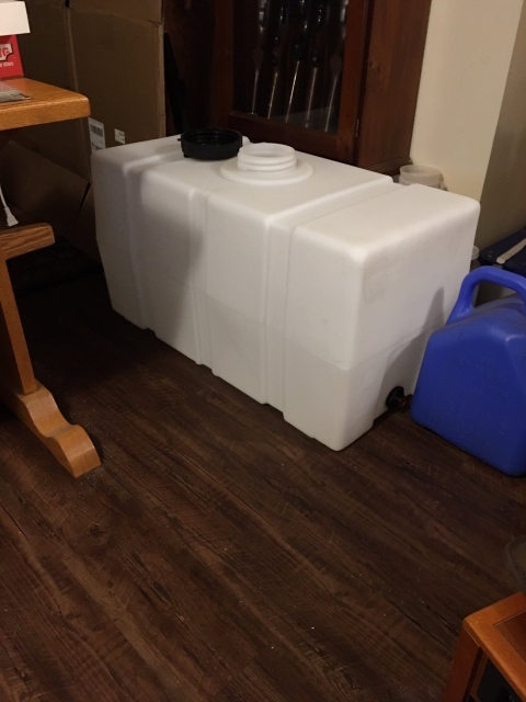

Postby Chasein70 » Sun Feb 24, 2019 4:45 pm

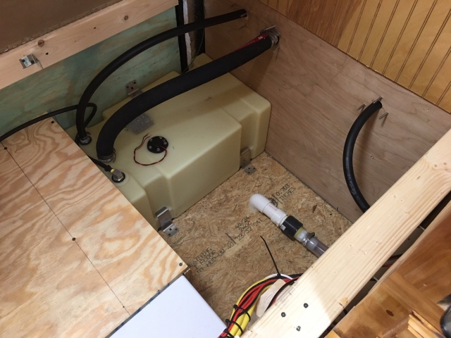

50 gallon water tank going in the back of my pickup. Have 22 gallon in the trailer

22 gallon marine gas tank. I have a 3400 watt Champion generator on a tray slide out under bed. I modified it with a pulse pump to draw from this tank.

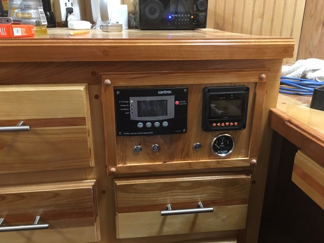

Postby Chasein70 » Sun Feb 24, 2019 4:51 pm

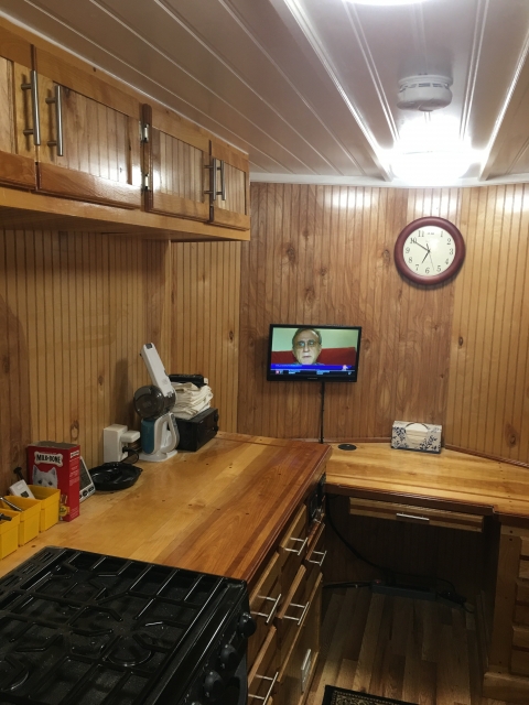

Xantrex 3000 watt inverter control panel. 360 watt solar panel. Fuel gauge to under bed generator fuel tank. Remote start and stop generator switches.
All wood is yellow birch with some cherry inlay
