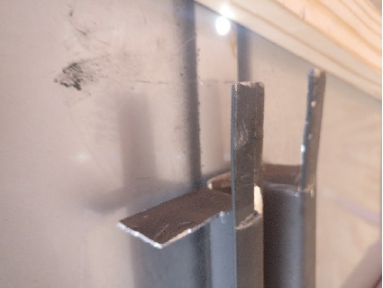

The stud is cut and headers in finally! Tomorrow if it stays dry we will finish the cabinet, cut the skin and install.
I found an oscillating saw and dremel worked great. Lots of control and light weight tools. The Dremel brand bi-metallic blades for hardened ferrous metal cut the stud like butter. The Dremel let me make needed cut inside the web where the oscillating blade was too wide. Used the basic round cutt off disks.

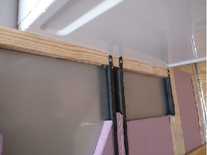

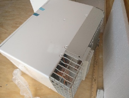

All the install pictures
AC unit
AC unit.jpg (44.43 KiB) Viewed 4620 times
Cut stud
Cut stud.jpg (33.75 KiB) Viewed 4622 times
Installed footer
installed footer.jpg (34.34 KiB) Viewed 4620 times
At this point the rain started coming down heavy and I had to stop for the weekend. My oscillating tool with the Dremel brand bi-metallic hardened cutting blades went thru the stud super easy. I had a scrap piece of 1/8" ply behind the stud to protect the skin.

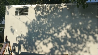

The Thru-Wall AC sleeve and the power tower is installed. The 30A shore power outlet is installed but not wired up. Ran out of time to lift the AC unit in and secure it. I also left the drain fitting at our house. Working at Grandma's house is awesome for the kids but takes extra planning since they are 4hrs away...

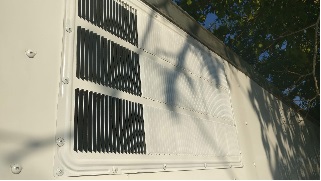

AC Grate Installed.jpg (25.32 KiB) Viewed 4787 times
AC Grate Close Up.jpg (25.22 KiB) Viewed 4787 times
Lots of screws and butyl tape. I spray painted grate and screws with Rustoleum Bright White Enamel. The aluminum color was blah.

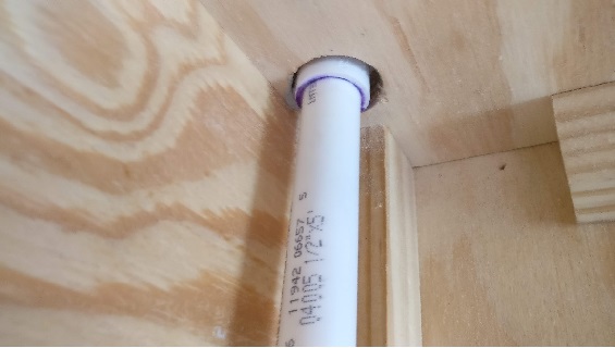

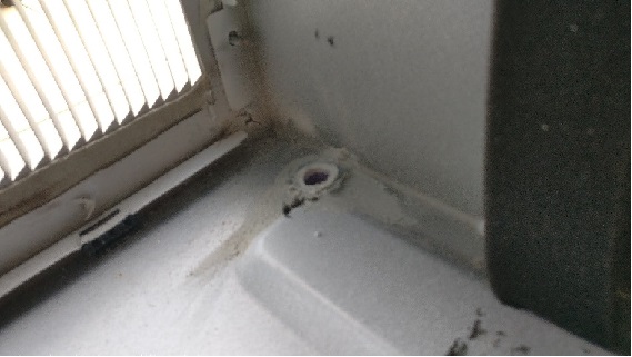

The AC install is mostly done. Fiddly bits, bleh. The AC pan drain is made from 1/2" CPVC pipe with a female slip x male threaded fitting going thru the pan. The topside is locked in place by a 1/2" EMT conduit nut with excess threads cut off after nut locked down. Everything sealed with caulked. The bottom side has another fitting that I can attach a screen too.

Postby Margali » Tue Sep 17, 2019 5:26 pm
Pictures of the drain line installation. I believe it was 1.25" bit for wood and 5/8" for pan but DOUBLE CHECK.

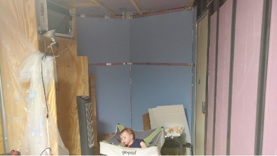

Finally getting the insulation in on the passenger side. Having the AC unit running made this so much more pleasant. AC unit kept trailer nice 70 degrees even with ramp door cracked open to allow extension cord thru. My assistant fell asleep on the job. :lol:

Just curious about your AC grate. Are you going to have a cover over that? My concern would be wind driven rain and insects. Also cold air coming in when it's colder outside.
